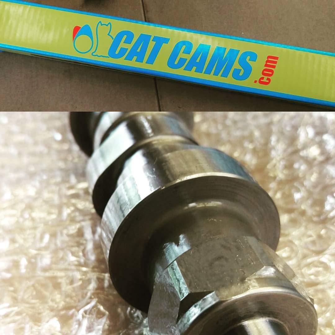

They do exist!
Cat cams custom grind for GD3. Available direct from JK Motorsports in CT. Ask for Greg.
JK Motorsports, Inc.
1-203-255-9120

With any high perf cam ,, its not just a drop in deal, you may need new valves/springs/retainers/head cutting for valve spring length etc..
Any lift over about .425, PLAN on HP valve springs and retainers.. Or fix it later.

They have several versions some that retain the stock Springs, etc...
As for mine all of that has been done as well.
