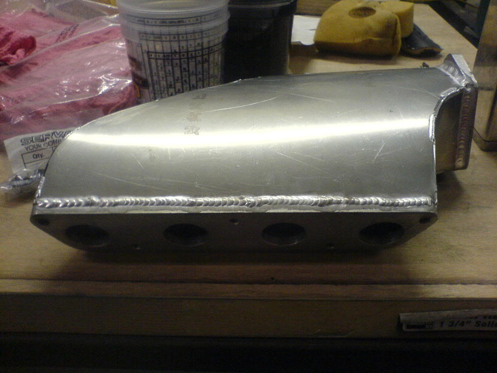

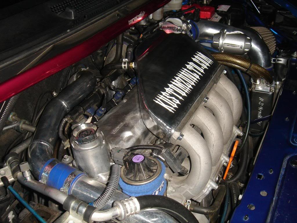

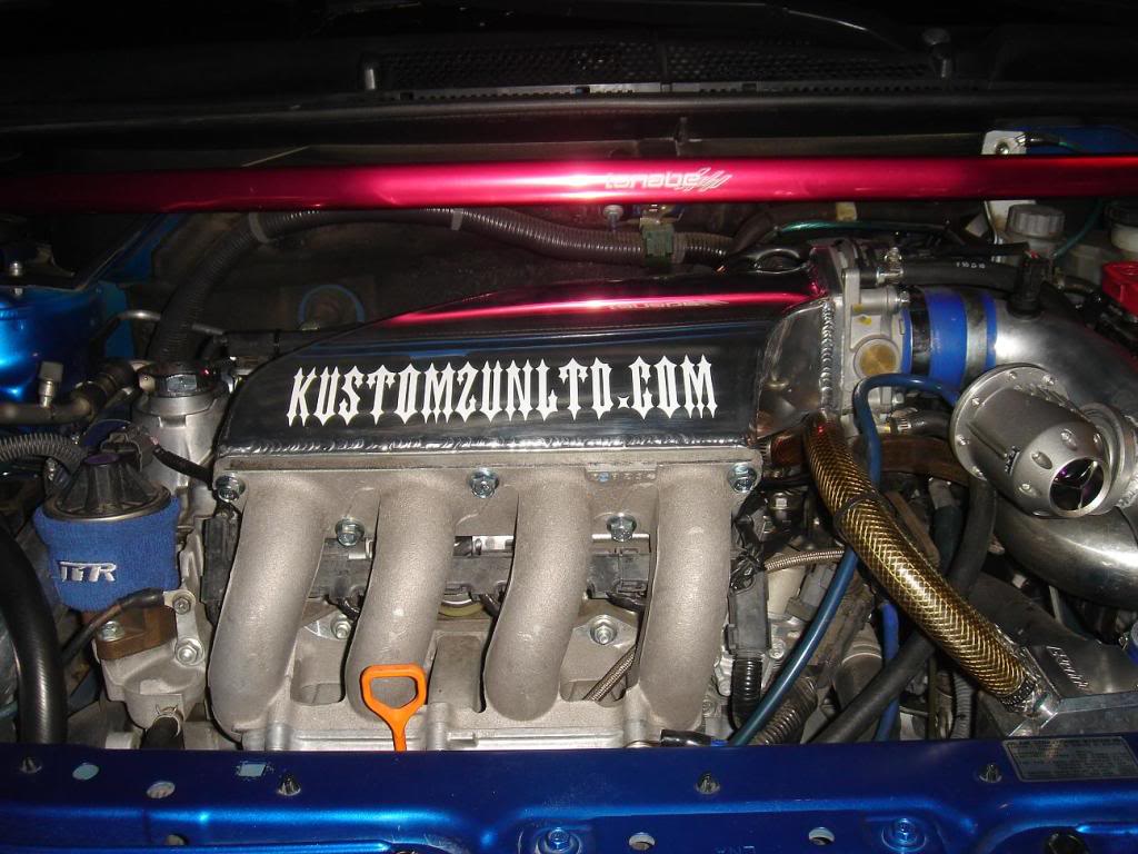

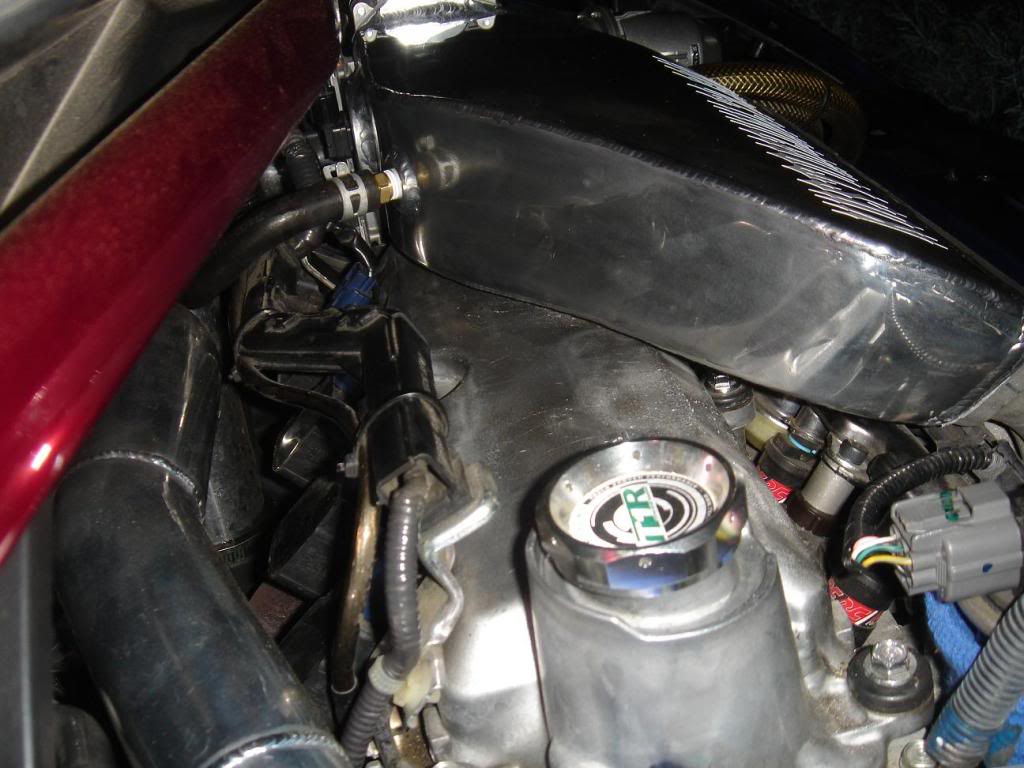

I'll let the pictures speak for themselves.
Raw

Finished

It's made of aluminum and very thick I say. Hard as heck to bend as I was watching the guy make it. PM me if you want some prices.

This design is for more HP, but you lose torque. The longer the runners, the more torque but not as much hp like weapon R. This is just a lot of air so high end power will be seen, just not on the low end.
I like it so far, I do feel the torque loss, but when I'm in the power range, it goes! Still running at 12.4-12.5 afr so I'm good on WOT.

I like the polished look. I will be powder coating my engine cover blue because you can actually see it now.
Reason for not doing the stock runners is because of the EGR issues. I will polish my runners up inside and out.
