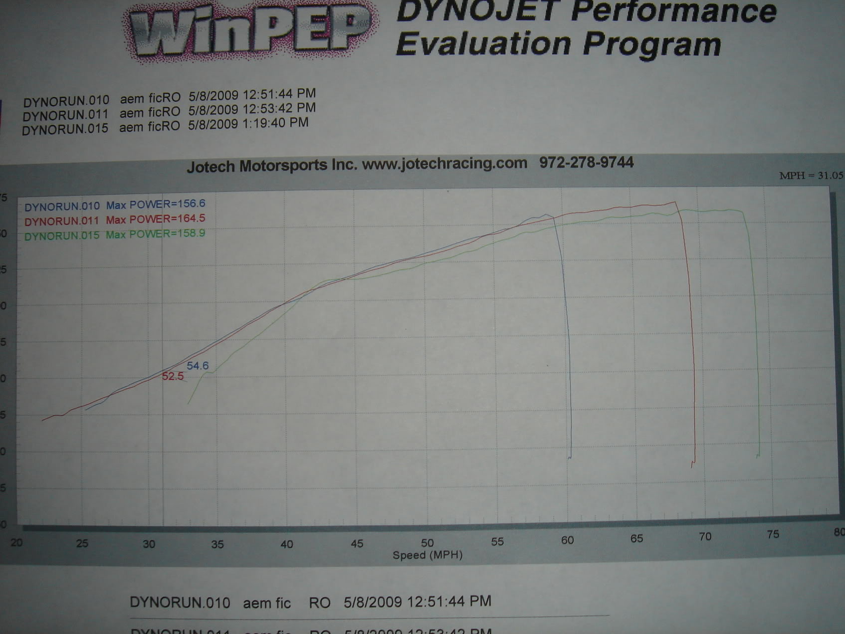

Hey, I just got back from trying to retune the Greddy emu(with explosivpotatos map) and what a pain! Stock ecu is constantly trying to fight the afr targets I want. I still have codes and its mainly the car running rich and also IAT sensor is high. I am really leaning into getting the AEM F/IC. One question, will it fix the CEL? My inspection is due this month and I need this done right.
I hit 160whp on the dyno at 8psi and could not go higher boost or it would be too lean. I had values at 100 and could not get more fuel into the engine.

Didn't hear any knocking. Like I said, it was on the dyno for a while. The car has been on for about 3-4 hours. All I had to cool down the car when it was on the dyno was a fan. Yes 160hp at 8psi is low and I had 157whp at 6psi on another dyno with the ajr map. Also depends on the dyno machine. SAE dynojet are usually about 10hp lower than STD dynojet machines(its a setting). I was on SAE. My power curve was pretty smooth all the way up and did not peak and drop at the end. I was using the map that was set for 12psi. Although it couldnt give me enough fuel for my WOT. 8psi was running at around 11.9-12.5 and any more psi...too lean even at 9psi. So getting this AEM F/IC should relieve all my headaches.
The green one was 3rd gear til redline. The bump near the beginning was my clutch slipping.(getting new one installed this week) I did not get a torque rating. I will be back at the dynos again.

you should use 4th gear for dynos
4th ratio is more accurate than 3rd ratio on the Fit

Originally Posted by CamFit
those runs were with aem fic?
Ignore the aemfic on the dyno sheets. It was run with Greddy emu. My tuner just didnt change the last persons file name so that was leftover.

You wouldn't hear knock, the stock knock sensor will hear it before you do and the ecu will pull timing. You'll just have artificially low numbers. Hard to say really what's going on.
Get the FIC installed and do another run! I wanna see what you make at 8lbs. What do you make @6, have you dynoed?
