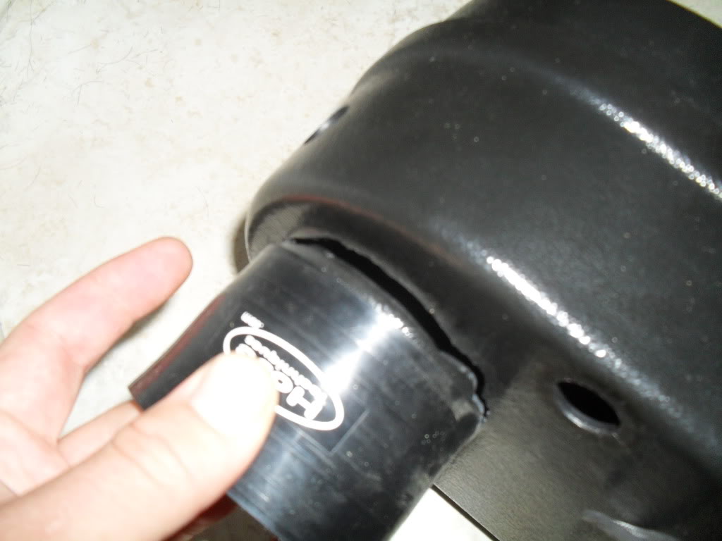

Soo the other day I noticed my Super sucka broke by the outlet that goes to the throttle body. Has anyone else had this problem? I traded it with some1 on the forums soo I dont think Im eligible for a warrenty exchange soo is there anyway I could fix it myself? Send some input this direction!

most likely is abs plastic. hard to say need a pic.

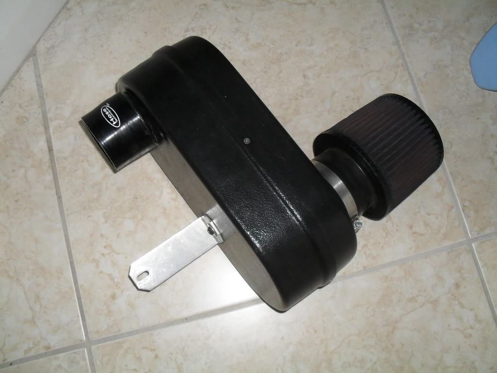

Heres a pic of the crack:

You might be able to try the plastic cement used for model cars and stuff. The regular stuff (not the non-toxic type) may be strong enough. Word of warning though, it can soften the plastic a little when drying and could warp just a little bit.
If that didn't hold, I'd just bend a small L-bracket from strap aluminum and rivet it on to hold the tube tight, sealing with Hondabond or something similar.
I'm not sure what else really works for plastic.
