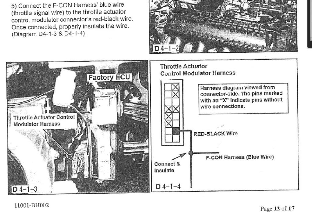

I have the HKS turbo kit back on but can't remember what wire is used for the TPS sensor. I do remember that is does NOT go directly to the ECU but on one of the connectors on the side....anyone know what color the wire is?

since you saying you are using the hks turbo kit, i'm gonna assume you are also using the f-con. If that is the case your blue wire from the f-con harness goes to the red/black wire.

yep red and black!
