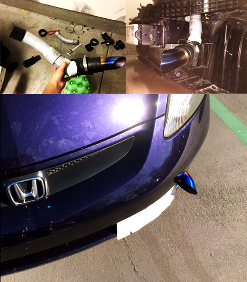

Made a Cold Air Snorkel out of spare parts that extends out the bumper. Torque through every gear has improved tremendously and top end just keeps going!

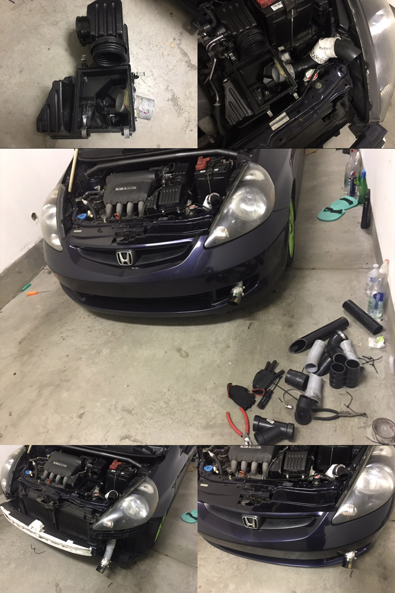

my new setup. I added a Y-splitter to increase velocity after the "y" and increase volume for top end speed. Freeway speed is unbelieveable...

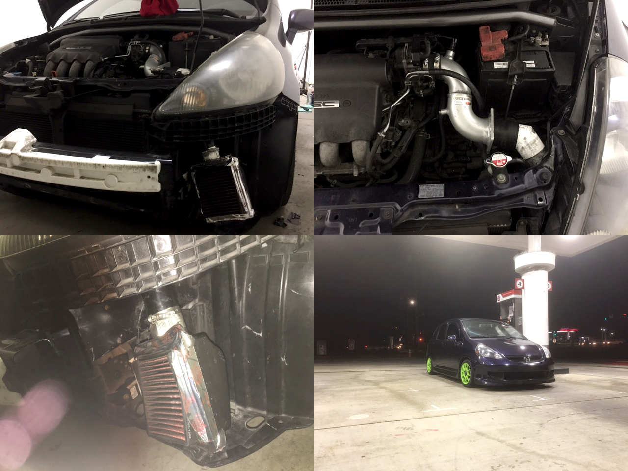

K&N Typhoon X Stock Airbox Cover = CAI ARC wannabe

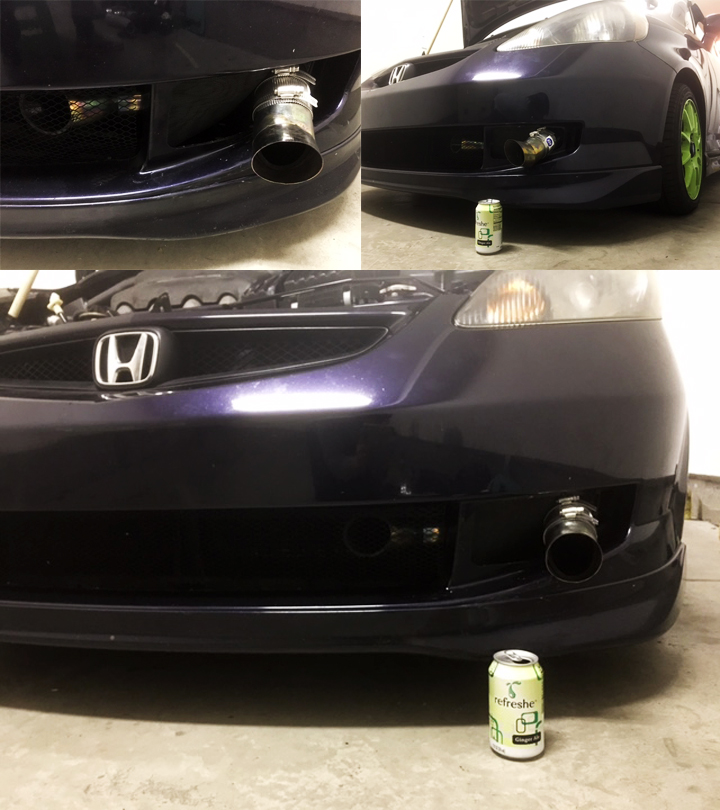

this setup is crazy loud and great top end.

My thoughts - since the air filter is one of the restrictive parts of the intake and our little engines have to suck air through there, the stock air box is one of the best design. It utilizes a pressurized box which helps with low end response. And since the air filter is closest to the throttle body, the engine can easily suck the air through it, where as most pod cai setup, the air filter is furthest from the throttle body making it harder for the engine to suck air through therefore losing low end torque.
My modded stock airbox - I cut the inlet runner and enlarged it to 2 inches in diameter and extend it to the front bumper to ram air into the airbox raising the pressure and when I open the throttle, air is ready to cram into the cylinder. Some say ram air doesnt have an effect until 150mph, but you still feel incremental increase performance as you get moving even at a slow speed. The longer runner also helps with the lowend torque giving a high velocity of air into the airbox.
This new version that I just created has a y-splitter. Short runner for top end and long runner for lowend torque and ram air effect.
Edit : I think I am satisfied with this intake after all the variations that I've gone through...
