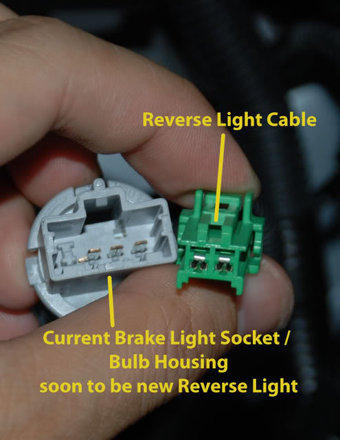

I got these Junyans off ebay:
They aren't plug and play. The issue is the reverse light socket/bulb holder is too small and won't fit in the Junyan reverse light hole.
However, the OEM brake light socket/bulb holder will fit in the Junyan, but the reverse cable won't fit in that socket (see pic 3).
Is there an adapter that can make the two fit? I would rather not splice the OEM wiring. I would like to be able to return to the OEM tails easily.
Pic 2. Just for reference, here's what the back of the Junyan looks like. In the picture, the wire extender (brown plug), is in the amber turn signal hole. (Note Fig. A) It is more suited for the LED Brake light--brown plug should plug to the end of the LED Brake Light cable).
Pic 3 (How can I connect these two without splicing?)

Thank you for the info and the part number!. Where do I get the 4-pin connector from? Just at the Dealer or an online parts store like College Hills? or is it more common I can get it at a hardware store?

I was able to install these, thanks to Zalthras' helpful post and the part number.
These are the Junyan clear/chrome LED tail lights, which I imagine is a copy of the Axis Styling brand (??????????). They are NOT plug and play (atleast the ones I got off ebay--meaning yours might be but wasn't for mine).
The issue is the hole in the tail light for the reverse light bulb-holder is too big for the reverse light. The work around is to use the OEM brake light bulb holder as the new reverse light. To do this, you have to do two things to each tail light.
1) You have to carve the plastic tabs in the hole (the thing that allows you to twist and lock the bulb-holders in place).
2) You have to use a new plug because the green ones won't fit. You can order it at an online parts store like College Hills, or Bernardi. The part number is: 04321-SH2-305, and comes in packs of 5. Just unclip the green ones, and put the new on one. The black cable is in the middle (2 of 4) position, and the green cable is in the 4th position, if you look at the plug oriented with the tab on the top. I have pictures but can't upload at the moment.
