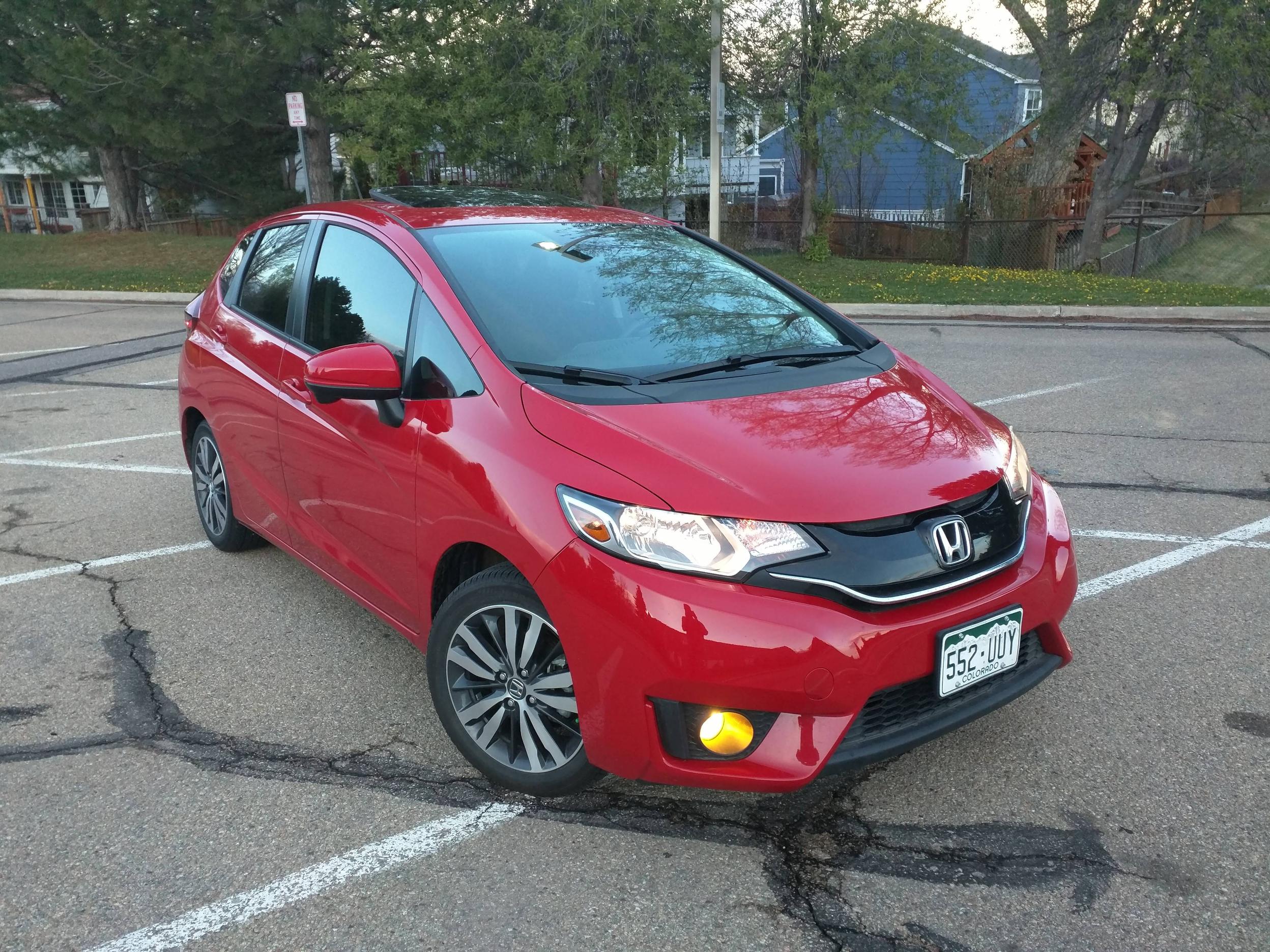

I've looked at a few different LED DRL options and like the JDM vertical strip that flank the fogs on the outside. They're pricey but I'd love a set.
Here are the yellow bulbs installed.
