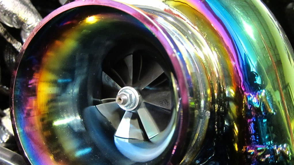

car started, IQ3 wired up and programmed

Originally Posted by JCrimson
was it hard to install the IQ3?? tons of wires? splitting wires? or easy mode kpro 1 wire like kit? haha
just want to know what im about to get myself into. pics please? video of it? i love you
The whole wiring process take a really long time cuz we basically have to build an entire new harness for the car
Instead of jumping off of the Oem fit ecu, we used a rsx ecu with kpro installed n all the wires R hook up into the kpro, with extra 4 out puts
For fuel level .... U have to get a separate unit
Also u have to program the iq3 to read what u want.... I think that's the hardess part
