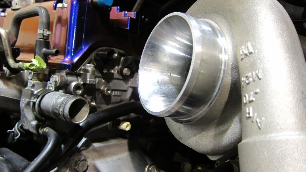

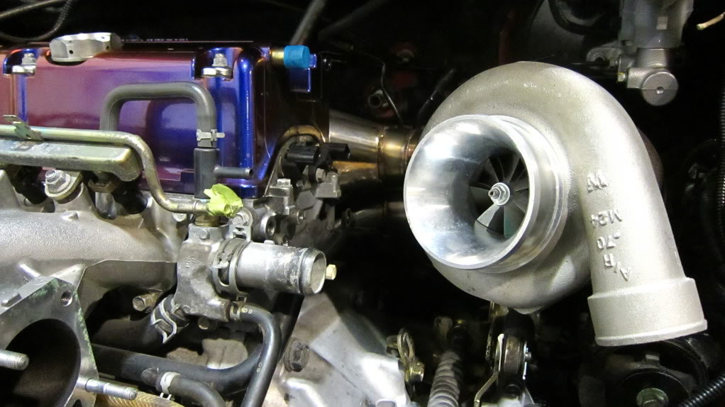

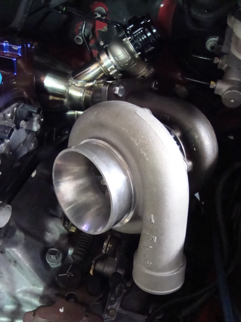

Oh very nice.. is the bell horn v-band/wiggins clamped on the inducer?
Now I know why they dinged you $2.5k for a manifold fab... that sucker has to support ~35lbs of turbo haha
What compressor is that? Looks like a Garrett GT40R/GT42R or a BorgWarner S400? Thats gotta be at least a 75-80mm inducer!
- why would u need to use a V-band on the funnel ? .. it is a HKS Unit, striped and polished ... it is held on by set screws.
-Turbo is a Greddy T78 34D
You don't need to of course. I was just curious
That just how i've seen them done lately.

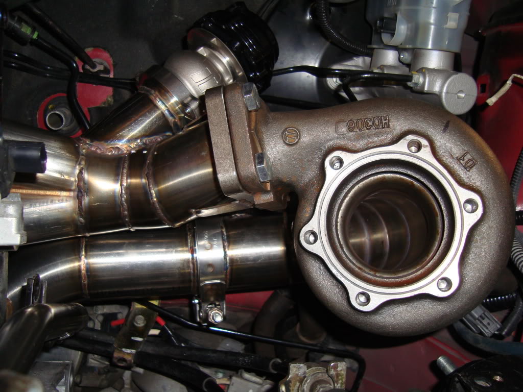

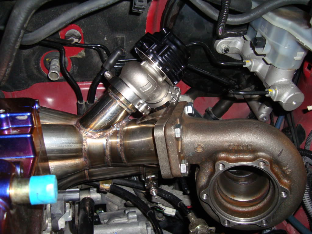

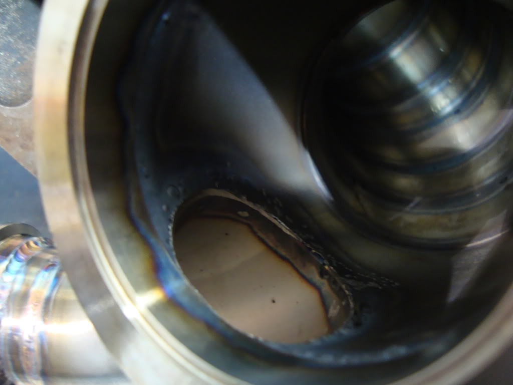

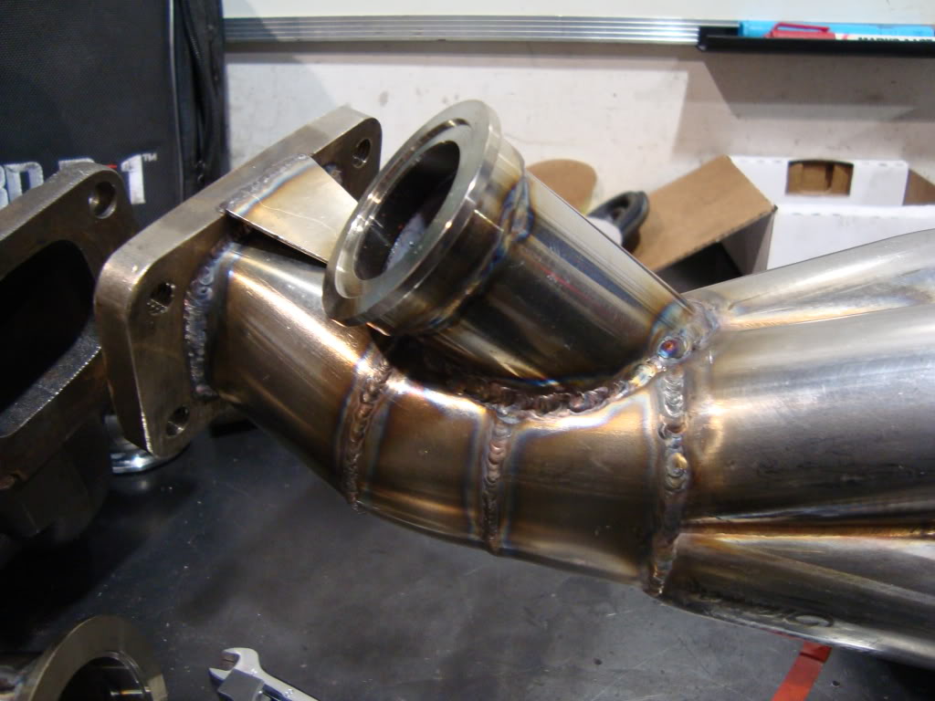

update!

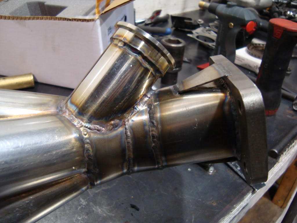

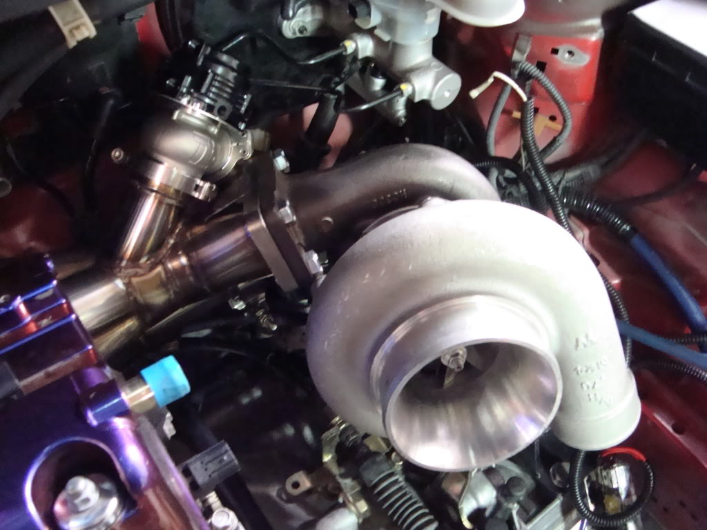

manifold 80% done....gota weld on the waste gate

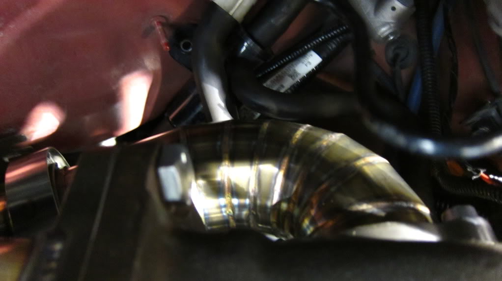

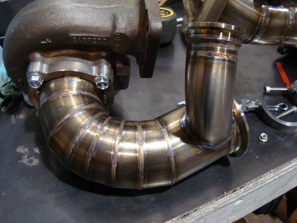

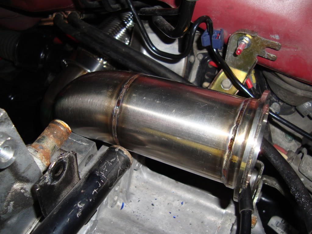

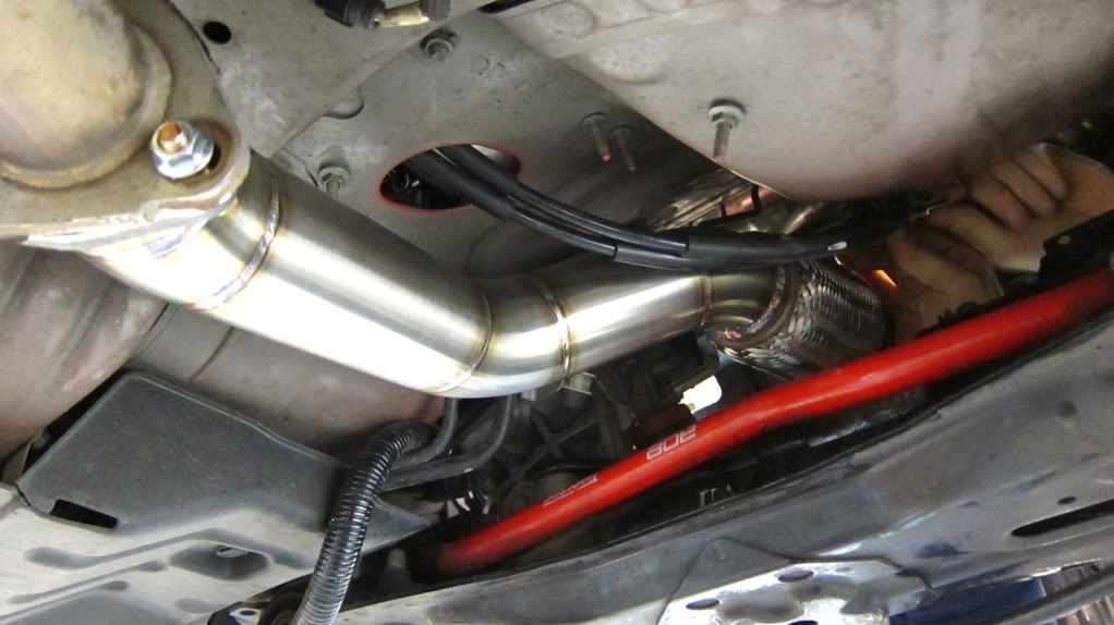

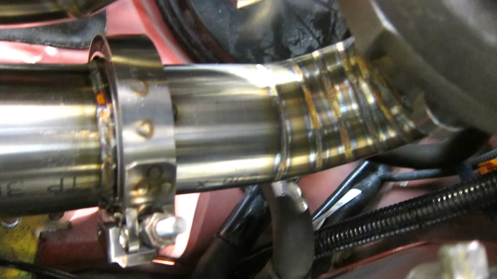

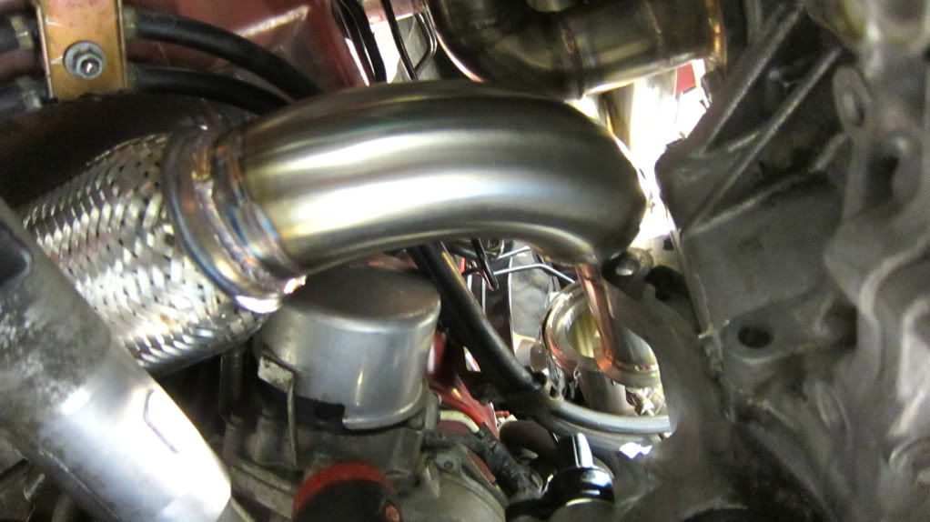

down pipe

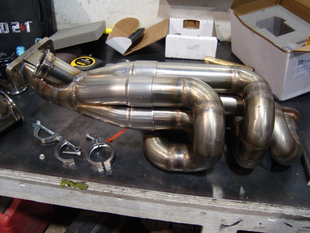

manifold by evolution performance

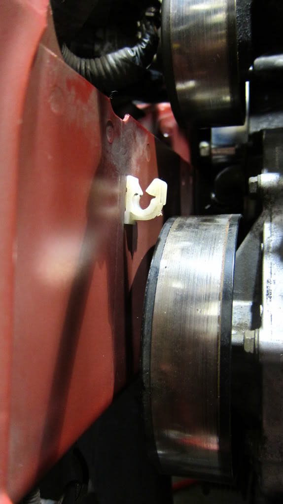

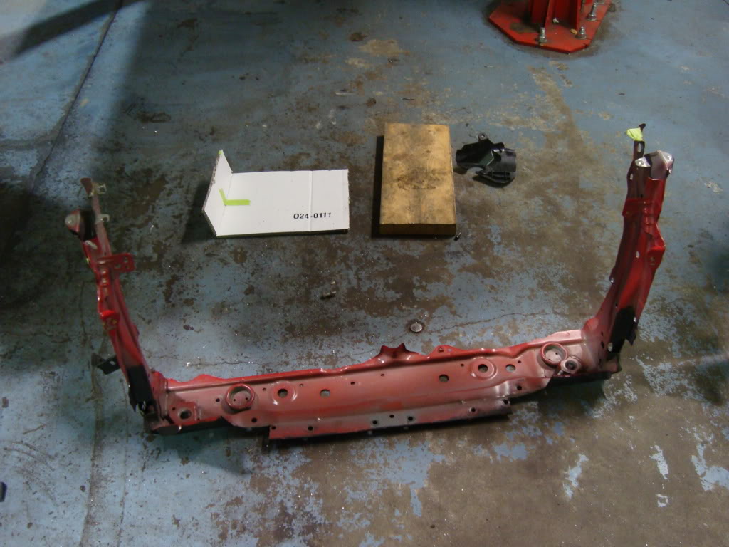

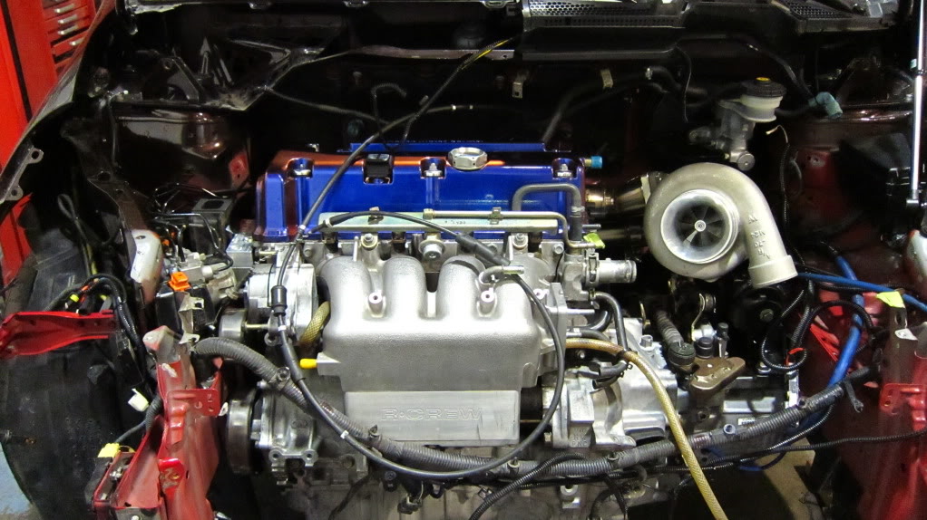

how tight it is to the frame...u cant change the belt without removing the engine

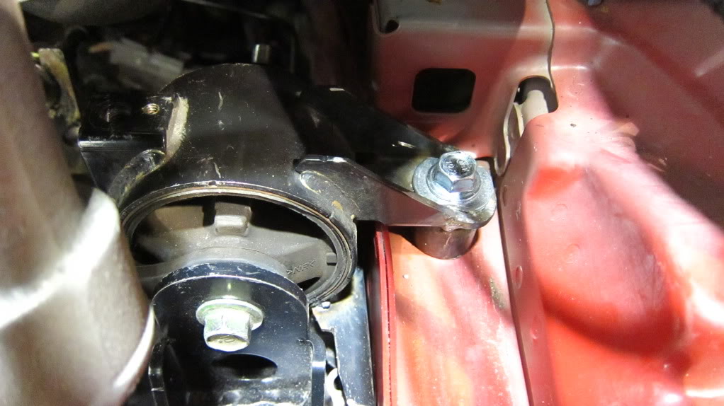

this is wat i ment about the differences from the AT to MT chassis

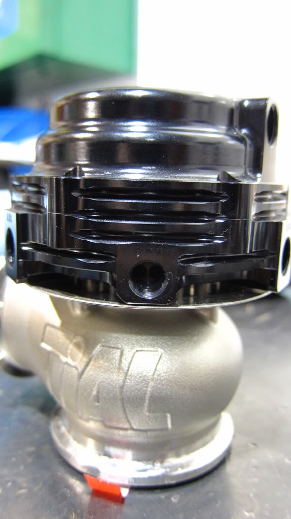

tial v-band 38mm

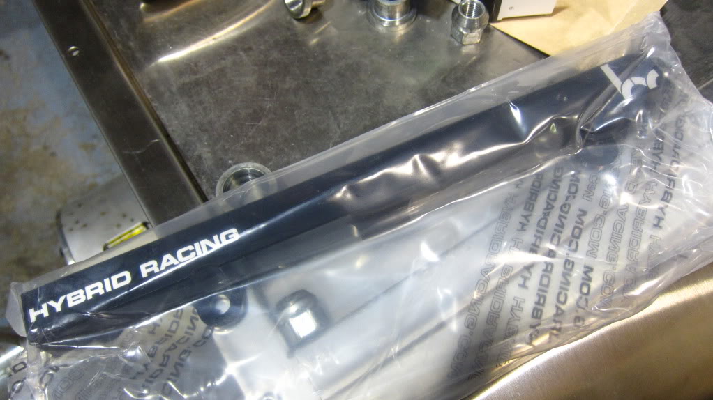

hybrid racing tuck fuel rail

Its looking good. So did you have the AT mount modified to work or did you get the MT mount?
Are you also relocating your battery, looks like the turbo is sitting in the way.
I see replacing the belt is going to be a PITA. Recently I helped my brother find the oil filter on his 06 Si. Having seeing wher its mounted have you had a chance to peek your head under there and see how accessible it is or even a pic?
Old Nov 22, 2010 | 03:53 PM
  #89
FELIXY69's Avatar
Posts: 2,790
From: RICHMOND BC CANADA
Battery was long gone to the back when i did the audio set up
AT or MT mounts.....
nothing worked...i end up making my own mounts
it's hard to get to the oil filter.
so i m having it relocated.

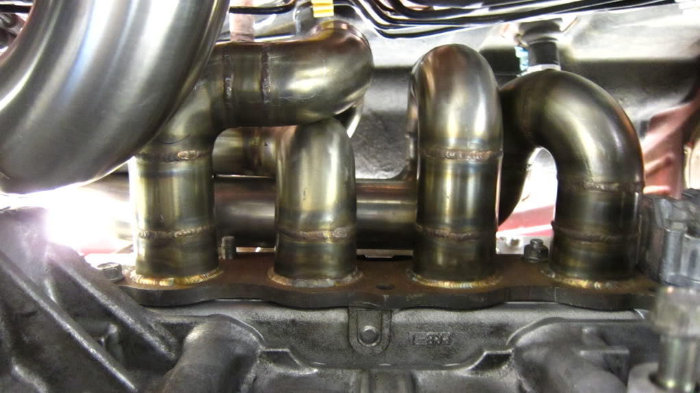

WoW...manifold 95% done
N looks what's gone ??

Amazing how much fabrication goes into just a manifold.

Those are the same sort of runners you see on full drag, standing mile and land speed cars! That will be a blast up top.
They look to be a necessity here though.. Do you have any plans on a nice lopey cam to complement them?
Old Nov 24, 2010 | 02:37 AM
  #95
FELIXY69's Avatar
Posts: 2,790
the head was already done with toda A2 components
