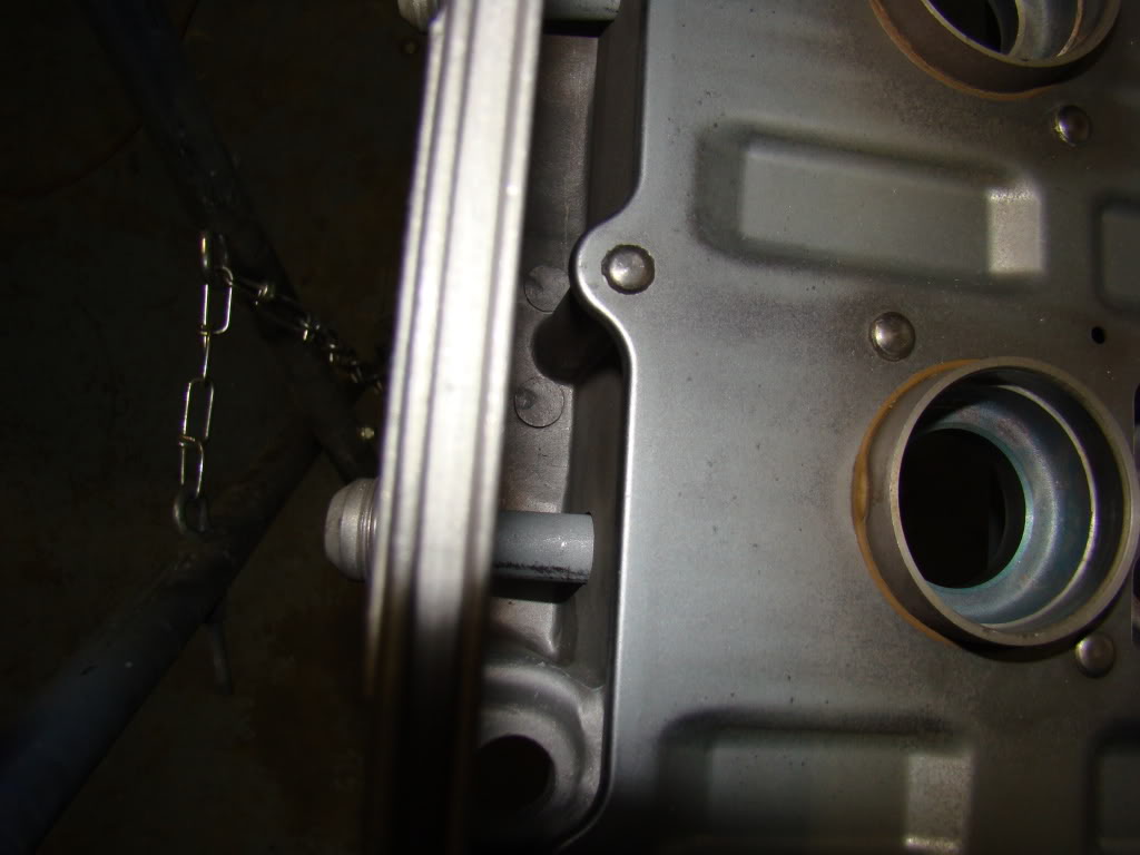

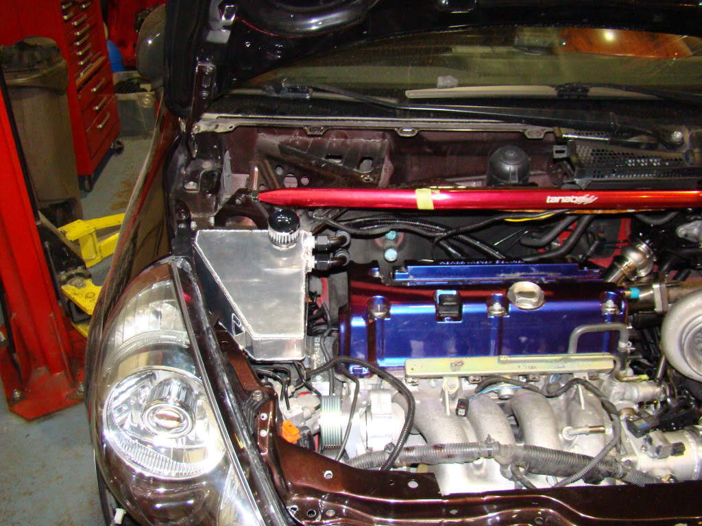

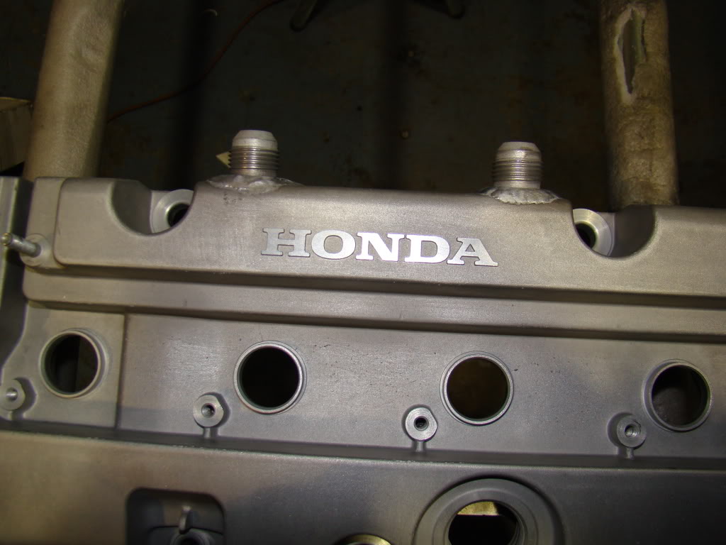

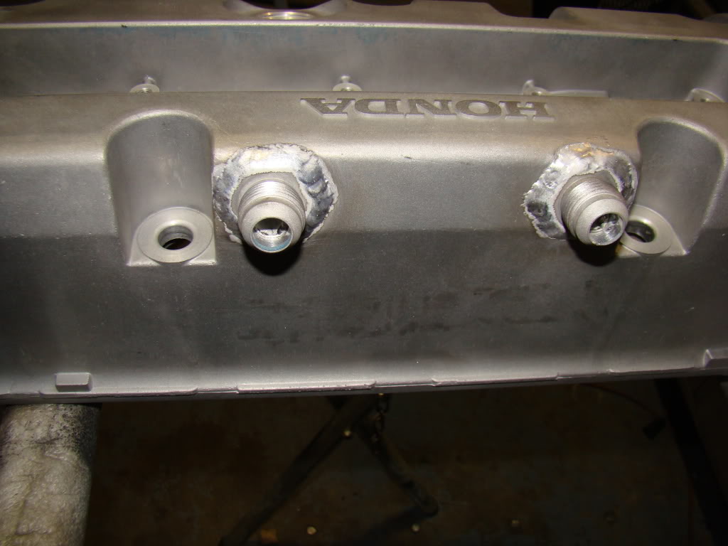

-Valve cover which will be Ti-Coated with AN fittings and internal tubes so it can properly drain the evaporated oil.

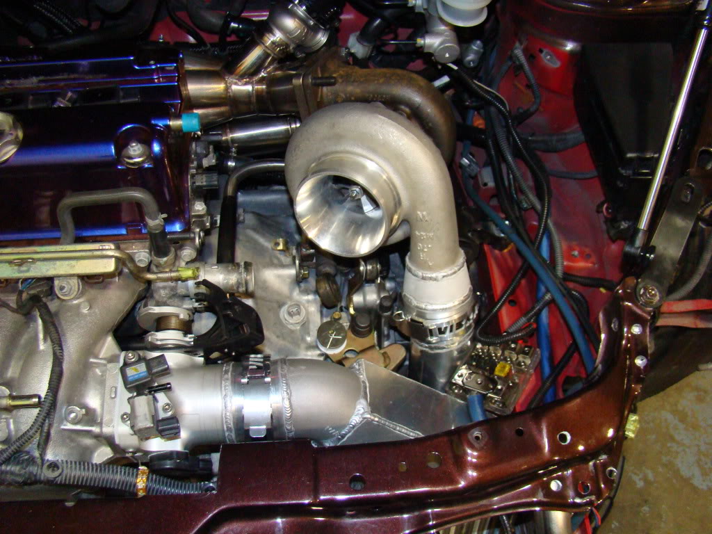

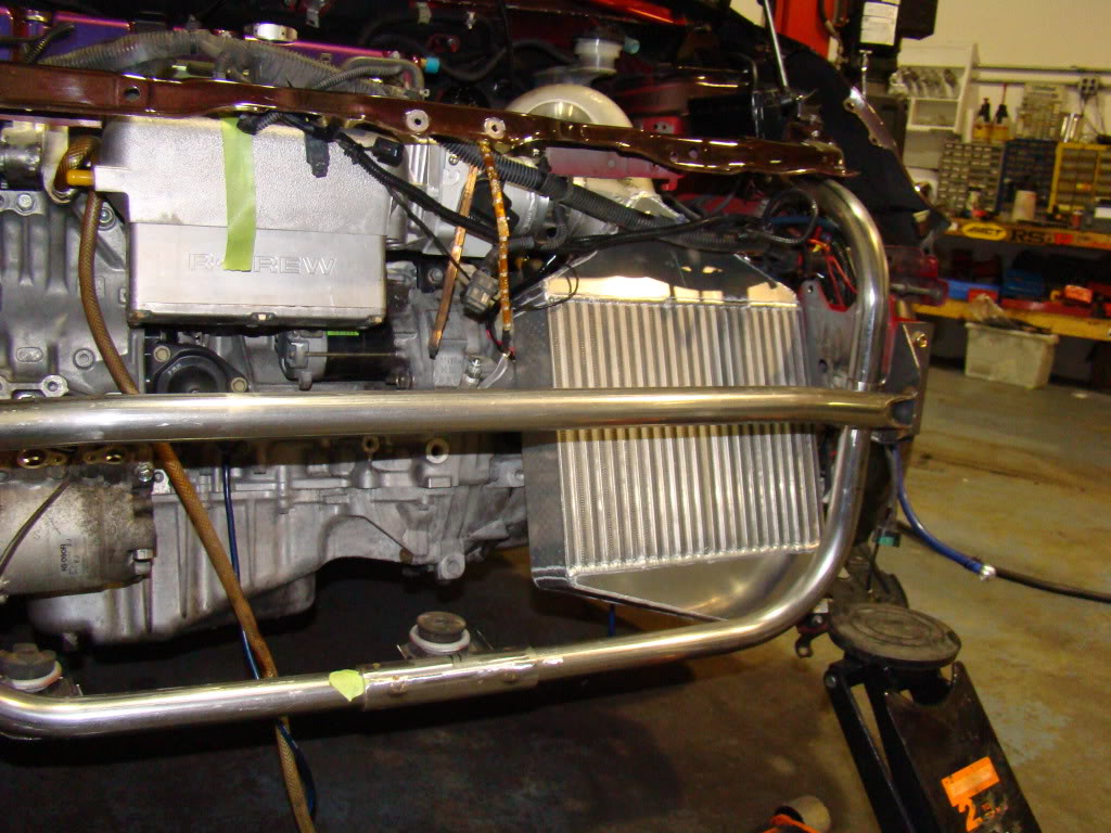

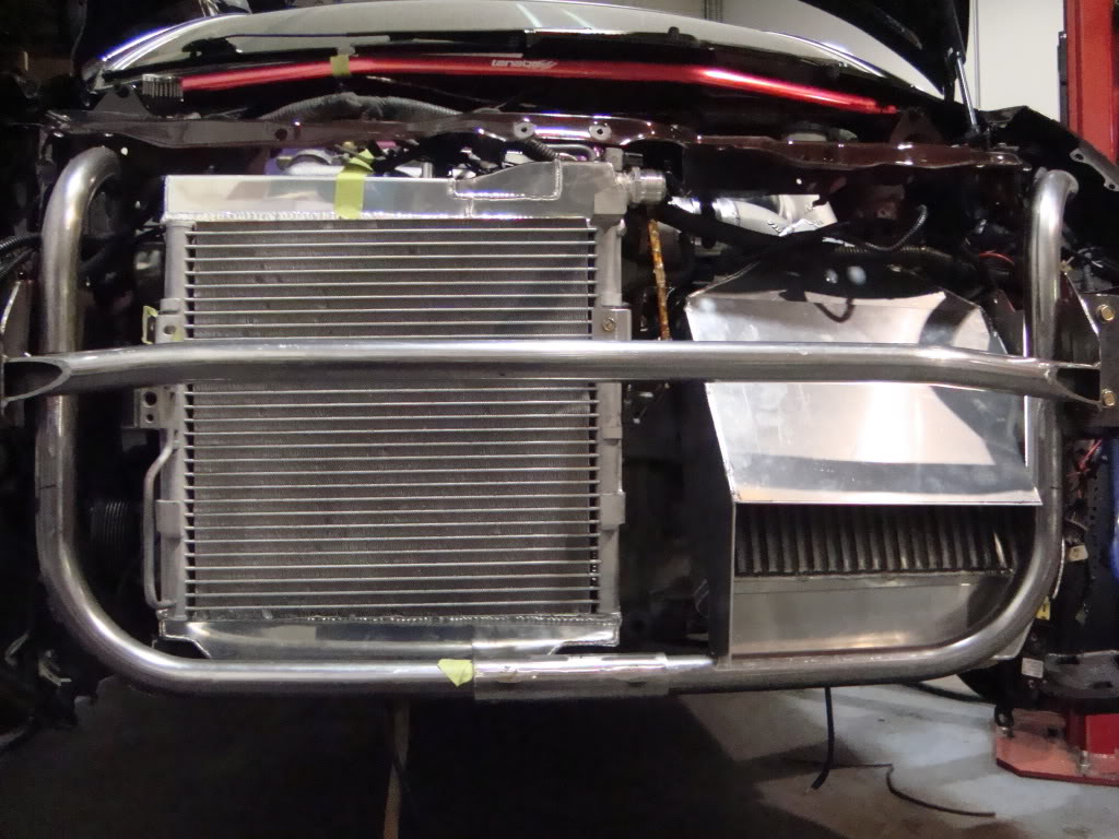

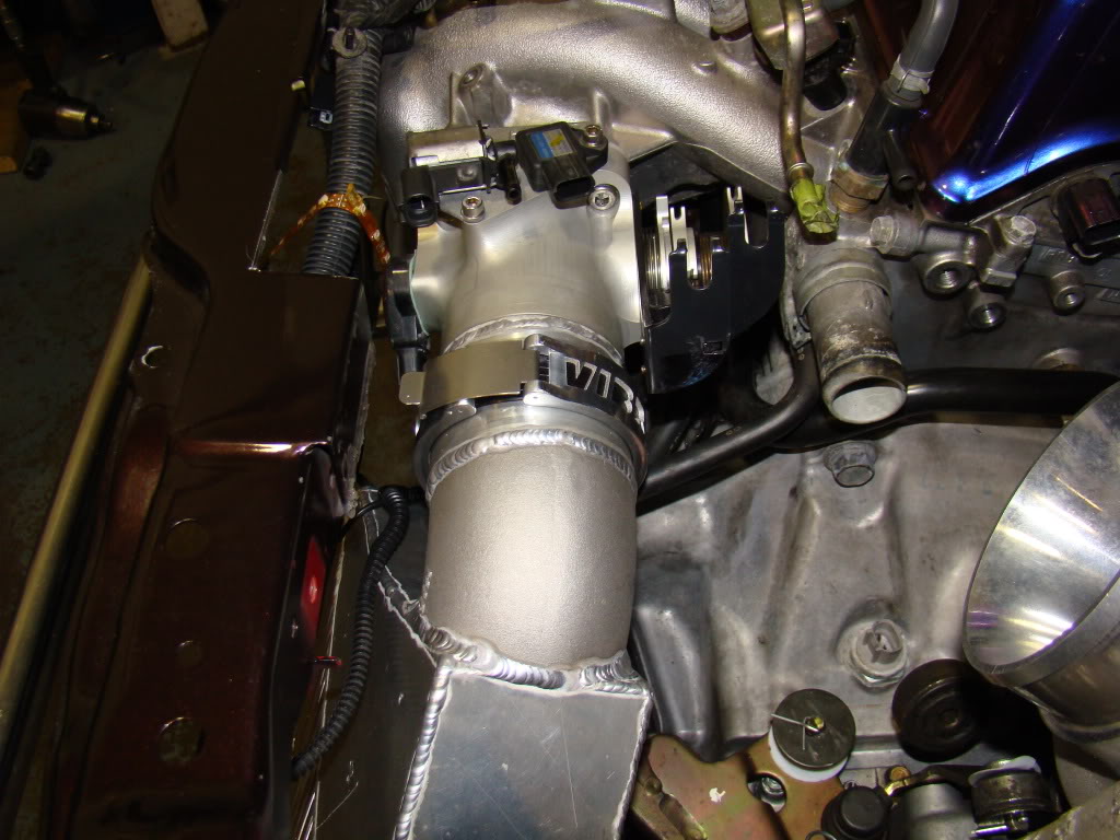

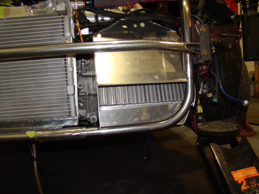

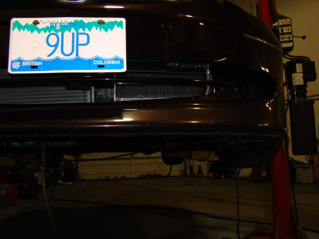

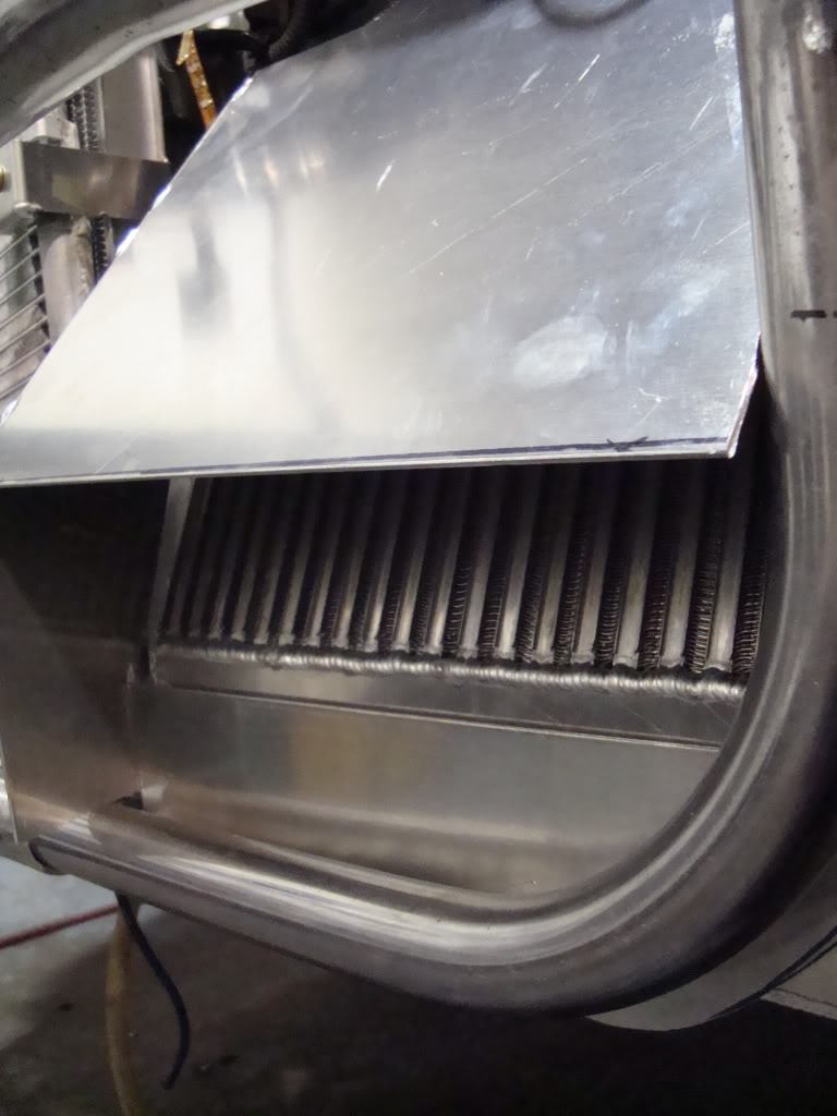

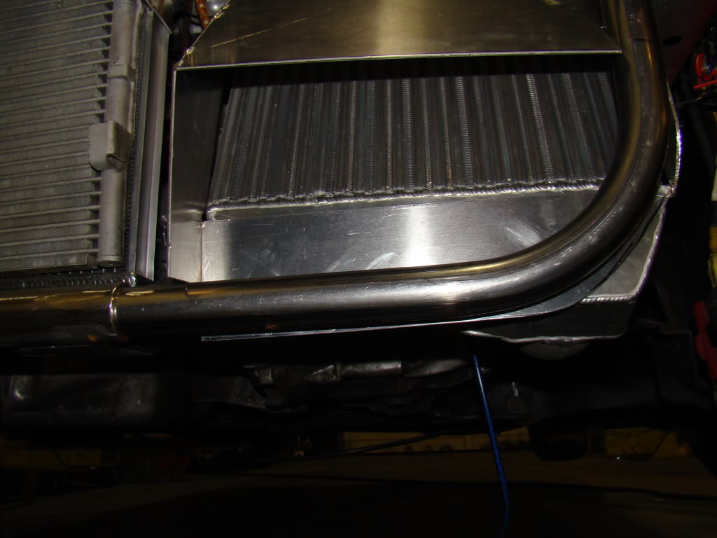

-Intercooler + Ducting to maximize efficiency

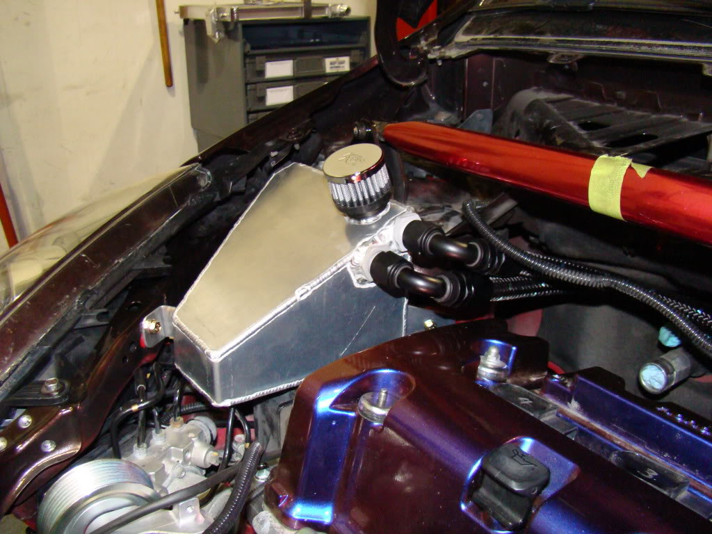

-Custom Oil Catch Can

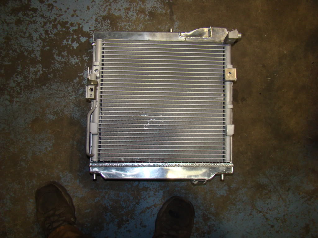

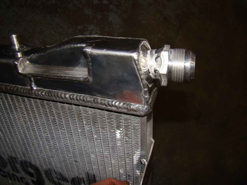

-Radiator + Radiator Mounts + EG AC Condensor

nah no vented hood
as for heat issue, we will be coating all the heat components and then wrapping all the hot pipes, for the turbo, we will be coating and on top will be a turbo blanket.
that should keep the temperature minimum.

that engine bay is stuffed to the max. someone definitely welded those an fittings on the vavle cover with to much heat.

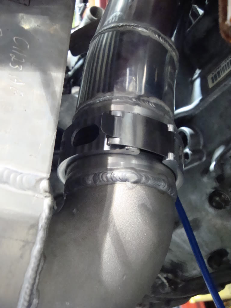

Close up on Intercooler ducting

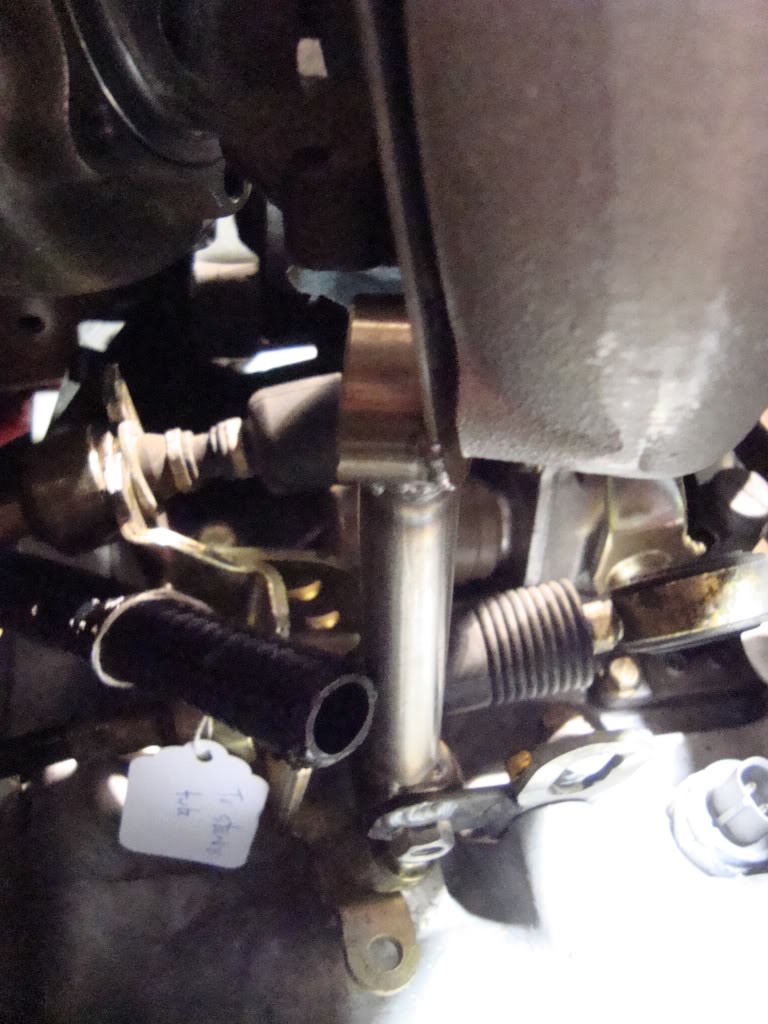

Stabilizer bar for turbo

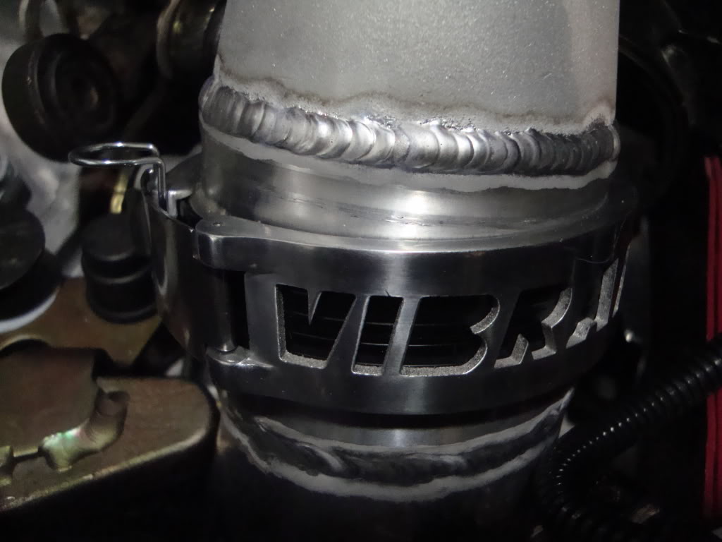

Venjen clamps

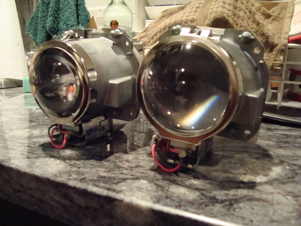

oh! and my NEW TL 3" Projector with ZKW-R Clear Lens swap !

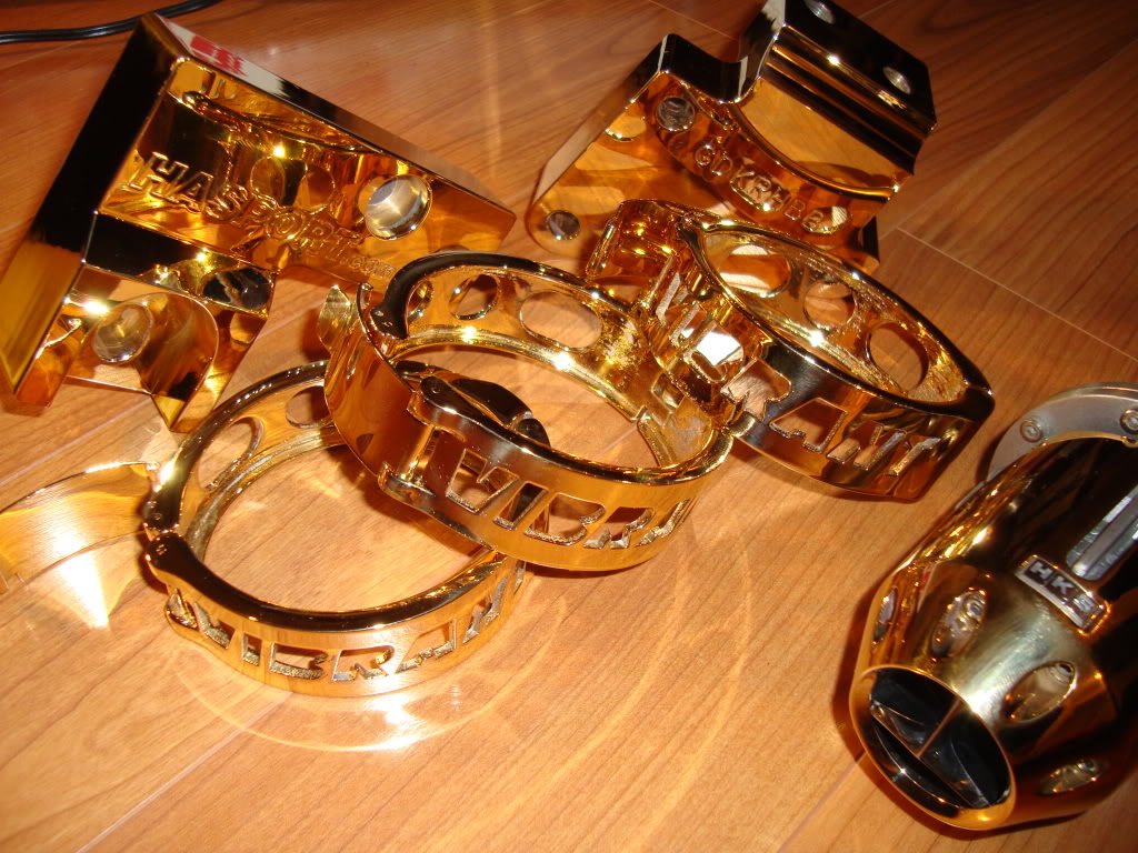

got parts back from Gold plating, and had to do it twice cuz the first guy i went to couldnt' get the finish i want so i had to get it done again by another guy
any how...it's done and over with....

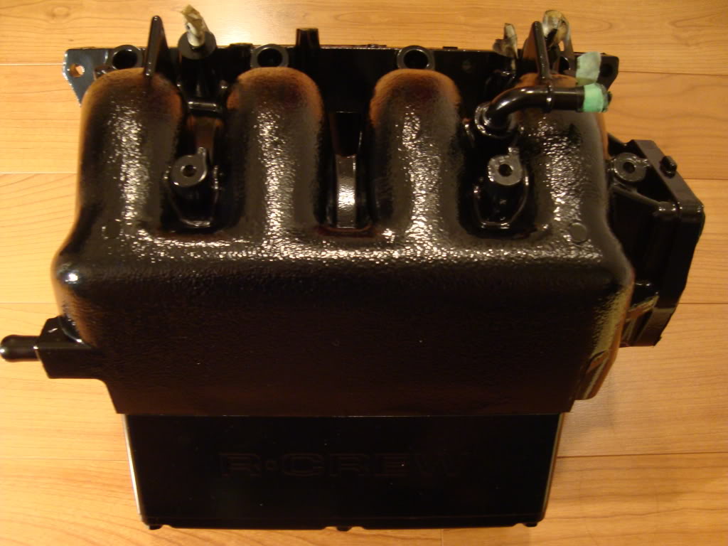

powder coated the DC5 type R intake manifold, and R-crew sump

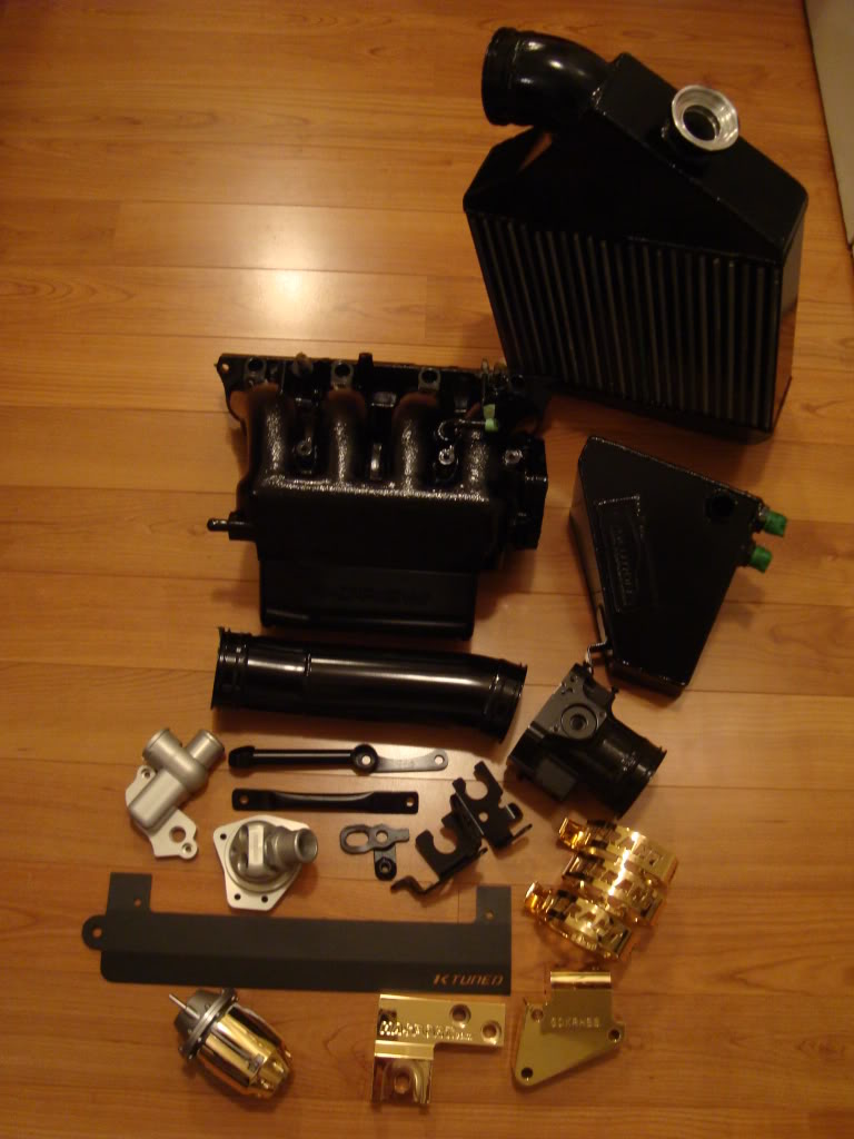

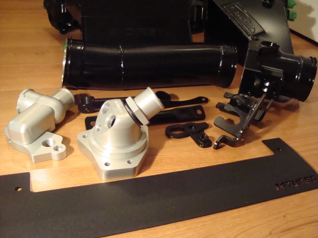

some parts from K-tune came in
