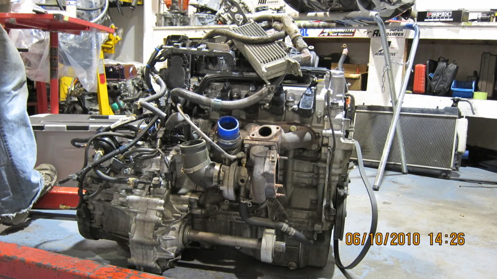

What manifold is in this pic BTW? That is on an L15A it looks like:
thats my L15 motor with the T1R turbo kit.
i am going with a Garrett T3/t4 for now cuz i have one sitting around and need to car running....i will prob go with a turbonetics GTK350

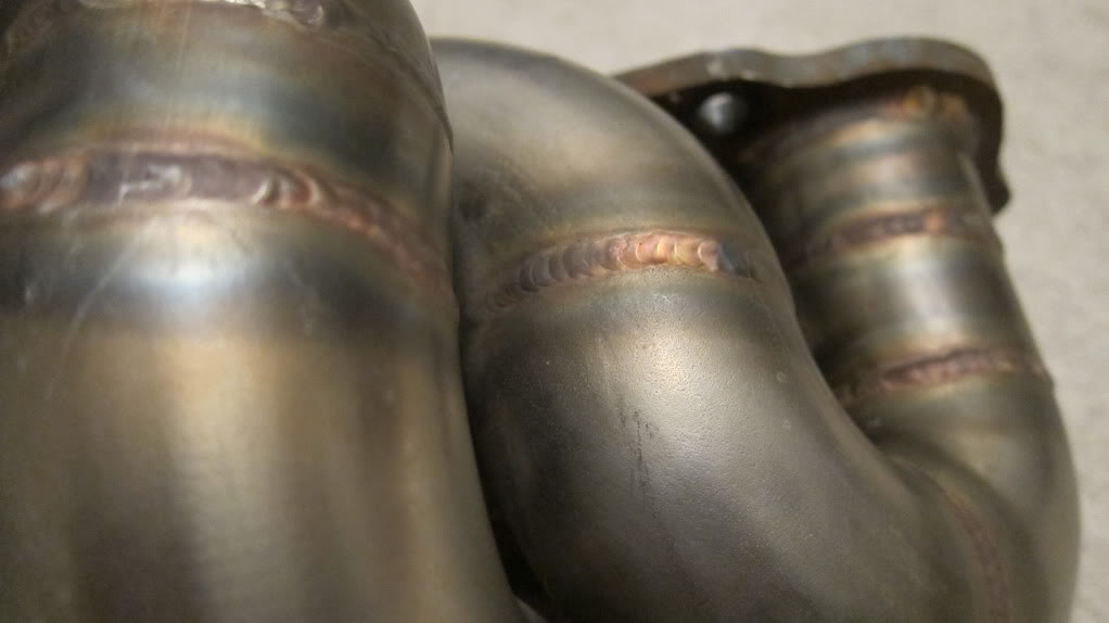

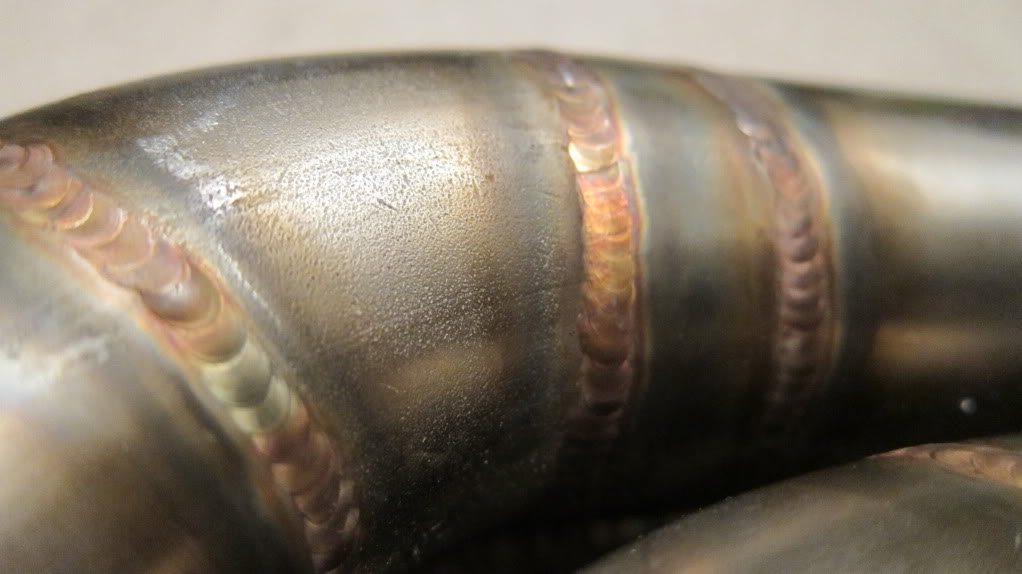

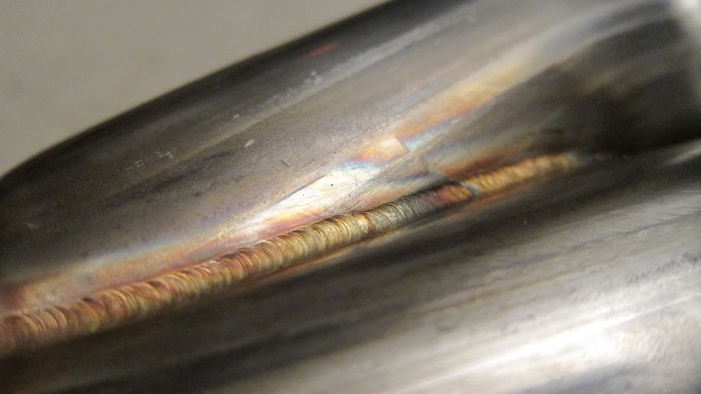

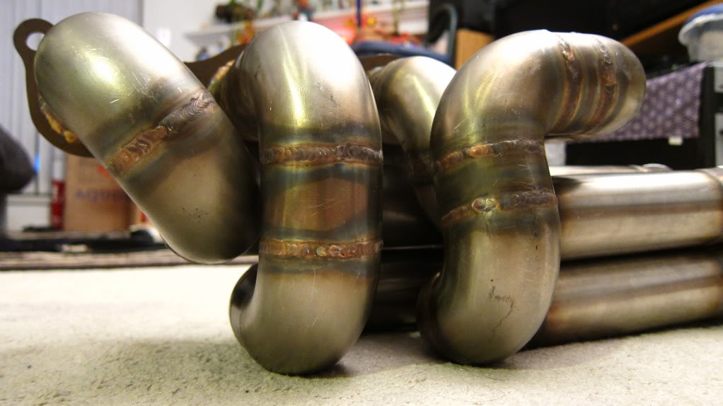

Nov 07 2010.....we have the manifold half made

Is that a forward facing turbo manifold? Sch10/40?
What size compressor/turbine are you planning on?
Will you be using methanol injection + premium pump, ethanol or race gas?
i wanna run meth just so i can push 350whp on stock motor and be safe with it.
but i have no room for those equipments so i'll see if i can make room or not...try to fit it.
as for turbo, at the moment i got a Garrett t3/t4 sitting around the shop, i'll make the car run for now with that...then going with Turbonetics GTK 350
94Oct. pump gas !
