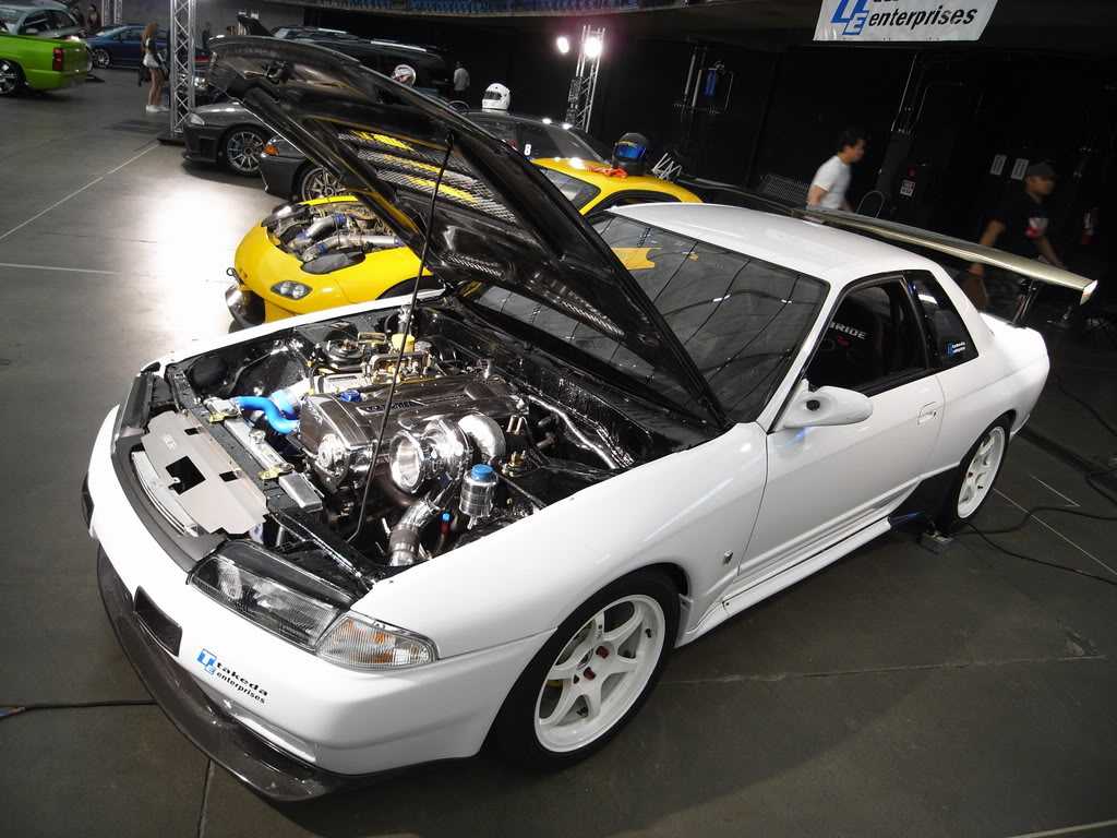

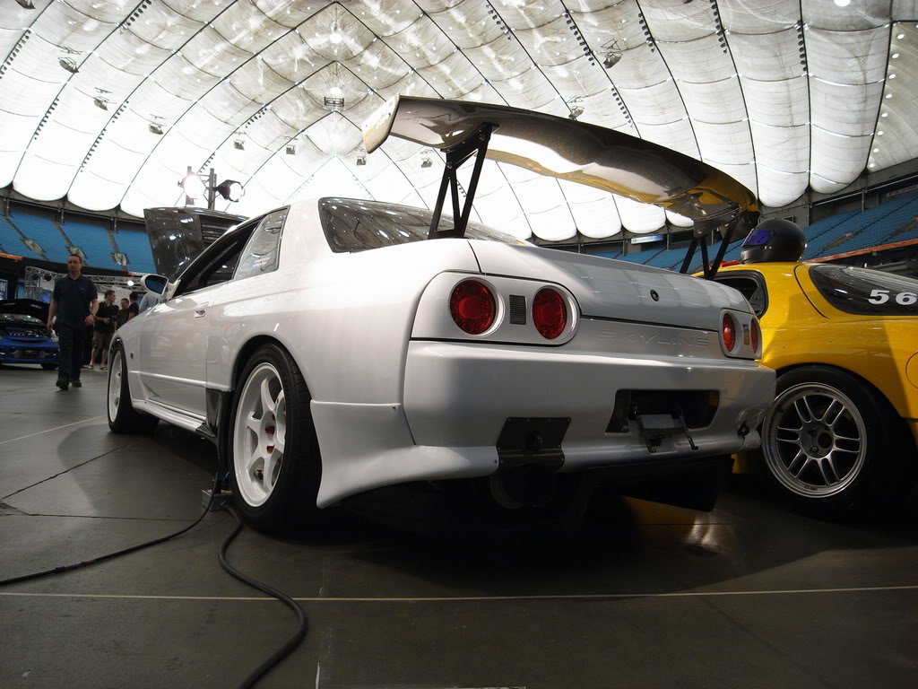

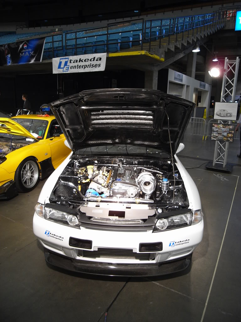

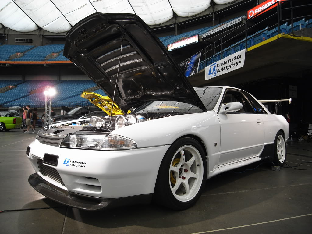

i thought i should post a pic of my GTR. so it will make it less of a mystery ...
lol

btw: as for the Fit, i am doing custom rad support (tube frame), single side rad should be enough !

Oh very nice.. is the bell horn v-band/wiggins clamped on the inducer?
Now I know why they dinged you $2.5k for a manifold fab... that sucker has to support ~35lbs of turbo haha
What compressor is that? Looks like a Garrett GT40R/GT42R or a BorgWarner S400? Thats gotta be at least a 75-80mm inducer!
