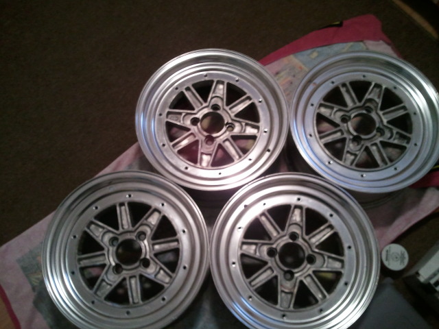

Shocks have shipped. Wheels have arrived. Fenders being rolled sometime next week.
So the last owner had some different taste to say the least. He sprayed them trying to figure out a color combo.
So I put some work in and this is where I'm at
Doing this is a pain in the ass but its gonna be worth it.

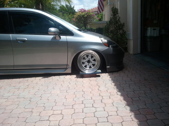

Stripped and ready to be painted

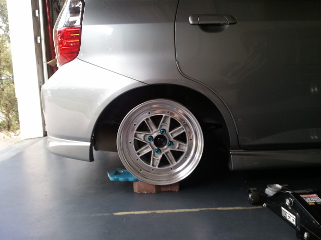

Test fit on the rear because the front needs a 10mm spacer or so

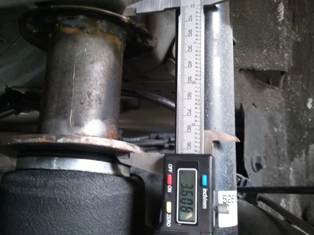

The bracket that is most likely going to be removed. 3.6in lower here I come
Gonna result in some sweet rim tuckage

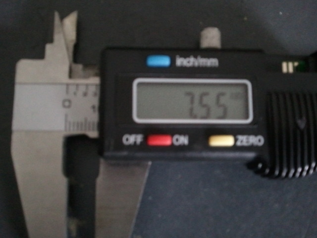

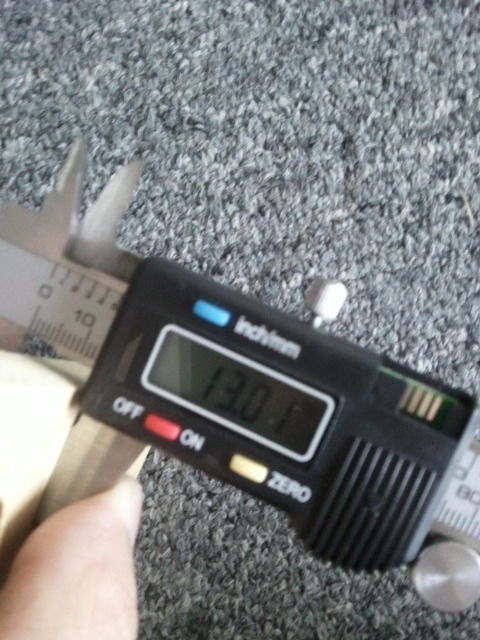

So I made a mock up spacer out of 1/2in mdf
It measures about 13mm thick
I now have clearance
A whole 7.55mm
So a 10mm spacer should leave 4.55mm of space which is enough. I guess I'm gonna order those along with extended studs. I really dont want to take the hub off and get new bearings pressed in
