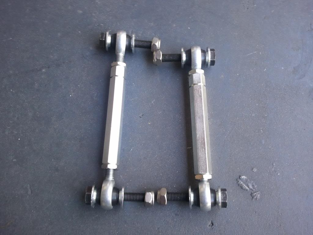

Working on getting the sway bar re-attached

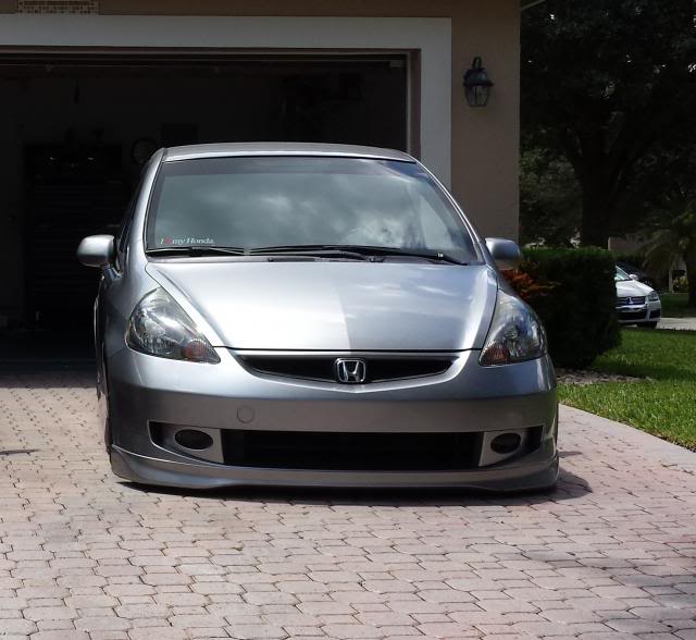

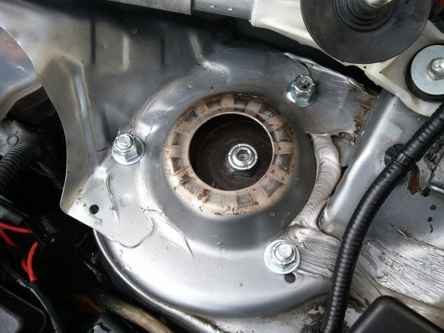

Finally got it back on the ground. Not much has changed, still need to get my sway bar re-attached.

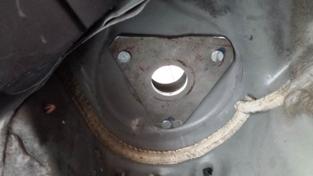

What I did do was fix the front upper mounting plate. Was too large before and wasn't all that centered:

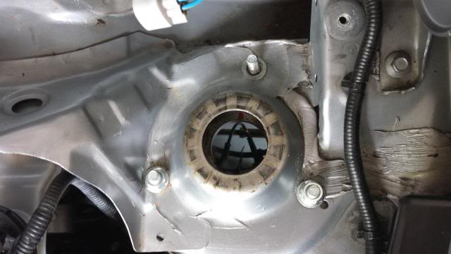

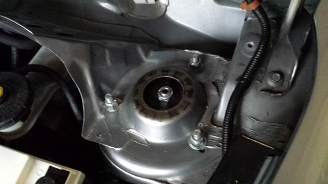

So its now cut and pretty much centered

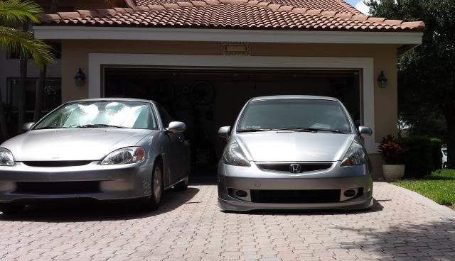

Next to the daily

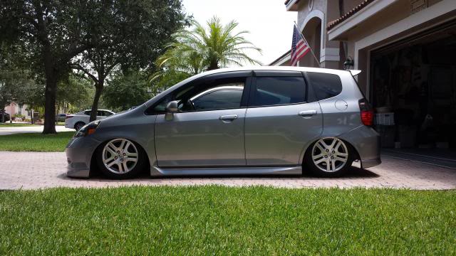

So I ordered wheels at the end of July. I got them the end of last week.
15x8.5 +27 SL disk, SBC finish
So I ordered them knowing they might not clear the front brakes. Nothing a small spacer couldn't fix, just had to wait till I got them to figure out what size spacer I needed. Turns out 2.5mm is what I need so I ordered a 3mm spacer.
Fitment was spot on. Glad that I can still do math
Just needed some tires, 165/55r15 Achilles is what I ended up with.
Spacer for the front hadn't arrived yet so just put the rears on for the time being.
ASS ASS ASS ASS ASS
Threw my temporary spacers on this morning (washers lol, just to get the wheels on and in the driveway for pics)
Couldn't be happier with how it turned out. Just need to figure out my driving height and get an alignment and its ready for some long needed mileage.
