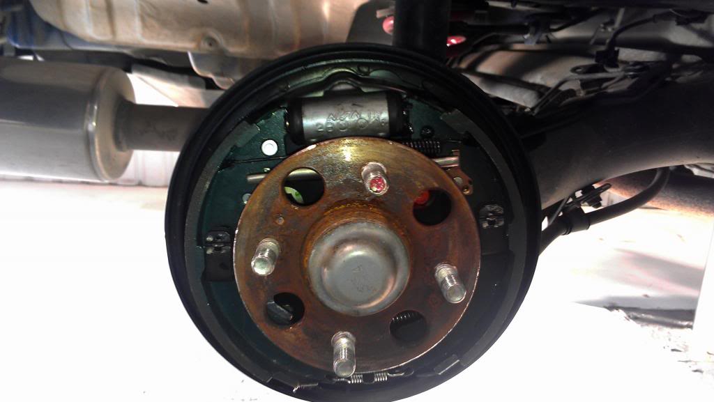

Update: The Carbotech 913 shoes are ON. ... but the rear brakes squeak like hell now.
The initial install attempt, kept getting interrupted by coworkers and didn't even disassemble one darn side. Second attempt got the 913 shoes installed on both sides thanks to the help of a few friends at MSR Houston (thanks again guys ^.^). They still squealed at that time even after lubricating the 6 points on the backing plate where the shoes contact.
Later inspected the shoes, re-lubricated the 6 points as well as adjusted the adjustment fork for the shoes and they're still currently squeaking/chirping on while driving. No signs of abnormal wear on the inside of the drums or on the shoes themselves plus everything is secure on both sides. Finally got a case of the "F**k Its" and left it alone for now. Might have to lubricate both sides of the adjuster where the shoes touch... Don't want to think too much about that headache at this time though, they may also just need bedding in since they are a more aggressive compound and I didn't turn or replace the drums.
