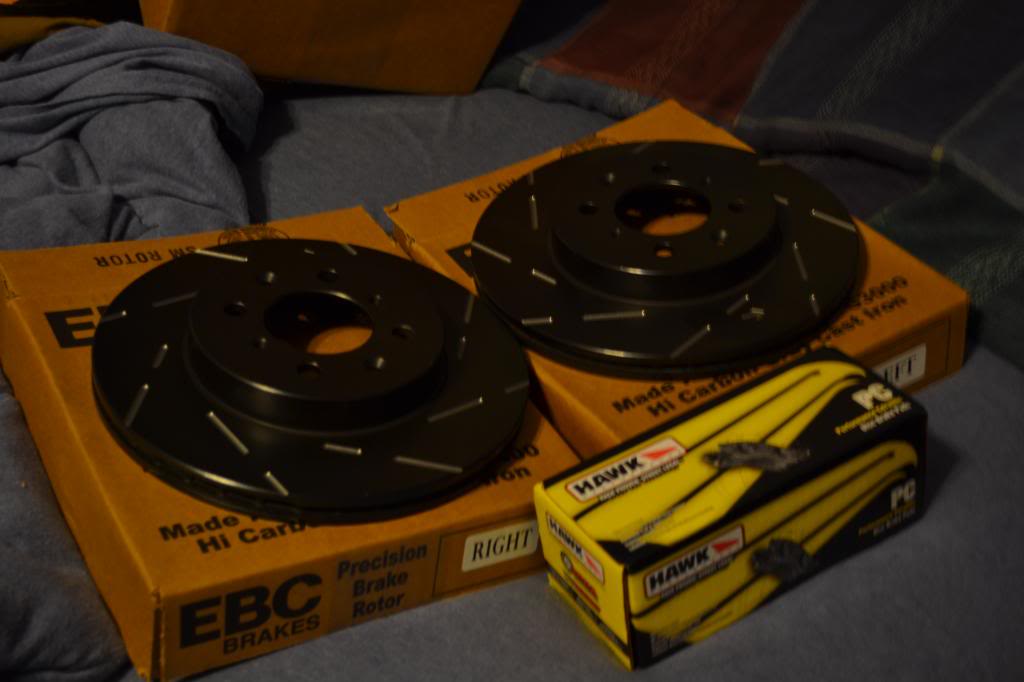

A change of pace was needed at that point, going on 4 years of ownership then (around 50k miles) and the only thing changed were tires and the installation of a Progress RSB which was acquired from member allgocrx. The bar was a nice addition but there was something still missing. I've been getting more comfortable with being able to control the car during spirited drives but have occasionally had issues with brake cooling AND the front rotors were warped. So, I picked up a pair of EBC USR 850 rotors with some Hawk Performance Ceramic pads then ditched the Konigs for a set of 15x7 ET+42 TRMotorsport C1s (12.8lbs per wheel).

After the rotor, pad, and wheel install the brake cooling issue was resolved... maybe perhaps a bit too well since its for daily use and the initial bite does not feel as prominent as stock in stop and go traffic. Primarily due to the slotted rotors being better at dissipating heat better than the OEM solids and pads. To remedy this, I gave Carbotech a call and ordered some AX6 pads for the front (autocross compound) and 913 compounds for the drum shoes. These should be installed soon.

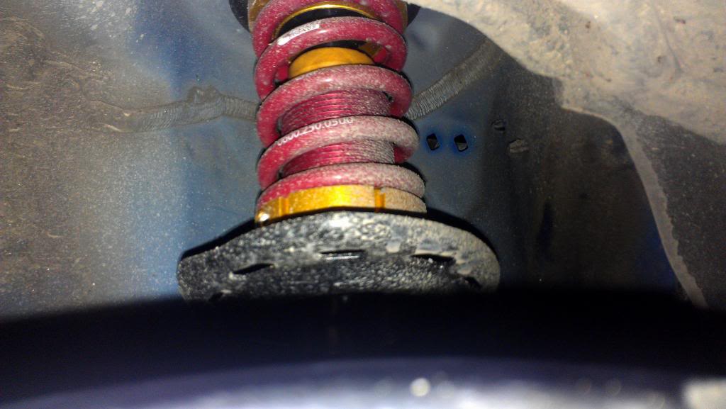

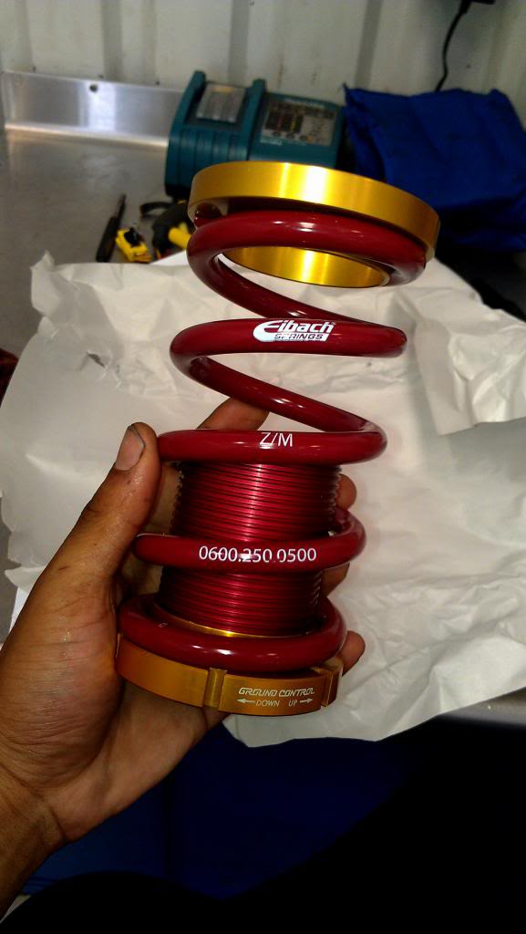

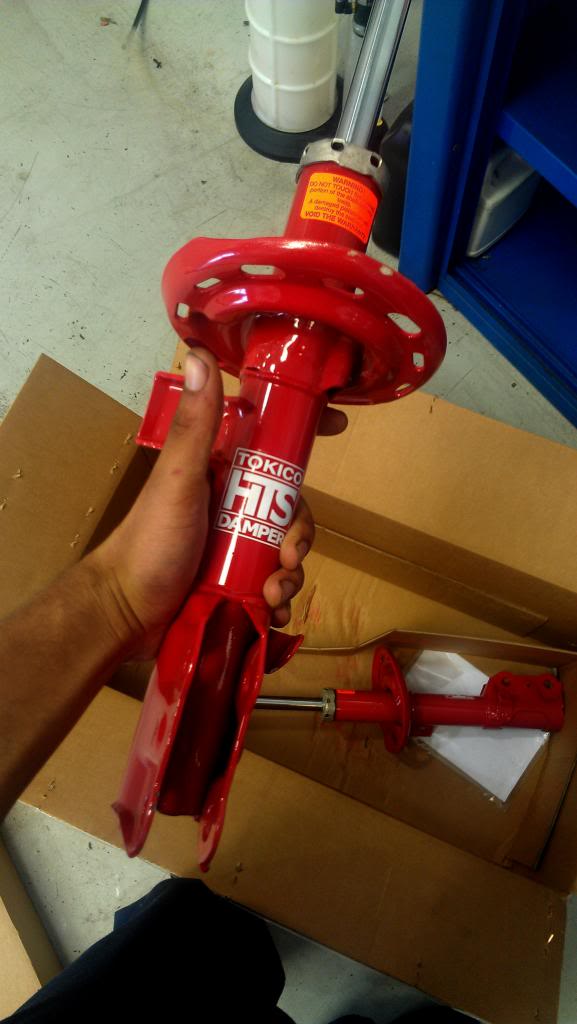

Here's a shot of the set front struts test fitted. As you can see the Ground Control sleeves simply slide onto the strut and rest on top of the natural colored gray metal ring on the strut body. Not shown in the image but there are rubber O-rings that must be installed on the strut prior to installing the adjustment sleeve to assist in reducing any horizontal play between the strut and sleeve.

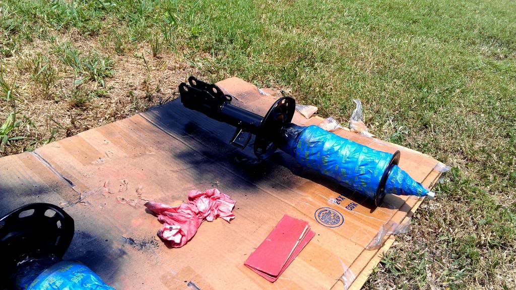

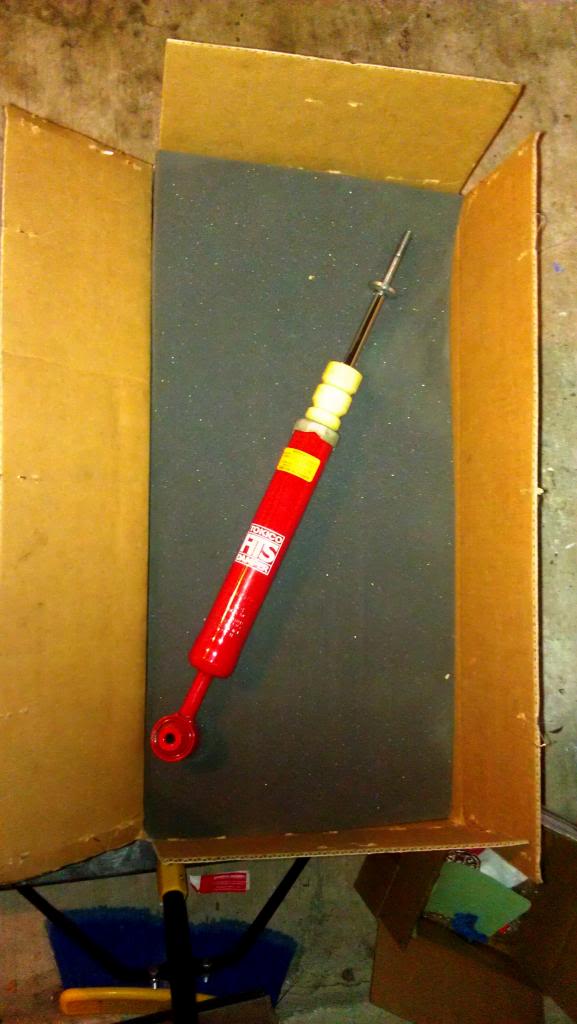

After test fitting and looking at the dampers in the sun, I decided the red was too damn obnoxious and rattle canned them Rustoleum's Satin Black. The end result was adjustable dampers that look OEM at a glance.
Size:  187.7 KBName:  IMAG0298_zps8b792c63.jpg

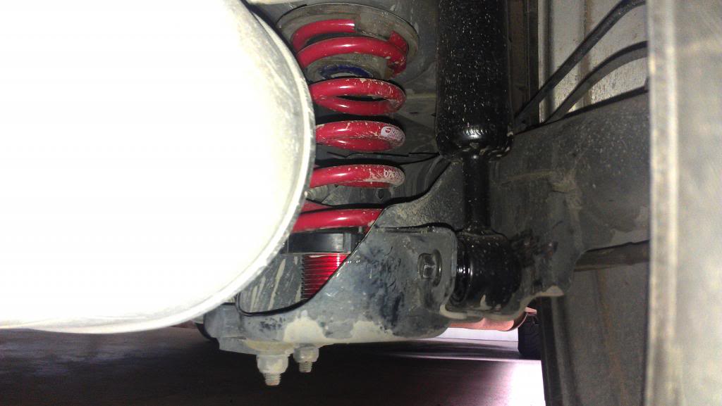

The only giveaway or hint there is any suspension changes is the bright red Eibach springs, red GC sleeves, and a slight forward rake (front end lower than rear). During the coilover install, I put on my 205/50R15 Yokohama Advan Neova AD08s that I had stashed away for this special occasion. The end result: A "stock-ish" looking Fit that should be able to hold its own on the autocross course or backroad.

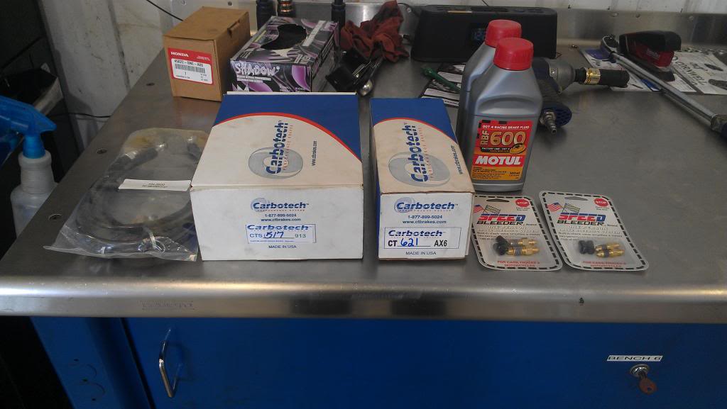

Update: Ditched the Hawk Performance Ceramic pads and replaced them with the Carbotech AX6 pads (Thanks to Mike Jr at Carbotech Brakes). Also installed the Techna-Fit stainless brakes lines (extremely messy job HA) and Speed Breeders brake breeders while using Motul RBF600 brake fluid to top off in addition to an oil & filter change with tire rotation.
Here's a shot of the goods pre-install.
The Speed Bleeders are direct replacement bleeder screws for the calipers and drums. They feature a sprung "check ball" inside of them which allow brake fluid and air to escape from the bleeder and of course out of the brake system during pedal depression. Once the pedal is back in the "at rest state" (foot off brake) the spring inside pushes the check ball inside, closing the bleeder and not allowing any air or brake fluid in or out. I will need to reorder a set for the drums as my Kobalt and Gearwrench 8mm wrenchs rounded off the head of the drum bleeders. (Yes, I am that OCD) -.-
IMAG0420_zps68197b57.jpg?t=1378516530
Initial impressions during test drive: Initial/cold bite is noticeably prominent as I drove around the parking lot to begin the pad bed in process. Brake pedal feedback wise, the brake pedal is much firmer that before the brake line install. I'll be taking it easy for the next week or so and taking alternative routes that require more frequent stopping to bed these pads in sooner then touch basis on this with a later post.
