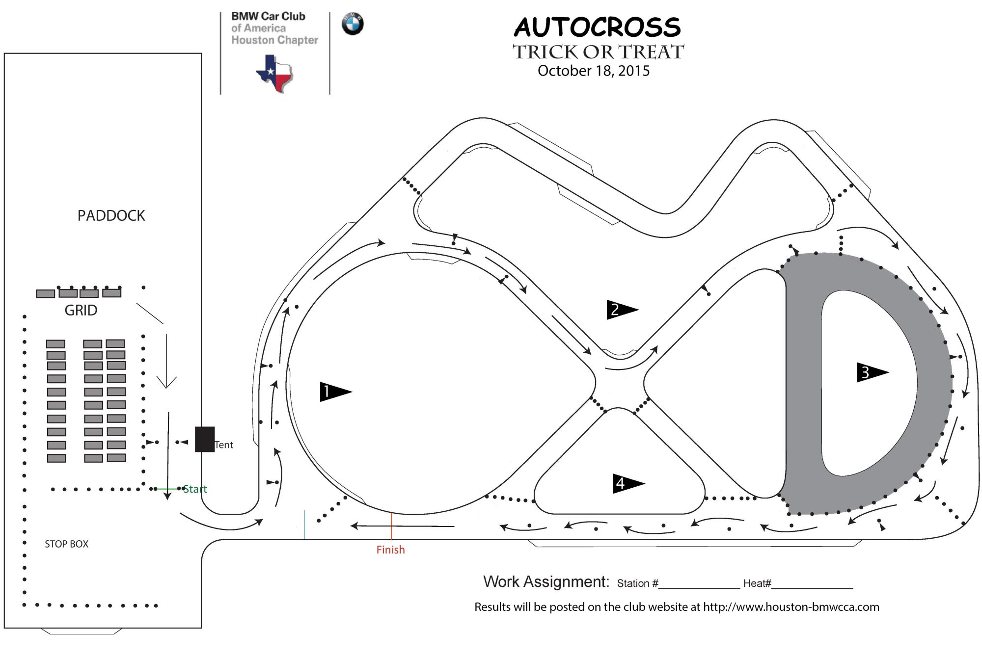

Another autocross day DOWN! I will update this post or thread later with more details on the event.
Course map...
