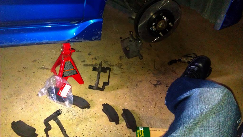

Hey everyone. Hope you all are doing well and those who are in the colder climate areas have safe travels on the road and are staying warm.
A little bit of an update on the GD3. Recently crossed over the 89k mile mark... mechanically, the car is as sound as it was with 4 miles on the clock. Just need to replace the ATF within the next 1k or next month as a part of basic maintenance.

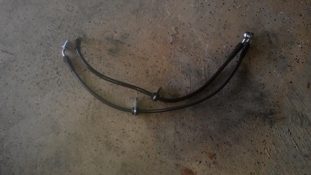

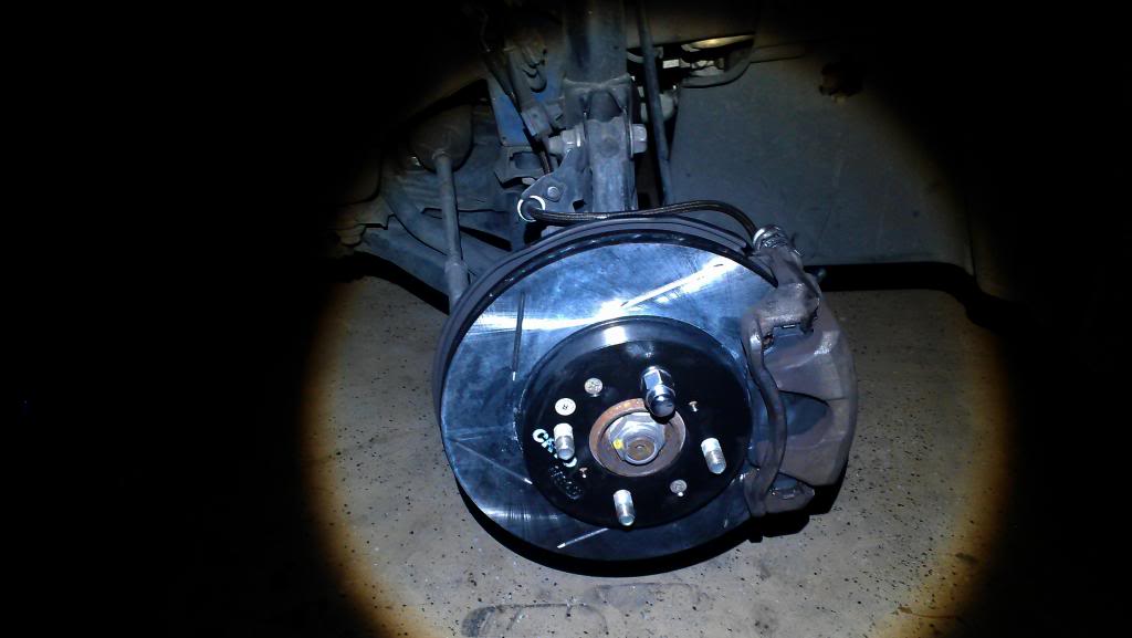

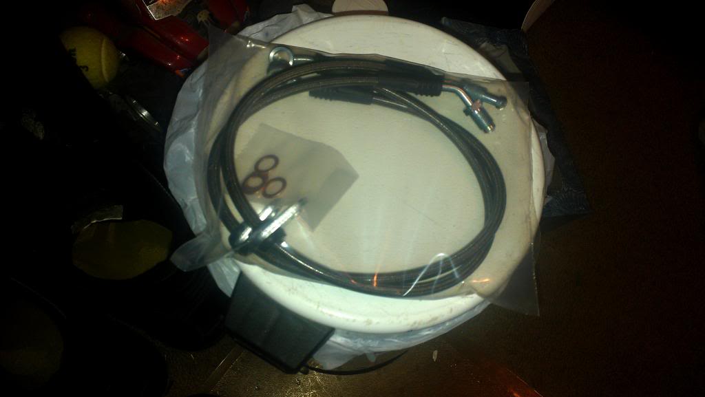

Back in September, I had installed Techna-Fit braided stainless steel brake lines both front and rear. After returning from TOTD (Tail of the Dragon), I had noticed that at low speeds when doing tight turns in/out of parking spots that there was a momentary "bind" or "pop". It turns out that my driver front brake line was actually RUBBING against my WHEEL. The passenger did as well but was remedied by taking some slack out of the brake line.

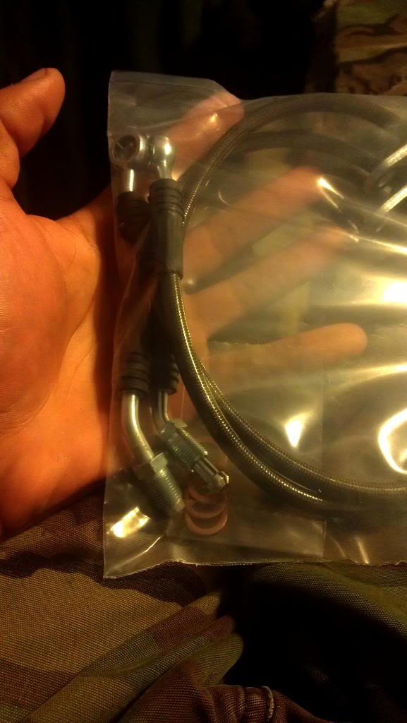

I shot Techna-Fit an E-mail or two and they sent me a pair of new revised front lines. I was told by the president the lines they sent will be the "updated"/"replacement" for the lines I originally ordered if they would work. They feature a mild 35 to 45 degree elbow to help "clock" the line in place for optimum clearance AND to help give the line a little more slack/room to run when going from full steering lock to lock. It works like a charm.
Old (top) vs. new (bottom).

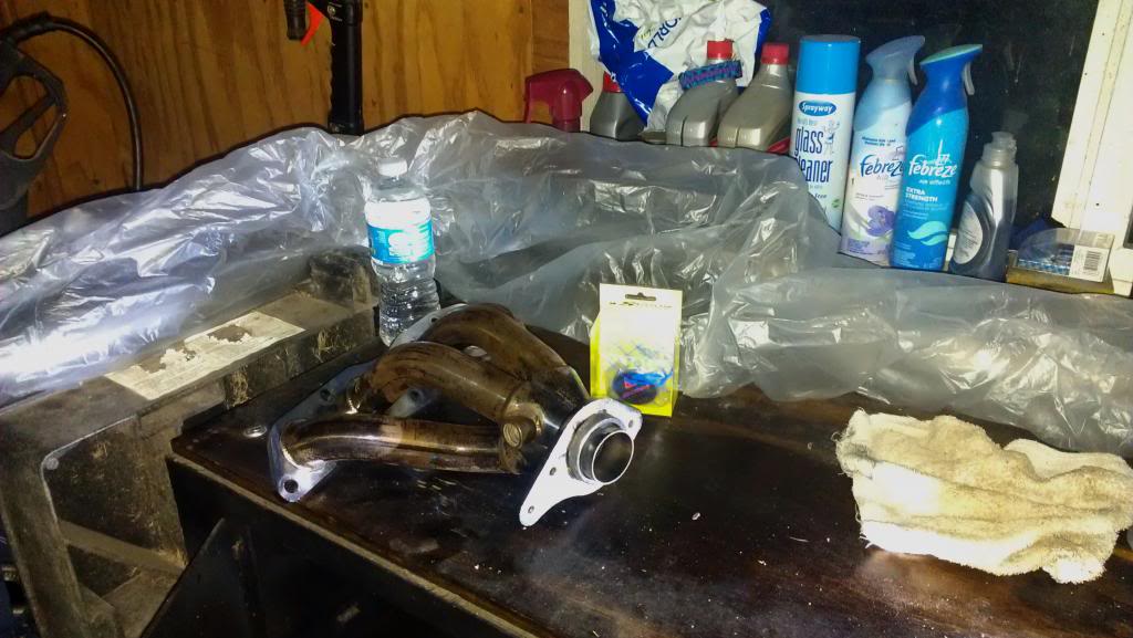

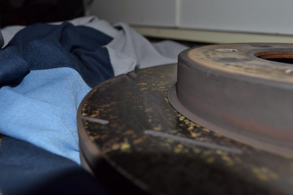

During brake line replacement I noticed that the EBC front rotors showing quite a bit of wear and actually had a nice lip on the inner and outer sections of the rotors. This seems like its a result of running these aggressive Carbotech AX6 pads. Rather than turn them like most people would do, I went ahead ordered some StopTech Cryo-treated slotted rotors. Hopefully these will hold up well against the AX6s.
Fast forward to today, ran the Fit in another autocross event. Very fun like usual despite running my daily tires which are all seasons this round. I do need to experiment with rear suspension setups a bit. I'm not to fond of how the rear end just KICKS out so abruptly during higher speed constant radius corners. With that said, I picked up some EZ shims to align my rear axle from GROC80 (thanks a bunch dudski!!! ^.^) and will have to play with those a bit.
Still waiting on exhaust components... Currently debating on doing a few simple bolt ons in terms of intake, header, and exhaust. In addition to that, been tinkering with Flash Pro's Launch Control function. It seems that the only way you can properly use it is with an M/T. A/T's, at least mine, don't like being foot braked past 2,250 RPMs.

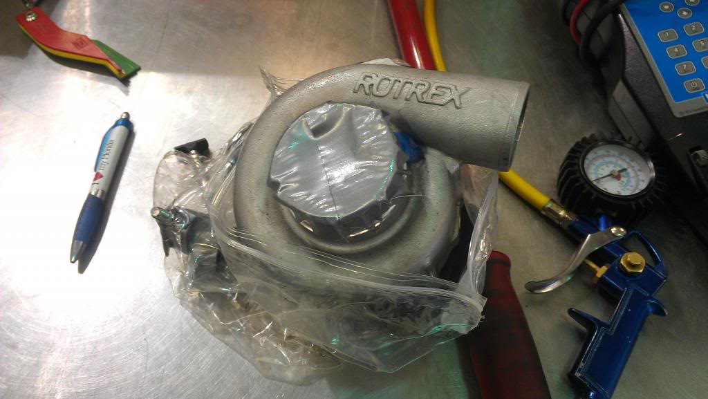

And a hint of what will be going on in 2015. I am not only trying to run with an ITR... I'll be aiming to BEAT an ITR on the autocross course... just need a bit more grunt.
