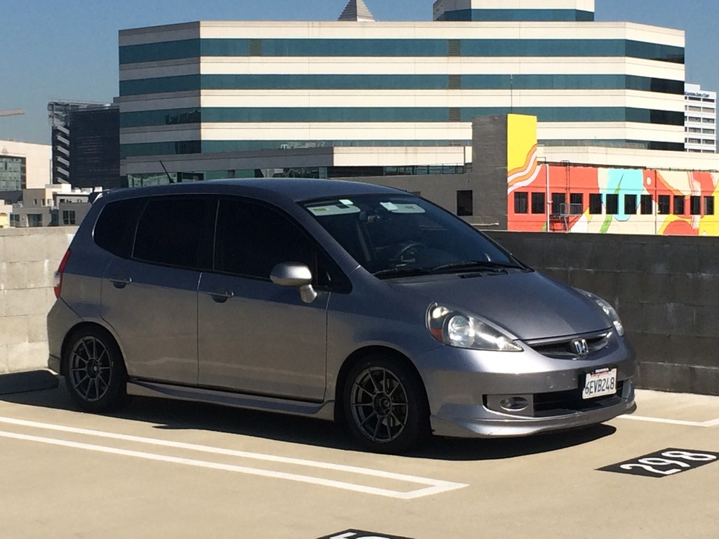

Hoping someone can help me out with my 08 fit.
I put new rotors pads and brake fluid in my fit at 138k miles when my rotors were feeling warped. Now i am at 154k miles and my rotors are feeling warped again 16k miles later. I used decent quality parts (I thought) so kind of wondering how this happens? I have not had another car do this so quickly before.
I had it on mountain roads a few times but 90% of its life is spent commuting and traffic. I carefully used a torque wrench on the lugs to make sure they are even as well.
Other details of interest are Progress springs + Rear sway, lightweight wheels (15"), koni rear shocks and KYB GR2s up front.
Should I just turn the rotors and expect to do that every 15k miles?
Thanks for any help!
