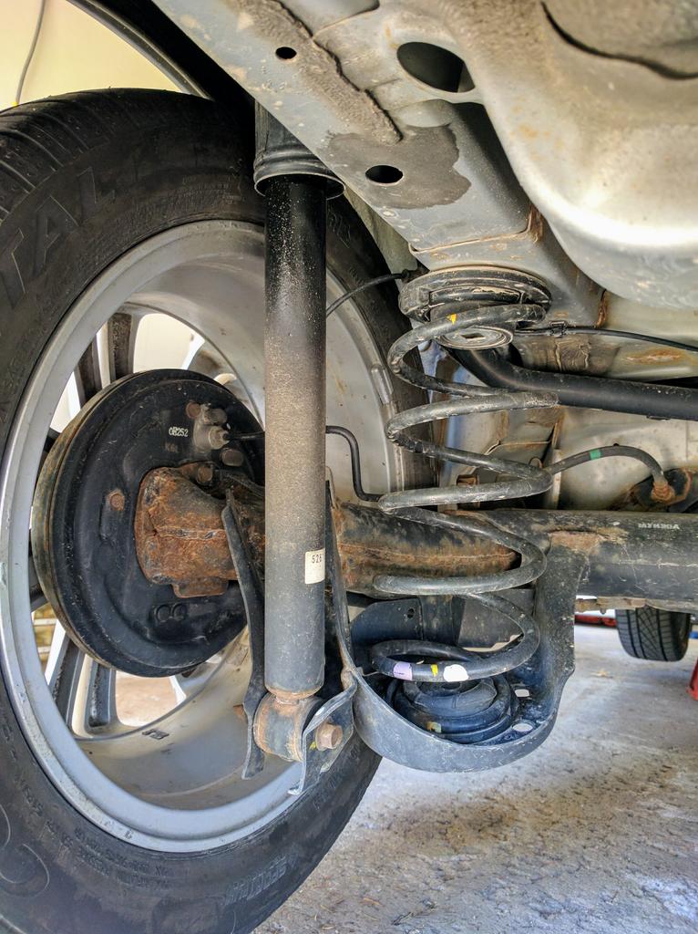

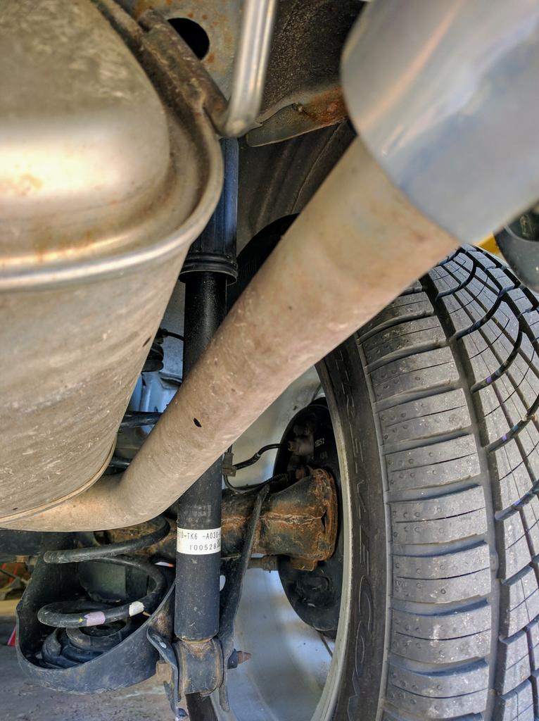

I changed the MTF on my fit yesterday and while jacking the rear end up to level the car, noticed that the rear shocks are both leaking oil:
At 104355 miles, I'm not surprised, especially with the hauling I've subjected the little Fit to:

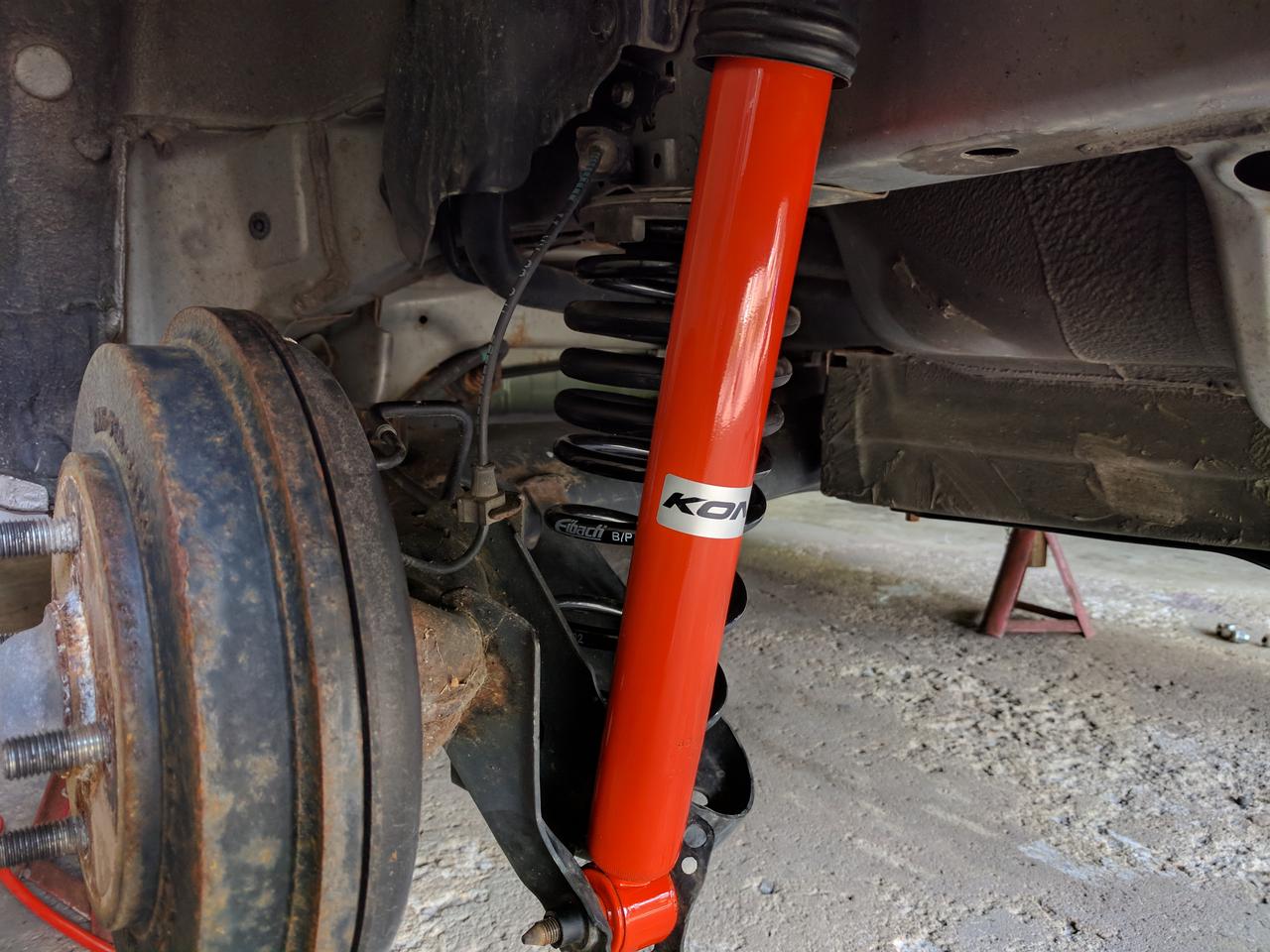

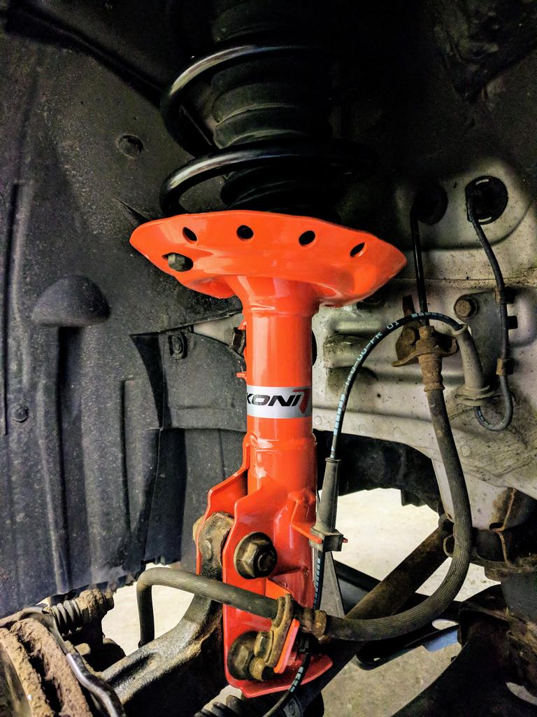

Finally installed the Konis last weekend. The car is much lower than I expected but it actually rides great (compared to my STi on coilovers anyhow), better than I expected after seeing how much lower the car is. The hardest part of the whole process was getting the bottom nut on the OE struts broken free which wasn't bad after a buddy brought his electric impact over.
Not pictured, but I ended up installing camber bolts up front, dialed in -1.5* I swapped the dust covers over from the stock rear shocks and am not getting any noise as I found some people mention on here. I did trim 15mm off the bump stops all around as directed by Eibach for the springs.

Front, minus camber bolt in top hole:
Rear:
