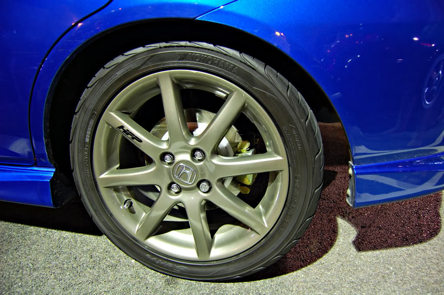

Higher qual pic with my rim on.

I've noticed quicker stopping power vs the old rubber lines. And when I hit the brakes, its more even instead of a nose dive. It's a slight improvement, but much better than stock. Looks great still.
