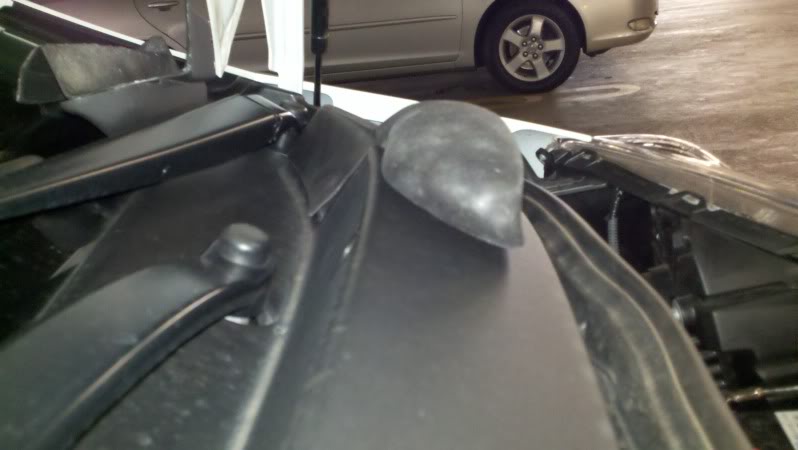

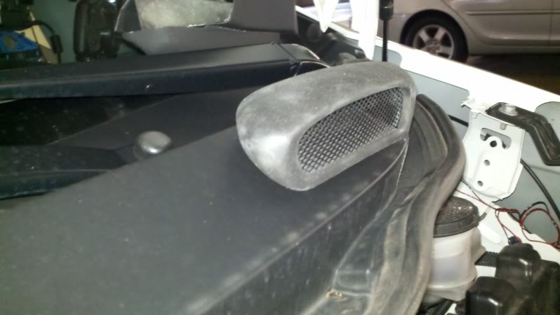

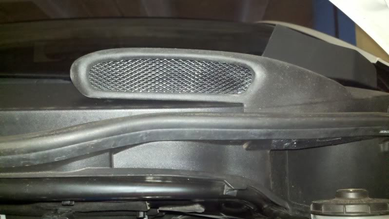

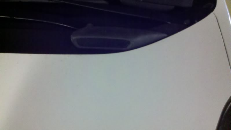

sorry for the late reply. i just got it this morning. will get better pics when sun is out and i finish work.
as far as the backing part, the fitment is great (had to hold it down cuz no tabs)
here's top view:
from behind:
and from the front:
angle view:
view from the pasenger side:

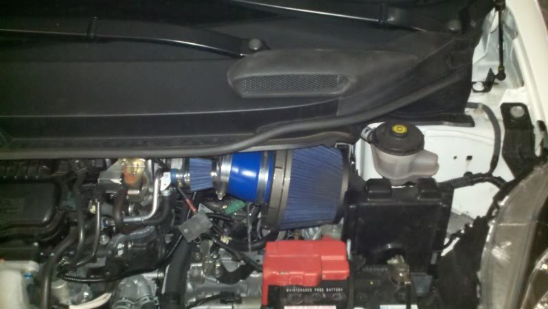

engine bay view/dirty as hell filter view:
will get more pics later on today.
Old Sep 27, 2010 | 01:55 PM
  #90
blackndecker's Avatar
Posts: 1,316
From: Minnesota
Hmmmm....first thought is that the latest pix suck, but this can be easily remedied.
Regarding the scoop...unfortunately I think this project is moving in the wrong direction. I liked the way the previous scoop was predominantly nestled within the plastic cowl. Now, it's awkwardly suspended out and over the plastic cowl with a gap, albeit small, under it. I'd prefer something simple and sleek rather than something so elaborate. I really don't want any gaps up around my cowl...that just screams "aftermarket add-on."
Again, I think the previous designs are more pleasing to look at...despite the aforementioned minor quirks.

no offense... but that thing turned into an eye sore. I would rather see a scoop that would blend and would look like it's part of the entire abs-shroud cover.
IMO... more lines would blend that all those curves.

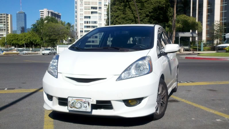

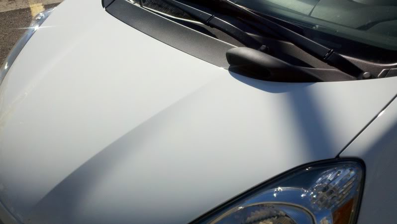

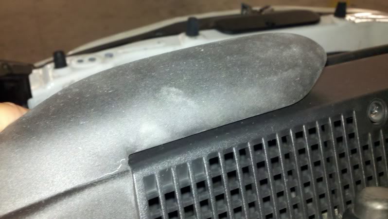

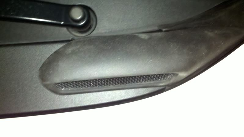

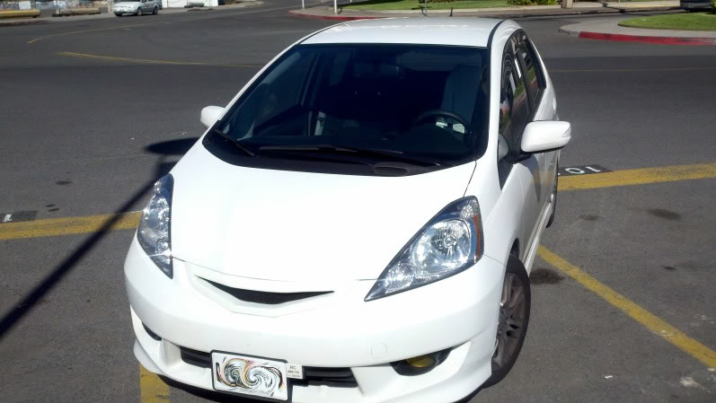

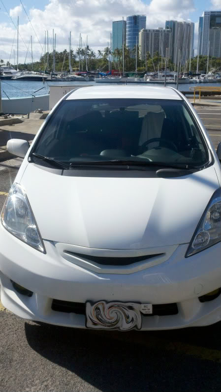

sorry...these pics "suck" too...but at least they're in the daylight.
im pretty sure jim didn't intend to have the gap there, its just he doesn't have a car to work on so he has to make adjustments per pictures i give him...but first has to be the overall idea of the scoop form. To me, this third variation is a step in the right direction. Its front facing and probably a little better in preventing rain to enter the engine ba y, especially for us diy short rams.

It looks much better in daylight with the hood down. I'd like to see some pictures taken from the passenger side with a real camera to see that awkward gap/forward profile.
Is this a cell phone camera? Do you have a real camera? No offense, but I really can't make out any detail from these images...if you're gonna post up images so we can offer input on the design then you should at least use a real camera. Just sayin...

Honestly, I think that looks really cool. Much better on the visual design. Yes, it looks "trick" but at the same time, it also looks like a fancy highly engineered scoop, like something you might find made out of carbon fiber in japan that people spend $600 on.
As long as it's sturdy, and won't break off when I try and insert a towel underneath it when drying the car, then I might get one. I think functionally, this might even work better than something closer to the opening due the increased volume of air entering the scoop and then being diverted out the opening towards the driver's side where the intake is rather than shooting it straight down.
edit: Upon second though, I'm no engineer and can't really tell if one design is superior to another. It would seem that the larger the volume of the scoop before it enters the engine bay would have to do with how much pressure can be created though.

Maybe a thin rubber gasket under the scoop would eliminate the gap and provide cushion to prevent cracking/squeaking

i really don't think the gap is suppose to be there. correct me if im wrong rogue. I think he's trying to get the overall design first off before taking care of the fitment issues. im sure he'd easily make adjustments to close the gap if he had a ge8 nearby to work on. right now he's going off of crappy cellphone pics.

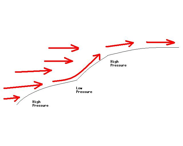

I've read this three times and it still doesn't make sense. LOL. It is well known that the rear of the hood (especially at the angle with the windshield) is a low pressure area. Leading edges (i.e. front bumper, top of windshield) are the most functional areas to place a duct or air inlet because these are high pressure areas. Obviously, this is not an option in our case (i.e. cowl scoop). The next best step is to increase the surface area of the duct/inlet in contact with the wind.
Elementary drawing:
In order to increase surface area in contact with the jet streams coming across the hood, the inlet needs to be angled forward...i.e. you want the angle between the air and the inlet to be 90 degrees, anything more or less decreases the surface area of the inlet in contact with the jet streams:
