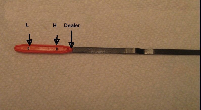

2018 FIT. Had first oil changed at a Honda dealer. Can someone with experience please comment on whether it is safe to run the car with the oil level shown in the photo at the 'Dealer' level?

Frustratingly common. Dealerships always seem to overfill.
Personally, I consider the level at your marked 'dealer' level to be safe. That's probably only about .5QT overfull.
But I'm just some guy on the internet. If you're concerned, take it back to the dealer and make them do it to your specifications.

Thanks. 100 mile round trip or I would have. If it's really only 1/2qt I agree with you. Hopefully some others will respond also.

When I go in for an oil change, I tell the service rep that when the car comes out, I want him and me to check the oil level. That is the time to complain, because they
do make some stupid errors. The level you showed is unacceptable.

Personally, I rather have under what you mark as "H" than overfill. Not knowing how close the rotating assembly is to the pan being full at the high point. Risk of overfill is the rotating assembly contacting the oil and "foaming" it. If the oil is foamed, you will have starvation issues. No oil from starvation = premature wear or worse yet spun bearing or sized junk motor

Higher then I like it but probably only over buy 1/4 to 1/2 quart. If you are concerned though take it back.

I don't see that extra half quart/liter as an issue but it really is unacceptable for them to do that. Laziness or sloppiness by the dealer's employees. I do my own oil changes and when I'm done the oil level is exactly where it's supposed to be. If I can do it than so can a supposedly well trained mechanic.

Contacted the dealer and sent the photo in this post. Service Mgr. feels a little over 1/4 qt but no more than 1/2 qt was added beyond the 3.5qts listed in the Honda manual. He is certain it is safe to drive but offered to look at it if I want to drive back to the dealership. 100 mile trip and I decided against.
I took a ruler and measured the distance between the L&H marks on the dipstick. 24/32". Distance between H and Dealer in the photo is 12/32" ASSUMING the dipstick LH marks represent 1 qt added, then the dealer added an additional 1/2qt beyond the H mark.

It's only a 3-1/2 quart system. 1/4-1/2 quart over is a significant amount. This is why I change my own oil. Besides I'm not a fan of oil coming out of the bulk tank. The one time I had to have my oil changed at the dealer I insisted on the oil in the jug from the parts department. That added something like another $15 to the cost of the oil change.

I've done all of my oil changes since new (2016). With fresh oil and bad eyesight, that dipstick level is hard to read for me. In truth the end of the dipstick gets covered because of oil that coats the inside of the dipstick tube. Sometimes I hit the mark right on, more often I'm at the top of the orange.
At 100,000 plus miles all is well.
That oil level is never a perfect level point. As we drive it always changes as when speed up or slow down or when driving hills.
If it keeps you up at night tell the dealer to drain some out. Either way I think you'll be fine...

Changing out the oil filter should bring it closer to the FULL mark . Oil filters can hold up to 20 ounces of oil . Have done this a few times with our cars after dealer overfill . Brought them a bit over FULL .

The best way to read the dipstick is to lay it horizontally on a paper towel then move it slightly. You should be able to see where the oil spot stops on the paper towel.

Excellent way to check. New oil can be invisible on the stick. Laying it on a paper towel or rag to see the witness mark is the way.
I wouldn't worry about the amount over that is being show. Yes too much oil can cause cavatation, but if that was the case you'd see many air bubbles in that oil.
