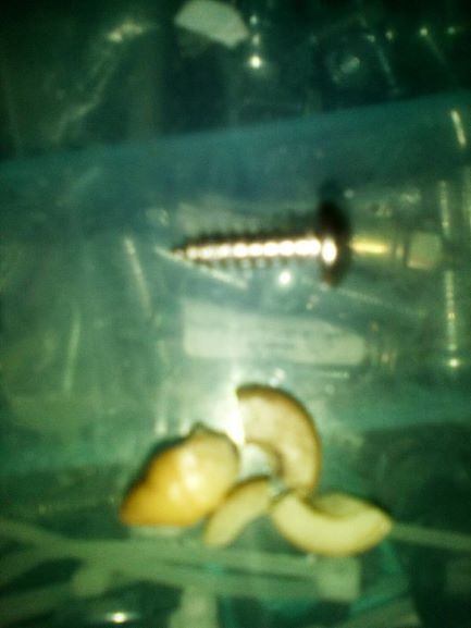

Fixed.
It turns out it was the brake switch stopper. I found the pieces sitting on the under dash cover when I removed it and replaced it with a one inch screw.
For access I removed the Under dash cover Driver's Dashboard Under Cover Removal/Installation
And also the fuse lid assembly Fuse Lid Assembly Removal/Installation
