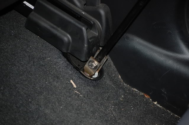

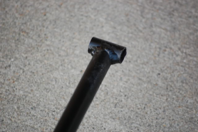

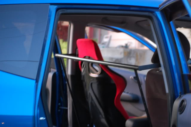

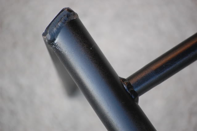

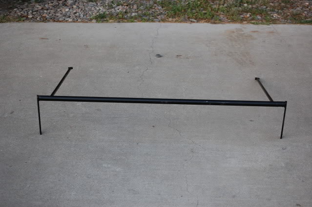

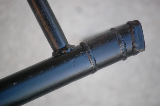

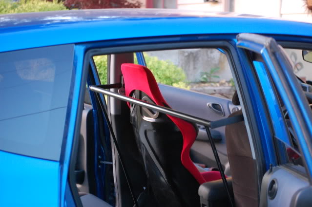

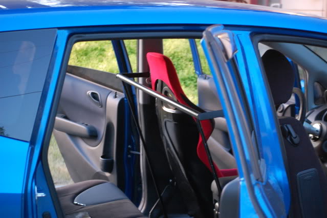

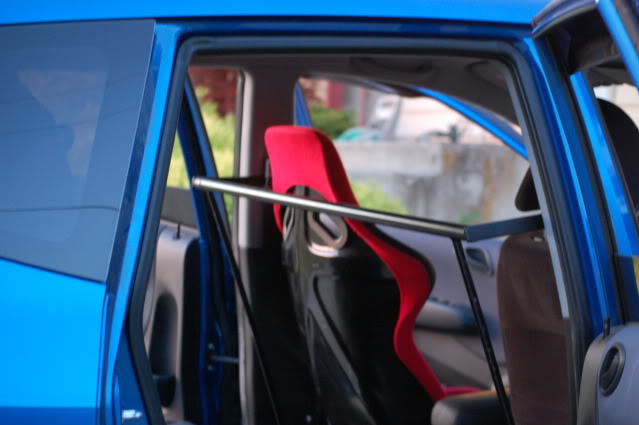

I haz harness bar

did everything bolt in ok?
looks good.

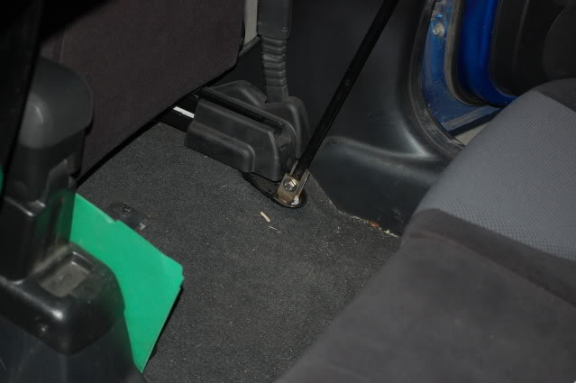

Yeah, the driver's side was obviously alittle bit of a challenge as you said since it was preloaded. I just loosened up the upper bolt to get the lower one through the bracket and once it was all the way through I tightened everything back down with a wrench.

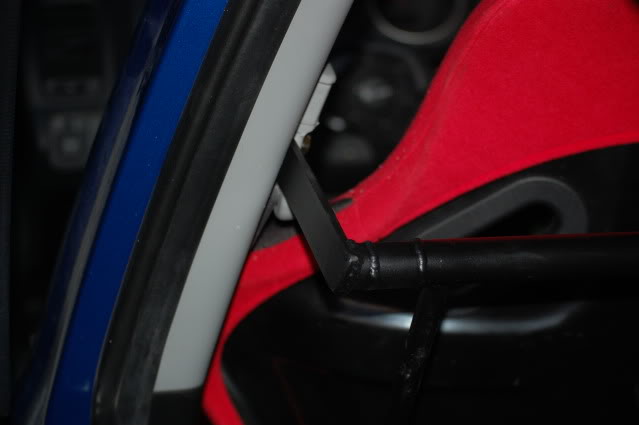

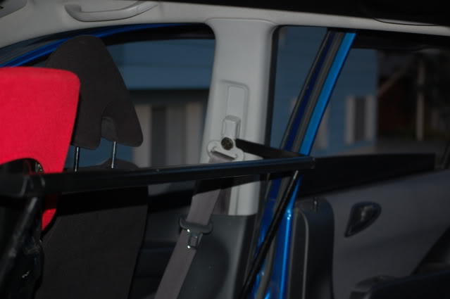

Everything fits very nice and snug. No squeeks and creeks. To fit the upper bar I sawed off the plastic piece over the bolt.
All I have left to do is to weld on 2 "U" brakets for the harness to bolt into and then an adjustable camera mount and it will be complete.
