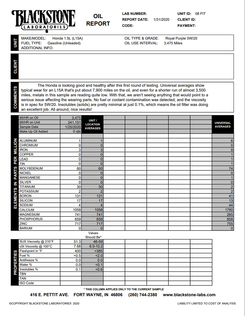

Well, I had an oil analysis done on my tapping 2008 Fit sport, and all looks fine!
Old Feb 4, 2020 | 10:33 AM
doctor J's Avatar
Posts: 1,606
From: Orange, CA, USA
What is the brand of oil filter?
valve tick or piston slap will not add wear particles, unless it's progressing.
many loud engines tend to run for long time

It's a Royal Purple filter. Yes, just some additional reassurance that it is indeed piston slap and not rod knock.
