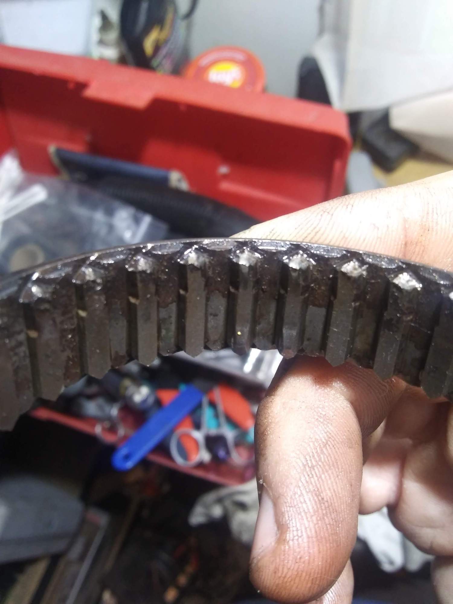

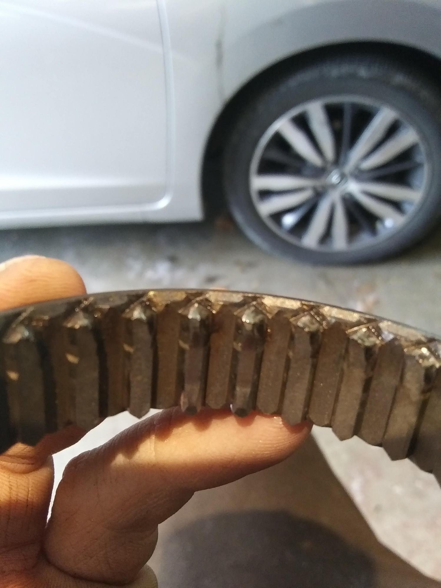

Ok I thought I updated this thread idk where the update went. I did manage to figure out where all the bolts went as well as the correct routing of all the wires and brackets etc. Its in the car now and working fine. Probably about time to crack open the transmission fill bolt and check the fluid level to see if its leaking any MTF. Anyways I kept the old transmission to fix up so I can have a spare since this has happened to me multiple times before. I have the casing apart and was trying to see if there is any wear on the 5th synchros before I took it apart. The ring is hard to move into position compared to the one on the bottom and it has some discoloration. I bet that is the problem. The bearing on the top is stuck though. I seem to remember the D series one I took apart to change a main bearing the top bearing came off accidentally. does this one need a gear puller?

ok so I did end up using a puller. I got it apart and found issues with almost all parts of 5th gear. I wonder where the best place to get parts for honda fit transmissions is. Do synchrotech make parts for the GD fit?
