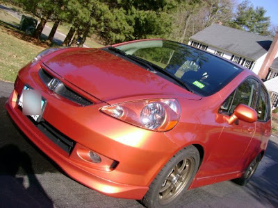

I have an 08 SSM base, I went from the stock steelies to some 15" Equip 03's. It handled great but the rears scrubbed and I lost like 5MPG. Im currently rockin old civic HX wheels with a stock sized tire, they seem to perform better than stock(they sure as hell look better) I even gained 2 MPG avg. If you want to go that route, you need a 5mm spacer up front to clear the caliper.
BTW Vtec is like turbo-lag w/ none of the boost
Could you tell me what years those wheels were produced? I'm looking for a set. And a 5mm spacer is all you needed to run them? Sweet!
I think they made them in 98, they come off a civic HX. The wheels actually have an Enkei stamp on the inside. there going on Ebay for about $400/set
