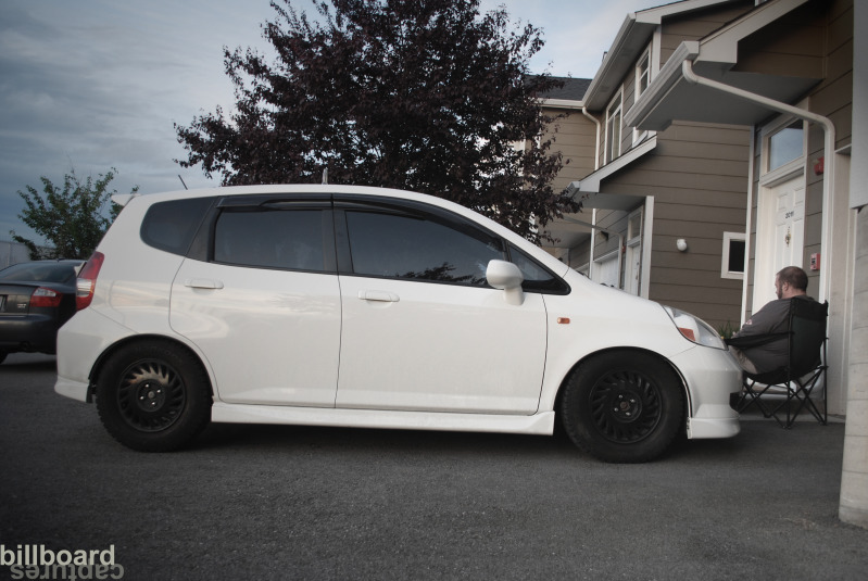

lowered the Fit, Tein S tech.
Front tires rub... waiting for new tires to arrive and new rims are on standby... but for now...

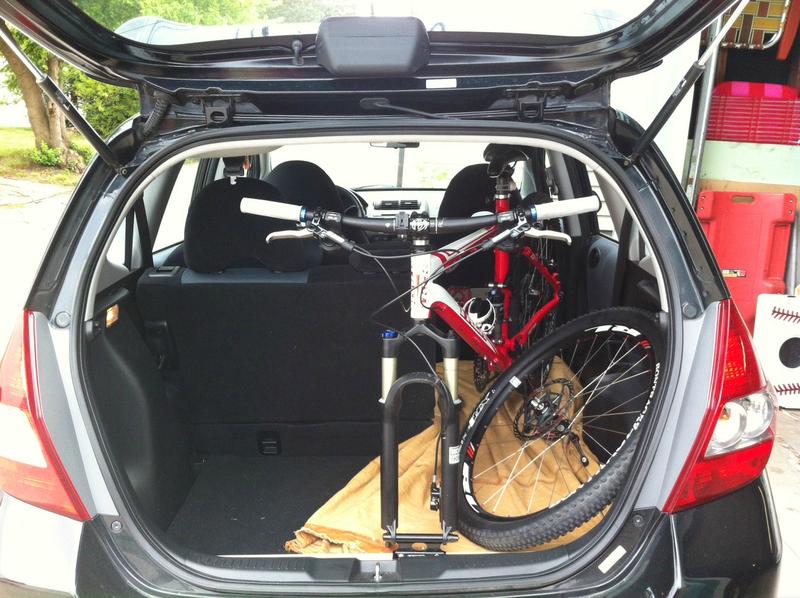

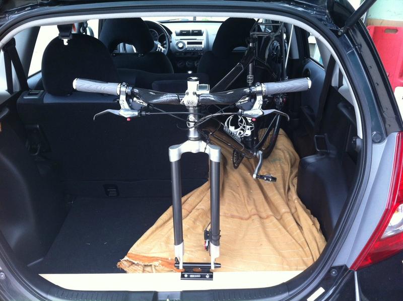

Setup the removable fork mount bike carrier. Both of my "big bikes" fit great. Can carry 3 people + bike without a fuss. Lovin it (aside form the hideous drop-cloth)

I like that what size wheels on those bikes? I have a 29er and would assume that should fit no problem

They are both 21.5" Frames.
The Gary Fisher is a Kaitai XL with 700 x 35 wheel/tires. The Trek is a Top Fuel XL with 26x2.2" wheel/tires
You can easily fit a large 29er in there with room to spare, but you may have to push the front seat up a bit to get it to fit well. The Fisher and my singlespeed (both 700c wheels) fit fine without moving the front seat up, as the skinnier tire fits perfectly in the space between the seat and the B column

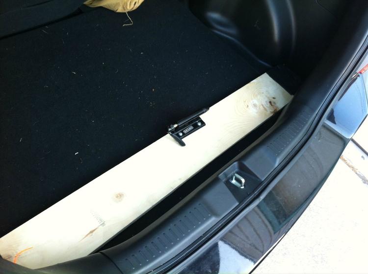

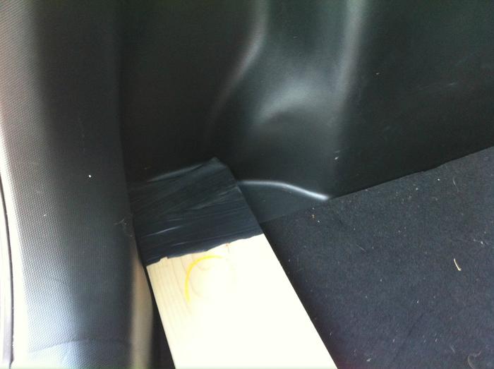

The mount is Saris Part#TR1BLK
I plan on getting another one and making mounting points so that I can haul 2 bikes with both rear seats down and not have to have the front seats up at all. Should be a piece of cake. I have the fork mount secured using machine screws and T-Nuts so it can be moved easily, and other mounting locations would be a snap to setup on the same mounting board.
Here are some more pics;
The piece of ply (1x6) is cut to a length that fits perfectly in the outcroppings of the rear trim panels. I wrapped the ends of the ply in old inner tubes to keep the panel from getting marred up from the wood, and it also makes it fit more snug. Doesn't budge a mm once a bike is in, but pulls right out when not in use.

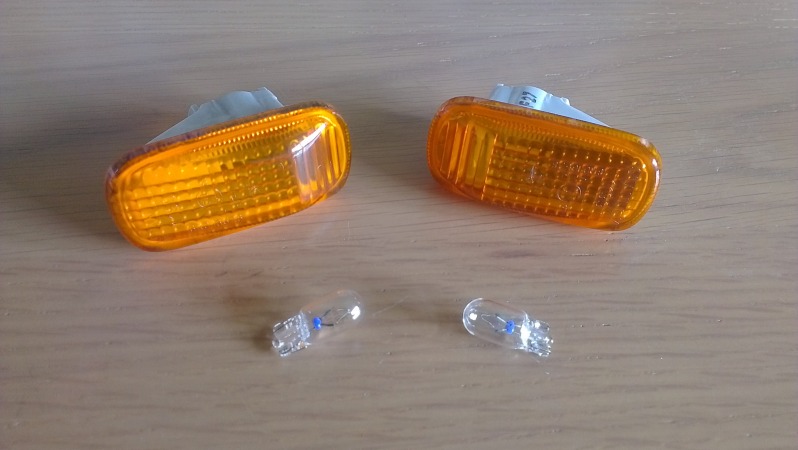

I fitted my new indicators last week.
Here are my old orange indicators....

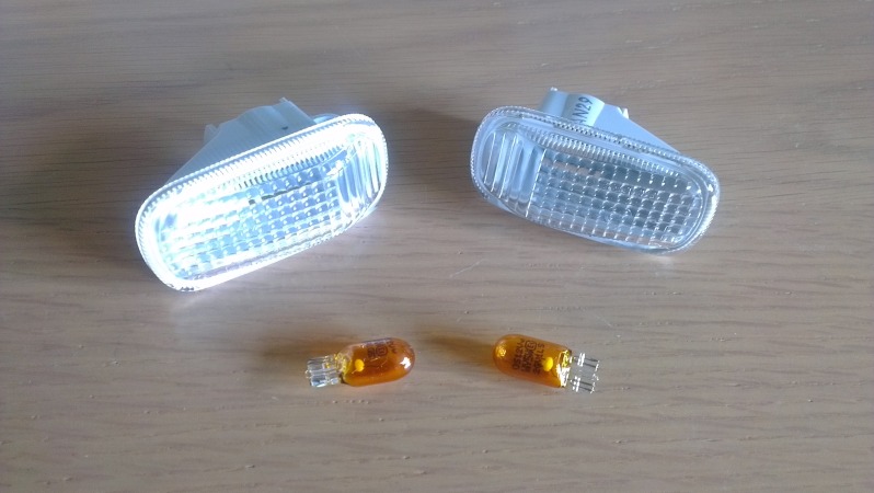

and the new "Clear" ones.

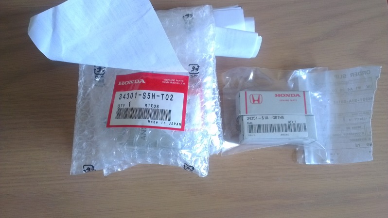

If anyone is interested in getting a set for their GD, the (UK) Honda part numbers are:
Clear indicator housing = [size=14pt]34301-S5H-T02[/size]
Orange bulbs = [size=14pt]34351-S1A-G01HE[/size]
