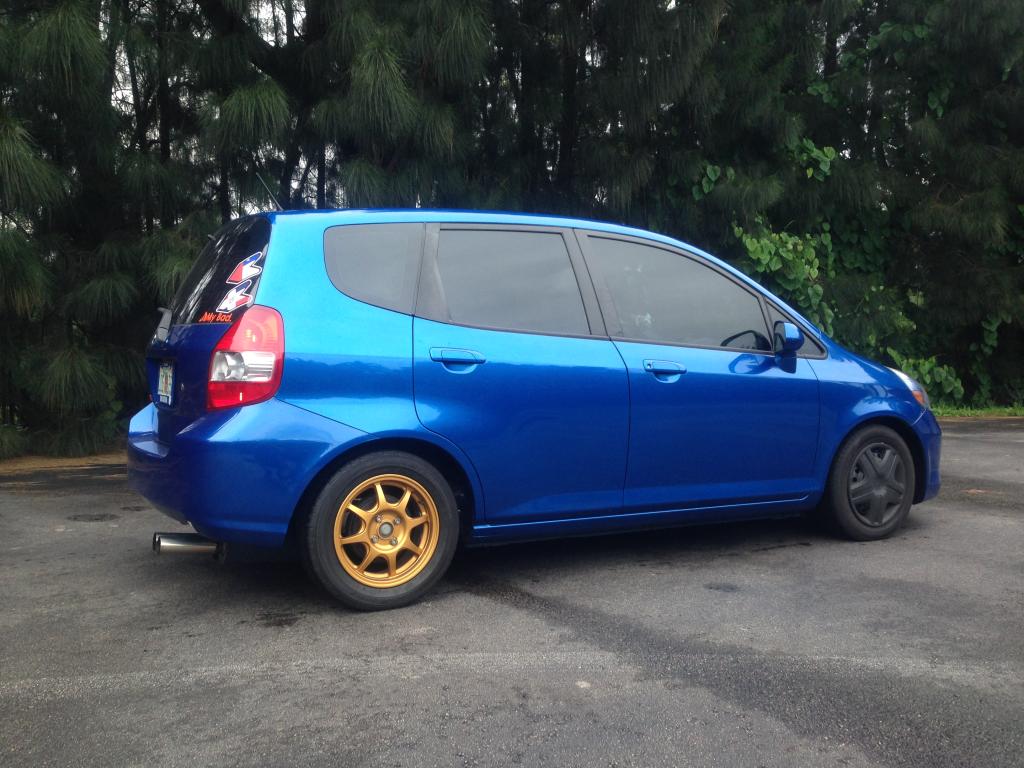

Not today, but HX wheel on rear...going to order extended studs and tuner lugs

^Tuner lugs and stock wheels are a no-no. You need standard OE style lug nuts...unless you want those wheels to separate themselves from your car.

Looks good, what are the HX wheels off of.

Use oem lugs then with extended studs?
Please explain.

96-97 civic HX coupe.

Its due to the contact surface were the lug nuts actually contact the wheel and the surface of the lug nuts them selves.
OEM Honda/Acura wheels are all ball seat designs featuring rounded contact surfaces. Most aftermarket wheels feature tapered/acorn seats, which is a flat angled contact surface.
Mixing the two in either application WILL NOT allow the lug nuts to correctly seat in place which WILL NOT allow the lug nuts to properly be torqued to spec due to inadequate surface contact between the wheel and lug nut... which could also allow it to work itself loose over time.

I believe that you can buy the lug nuts with the ball style to fit I think you just have the order the right ones to fit the extended studs. Not positive though.

Thank you guys for info I did not give any attention to or even know lol.

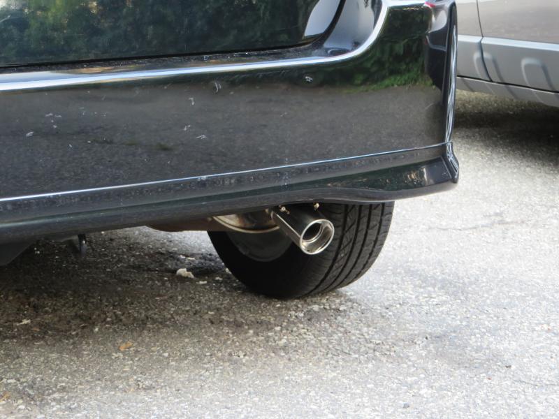

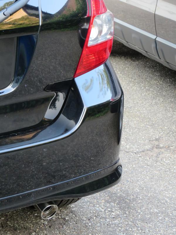

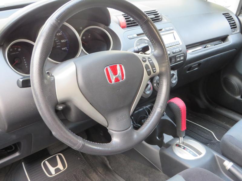

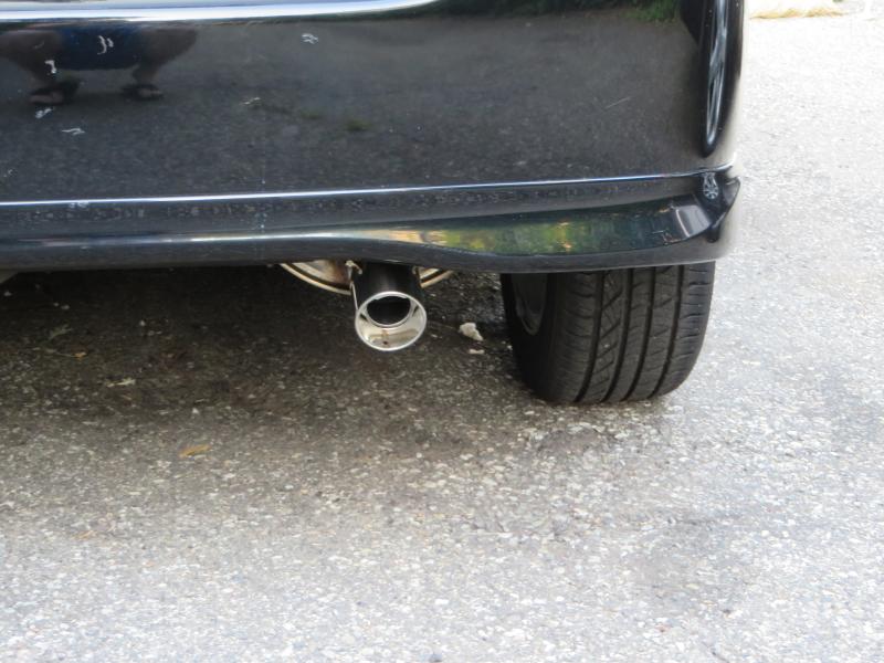

Installed the Exhaust Pipe Finisher and steering wheel emblem inserts today.
Since I'm not getting a new muffler/exhaust system anytime soon, this was the nexy best thing. Its not much of an upgrade but its way better than seeing the stock rusty muffler tip.

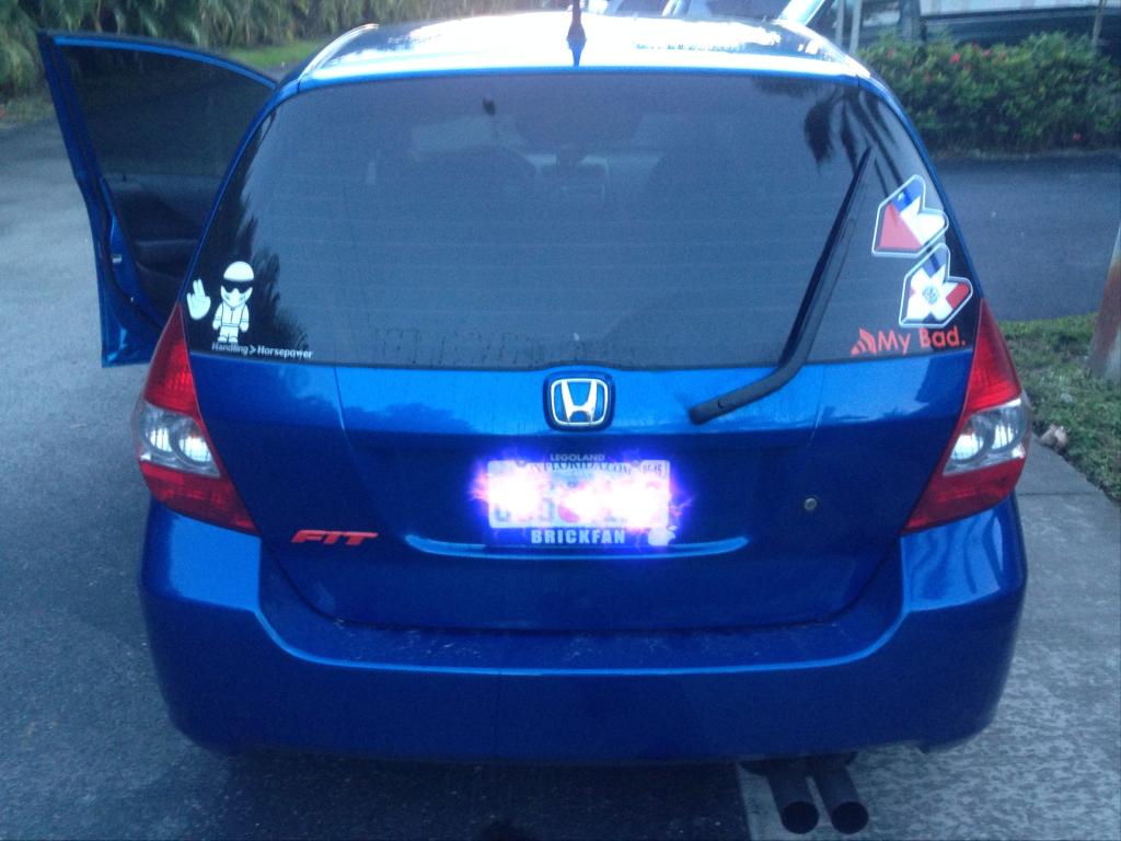

This was easy as shiz...

And ordered my ARP extended studs

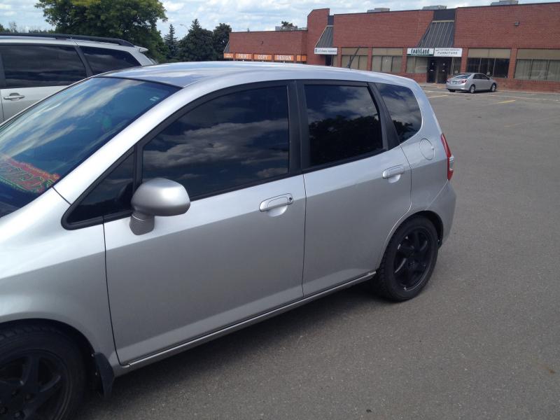

I'm at the tint place right now. Yup open on a Sunday. Getting 17 all around. Not the smoke look. The charcoal look. 2 film. Better quality then the smoke look. A little lighter than 20 even though the number is lower. Saw pics at the shop. Looks dope.
Pics to be posted in my building thread. Stay tuned. Car will be dirty though.

Yup, there is a place that sells adapters. They are like little washers that sit in the ball seat and make the wheel compatible with tapered/conical lugs. Unfortunately, shipping is like 20$ on any order so it would have to be a big box of adapters to make it worth it. Group buy???

Just got back from the shop. Windows tinted 17% all the way around with charcoal tint.
