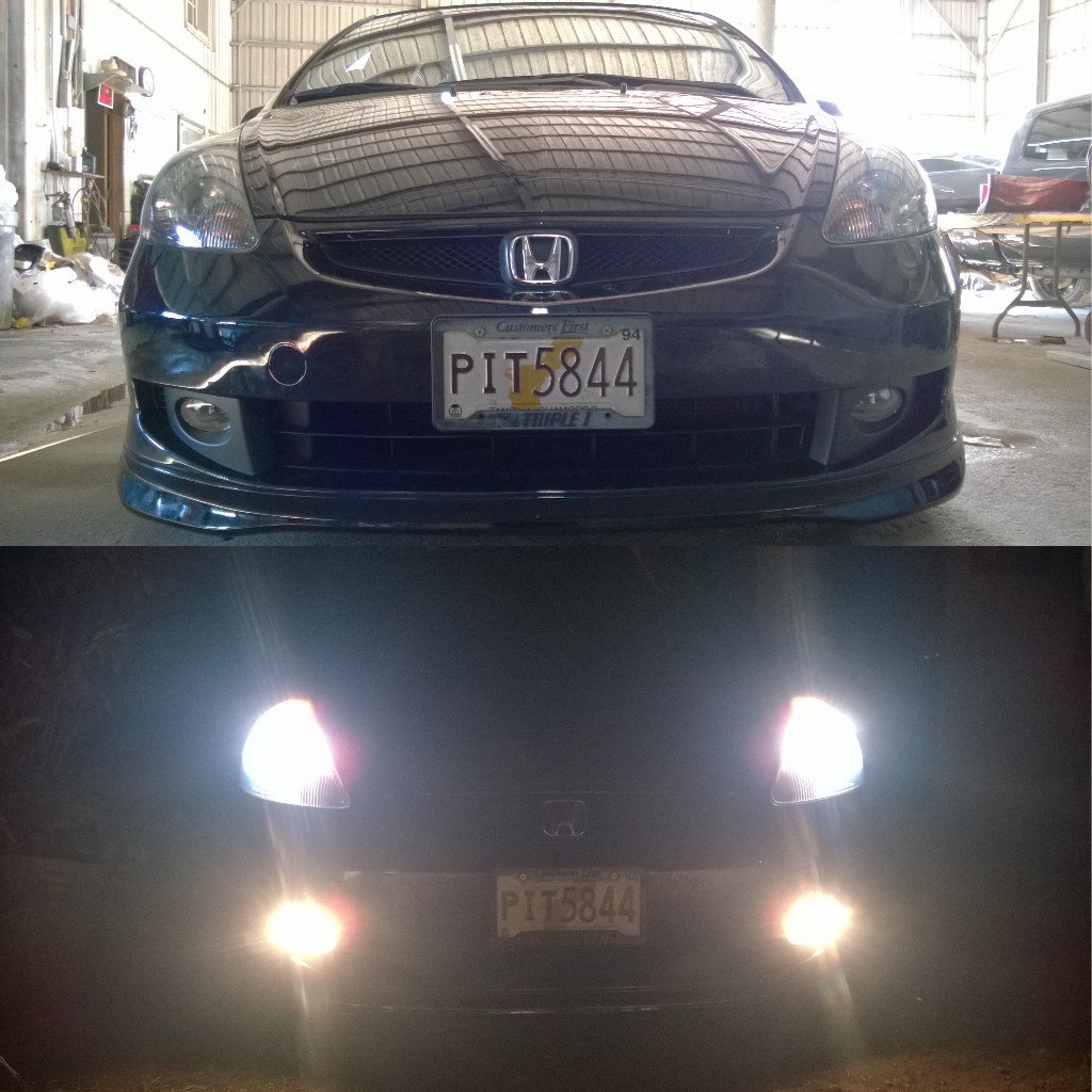

Brand New OEM fog lights
Finally finished installing my brand new OEM fog lights on my 08 Base Fit that i got for $63

The factory fog lights make the look better at night.

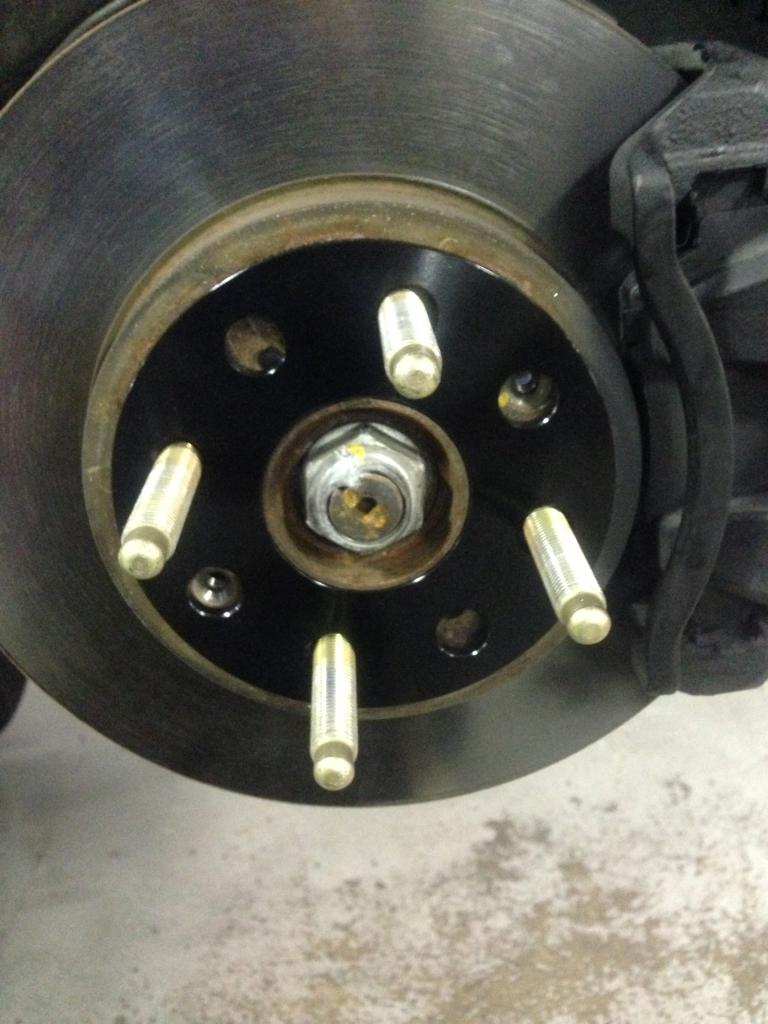

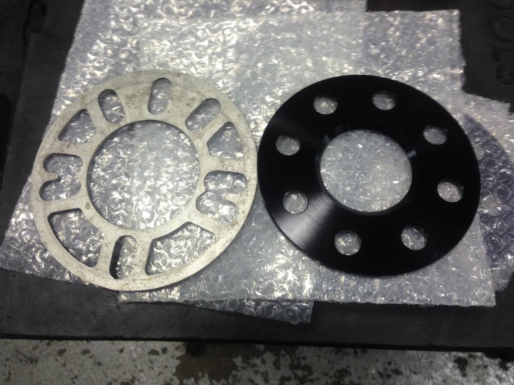

Originally Posted by Paulo107
I'll be doing extended lugs on my next setup but I wonder if they will stick out past my lug nuts. I have muteki extended lug nuts. I noticed a couple pages back you just have what looks like super short lug nuts. I'm planning on running 8mm spacers.

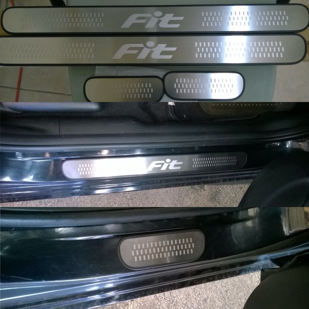

USDM Door Sills
After 3 weeks of waiting my door sills finally came in. Had to put them on the day they arrived.

I have been considering these for a while.

I was planning on getting the JDM one but then i saw my friends own. I didn't like how it looks and its plastic. So i decided to get the USDM one and i like it a lot better than the JDM door sills. Where did you get those carbon fiber trimmings on your steering wheel, looks sick.

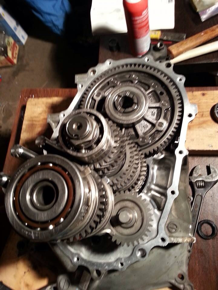

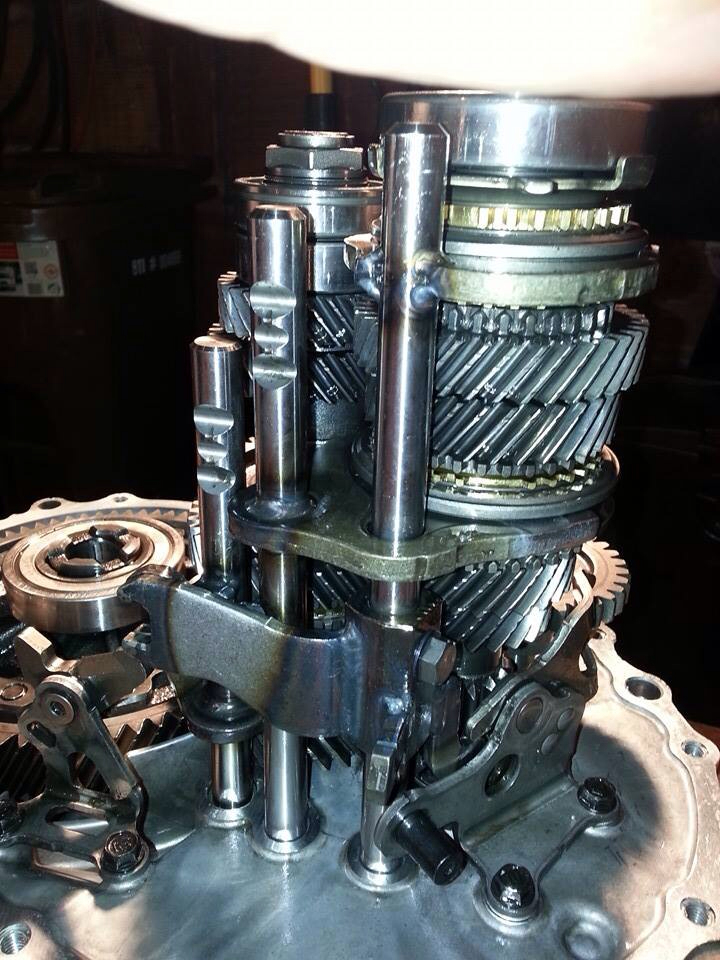

Cracked open my tranny and replaced my bad input shaft bearing and it's oil seal. Total price: about 35$ for the bearing and seal from honda.
A nice view of the shift forks:

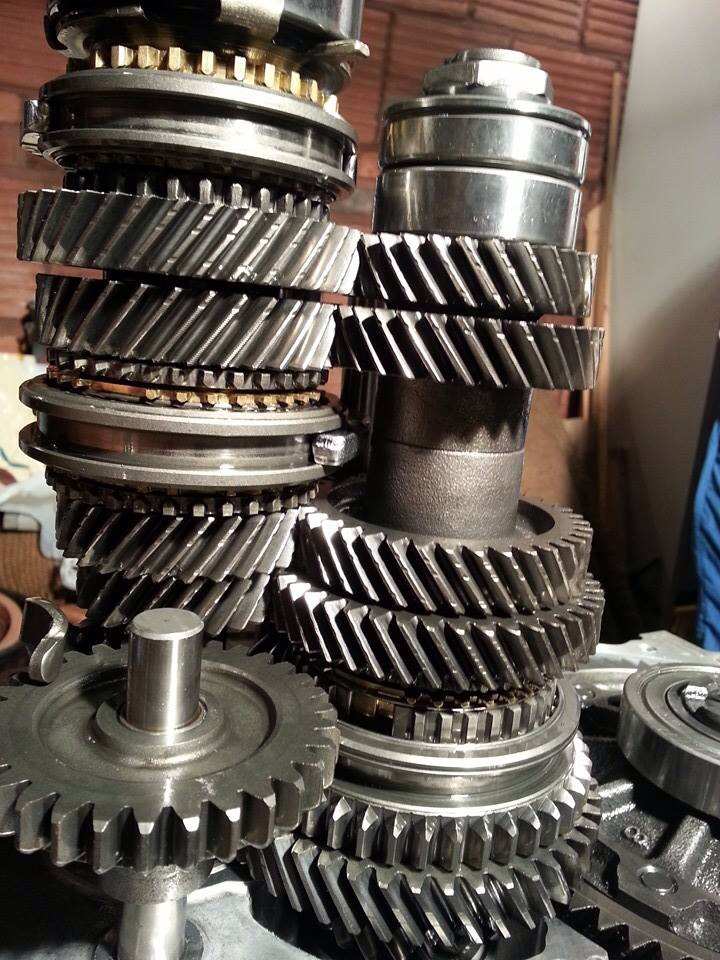

Input shaft on the left, countershaft on the right and reverse idler gear bottom center:

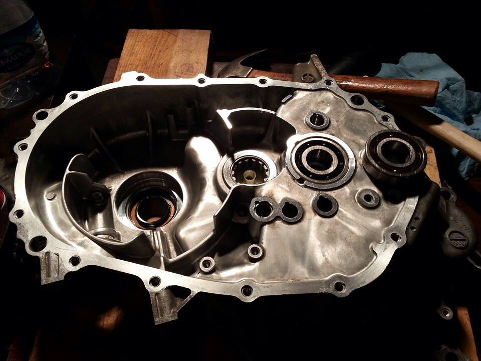

From right to left: bum bearing (removed) new input shaft bearing (installed), countershaft bearing, CV joint seal:

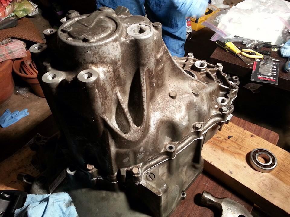

Case sealed and closed:

@MTLian
Maybe include an LSD while it's out?

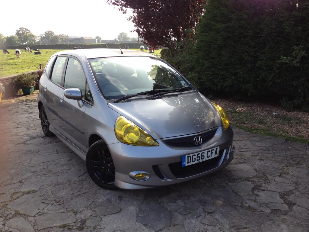

The lights were a B***H to do!

If you were in the States, it wouldn't be legal. :P
Agreed. And if you sucked at putting them on like I did then you'll have hazy bubbles and the sides will peel back like a pyramid (the best I can describe it without pictures). The haziness "should" go away in a few months and the peeling can be corrected with some water/vinegar? solution. Looks good though!
