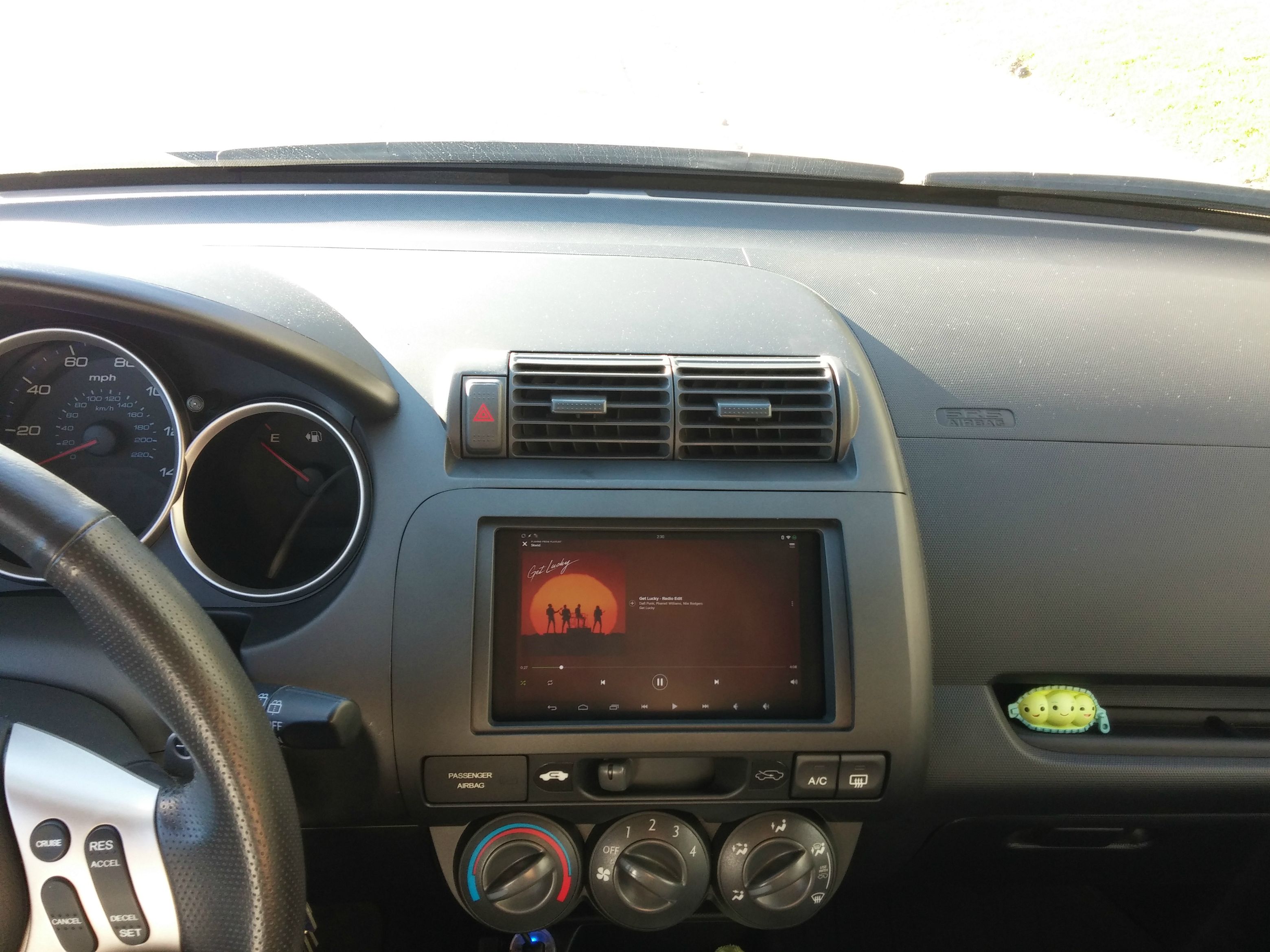

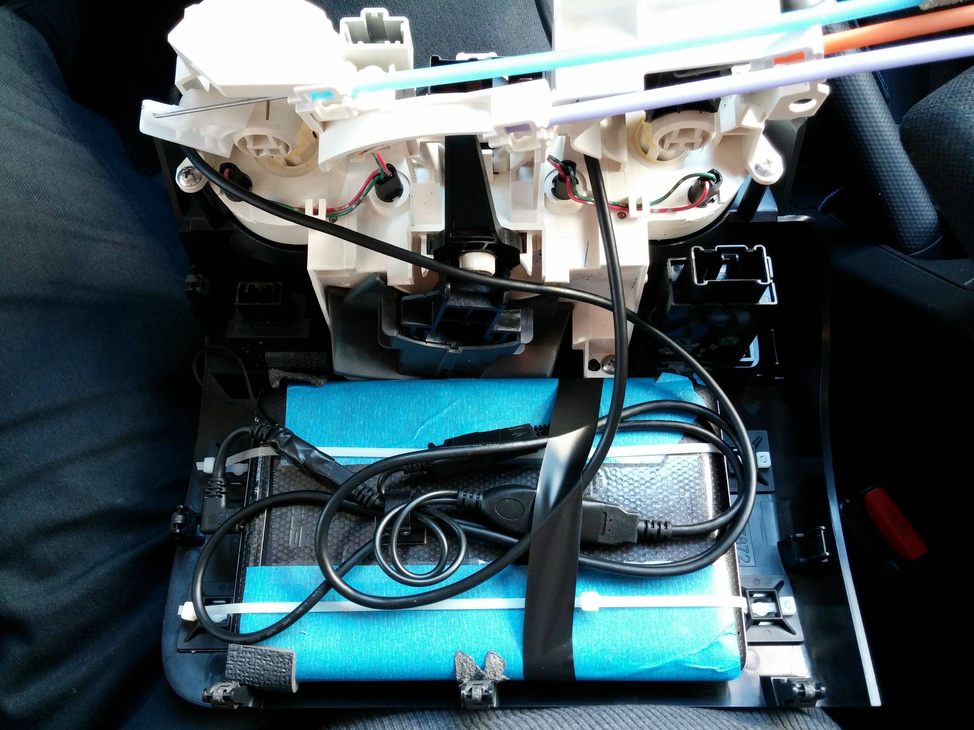

Looong time no post!
Removed stock head unit and replaced with a Nexus 7 tablet.
Very cool!! Where did the trim come from to fit the tablet into the dash?
Old Nov 25, 2014 | 06:45 PM
  #7590
mr_RogerWill's Avatar
Posts: 126
From: Toronto, Canada
thats so cool! does it replace the radio functions or is it all thru the auxillary port? deeets plzzz

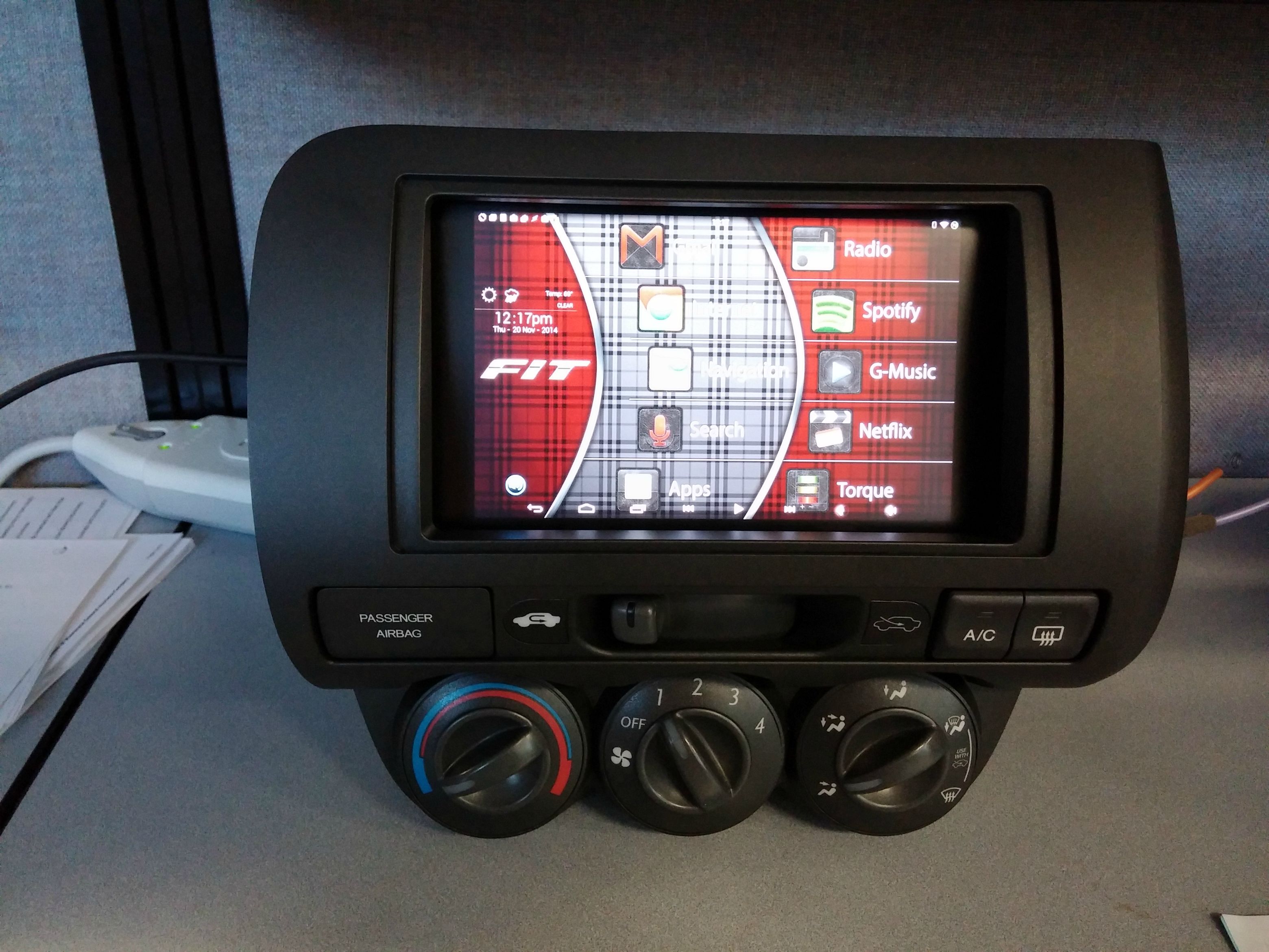

Thanks! The trim is a regular Metra with the double din section cut out. The 1st generation Nexus sits touching the top tabs that fit the trim into the dash, and the A/C recycle switch. I'm surprised it fit!
If you have an aftermarket radio you can hook up the tablet to the radio's AUX and put the deck into the glove compartment or something, that way you can still control it. But since I was still using the stock HU, I didn't want to spend extra money on a new deck. What I did was I kept the stock HU internals and just removed the "faceplate." Surprisingly it's two pieces that attach. I have to keep the faceplate handy for when the car's battery gets disconnected so I can input the radio code and permanently set the input to AUX.
So to answer your question, yes it completely replaces the radio's functions. I'm gradfathered into my Verizon phone plan so I have the tethering on each time I enter the car. The tablet connects to my hotspot and I can stream radio/Spotify/Netflix/whatever from it.
In a nutshell what you'll need:
2012 1st Gen Nexus 7
Autodroid Rom from XDA
USB OTG Cable w/ Charging
USB Extension Cable (so you can plug in a thumb drive or hub)
Right Angle Male to Female Micro USB Cable
Metra Dash Kit (I saw another user use a Scosche)
2.1A Car Charger
Your imagination
2.1A Car Charger
Your imagination
Awesome!!! Might do something along the lines of this, mostly for a screen to watch stuff on via usb.
So you keep the "faceplate" connected, and placed it in the glove? box?
Old Nov 26, 2014 | 09:46 AM
  #7594
GotFitB13's Avatar
Joined: Dec 2013
Posts: 360
From: IL
I don't have the option of Verizon tethering between my phone and nexus 7, but I do use Easytether, which can do bluetooth tethering, but I don't know if they ever updated it to support Kitkat. It worked great for jelly bean.
