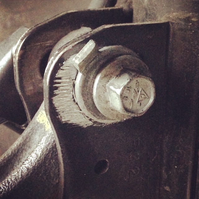

Today was the last race in San Diego (1 more next week in LA to end the 2014 season). The car didn't handle like I expected it too. Something was off and I couldn't place it. There was too much steer in the car and it didn't handle for shit.
Well after I got home I notice the right front wheel had some EXTREME camber. Turns out the eccentric bolt was not tighten correctly making my camber go back and forth. So basically i was have opposite camber (the wheel was shifting) on each turn making me have to over steer the wheel causing the car to handle like shit. It was going from +3 to -6.5 degrees by the way.
Important lesson learned though. Now I will be checking over everything before race day and at the track.
