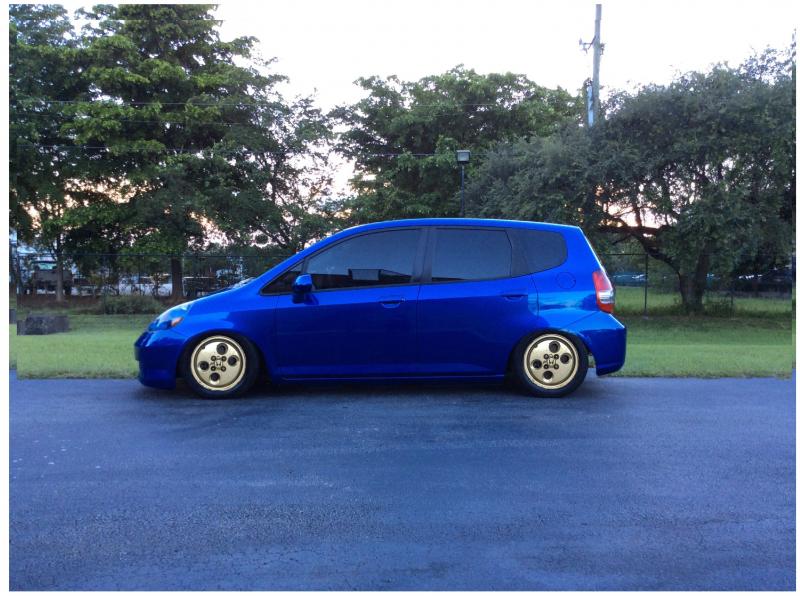

Originally Posted by Paulo107
Did you use spacers to get those to work? I took a set off of my 86 crx and the fronts rubbed on the calipers. I love the way it looks though.
5mm spacers and a bit of grinding on the caliper will work.
