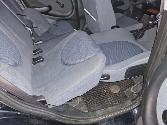

How does that actually work? I tried to do it but the front seats just bump into the rear bench and won't fit flush like this.

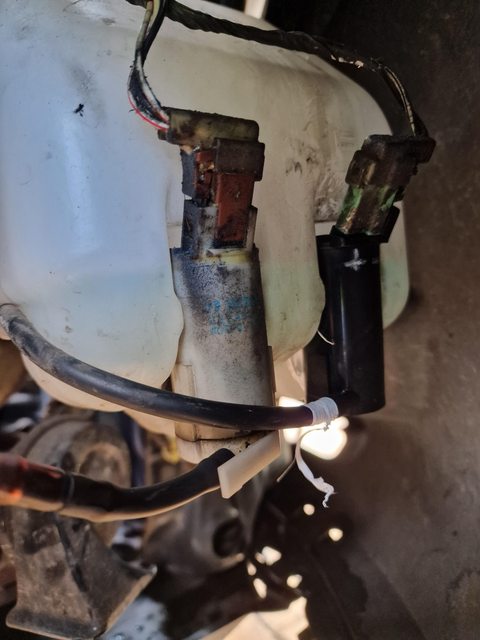

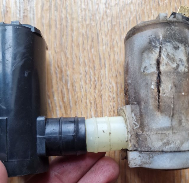

Here's what I did today:
Today looked like it would be a reasonably nice day for the first and maybe last time in weeks so I took some time to replace the windshield washer. Since June I had the front and rear washer swapped because the pump somehow exploded, so to use it I had to turn on the rear wiper and then washer, while simultaneously also turning on the front wipers. Quite a pain in the ass, but I could get away with it during the summer.
I wasn't able to find any specs on the OEM pump so had to kind of wing it. The closest one I could find is this one, intended for various Hondas including the Civic 1988-2004. Close enough, right?
https://www.aliexpress.com/item/3286...6e531802jejWkJ
There were... some slight issues.
  • The connector is flipped, with the latch on the right side. Easy to rotate the cable, except it's just barely long enough
  • The diameter is juuust too large to fit with the original or supplied grommet thing, maybe by like 1mm. It might be possible to sand it down a little, or enlarge the hole in the tank to make it fit. Or use a ton of silicone instead. Or option D, lots of teflon tape, which is what I did because it was the quickest solution. Doesn't seem to be leaking.
  • What does seem to be leaking is the tube, which might've been damaged when I was taking it off. Just tiny little drops show up from somewhere. I wrapped it in the same tape because that's all I had but I doubt it'll help much. I'll fill it up and see how much is disappearing, probably not much.
The trick is to lift the release latch on the back seat and tilt it further back to the reclining position. That gives the front seat just enough room. But apparently the Refresh Mode might not be available on Fit/Jazz models in all regions, sorry. Mine is a 2006 JDM GD1.

Hmm, I'll give it a try late next time. Googling around, it does seem that this might not work on European models, which is extremely weird. Like they just made the EU front seats 1cm taller or something, so they don't fit?
Update: Nope not even close
