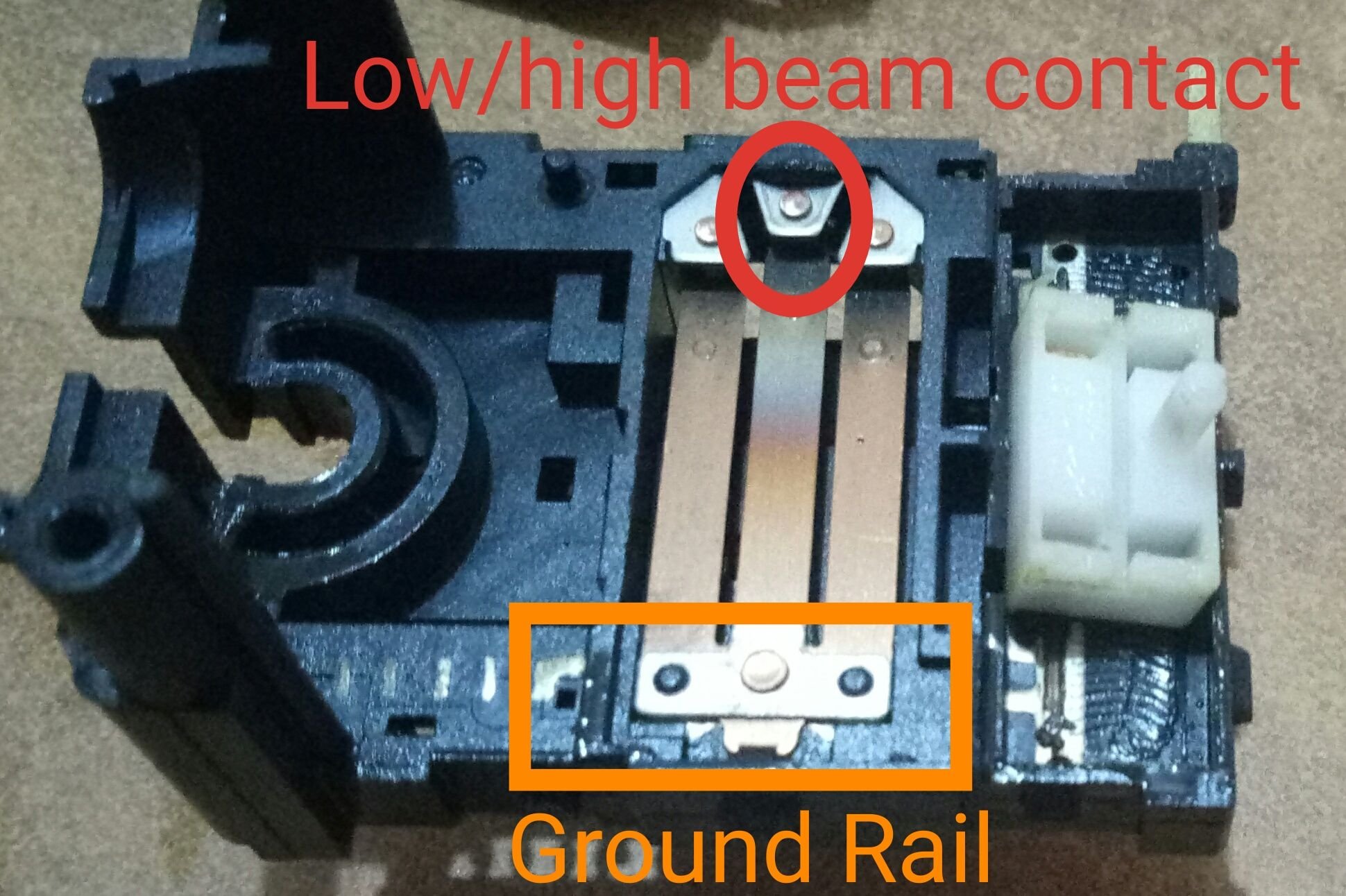

I know this is a relatively old thread but I want to share what I found in mine. The problem was corroded contact most likely due to overheating and resulted to melting of plastic support. See figure below. Notice the bumped(melted) plastic at the top of the red circle. Encircled in red is the contactor point where by default it connected to the Ground Rail. This default connection is what powers the low beam.
The reason why some owners experience a behavior where low beam tends to turn on at times when the high beam is flipped back and forth. This would happen only if the contact is not totally corroded. The failure mode in mine is gross that it couldn't be fixed by sanding the contact to expose the copper again.
My solution is to directly wire(put jumper wire on) pin 6[2](red/wht) and the ground rail 12[12](black).
Caution: when you turn the combination switch to high beam(that is by pushing forward the switch), pin 6[2] and 12[12] would not disconnect and thus ground rail takes about 20amps of current(60 watts x 2 + 55watts x 2 divided by 12v batter voltage).
I have been using with this fix for about 3 years now without issues. I just got curious the past few days because of the "caution" I mentioned above. Thinking black wire could overheat when both low beam and high beam are both ON.
