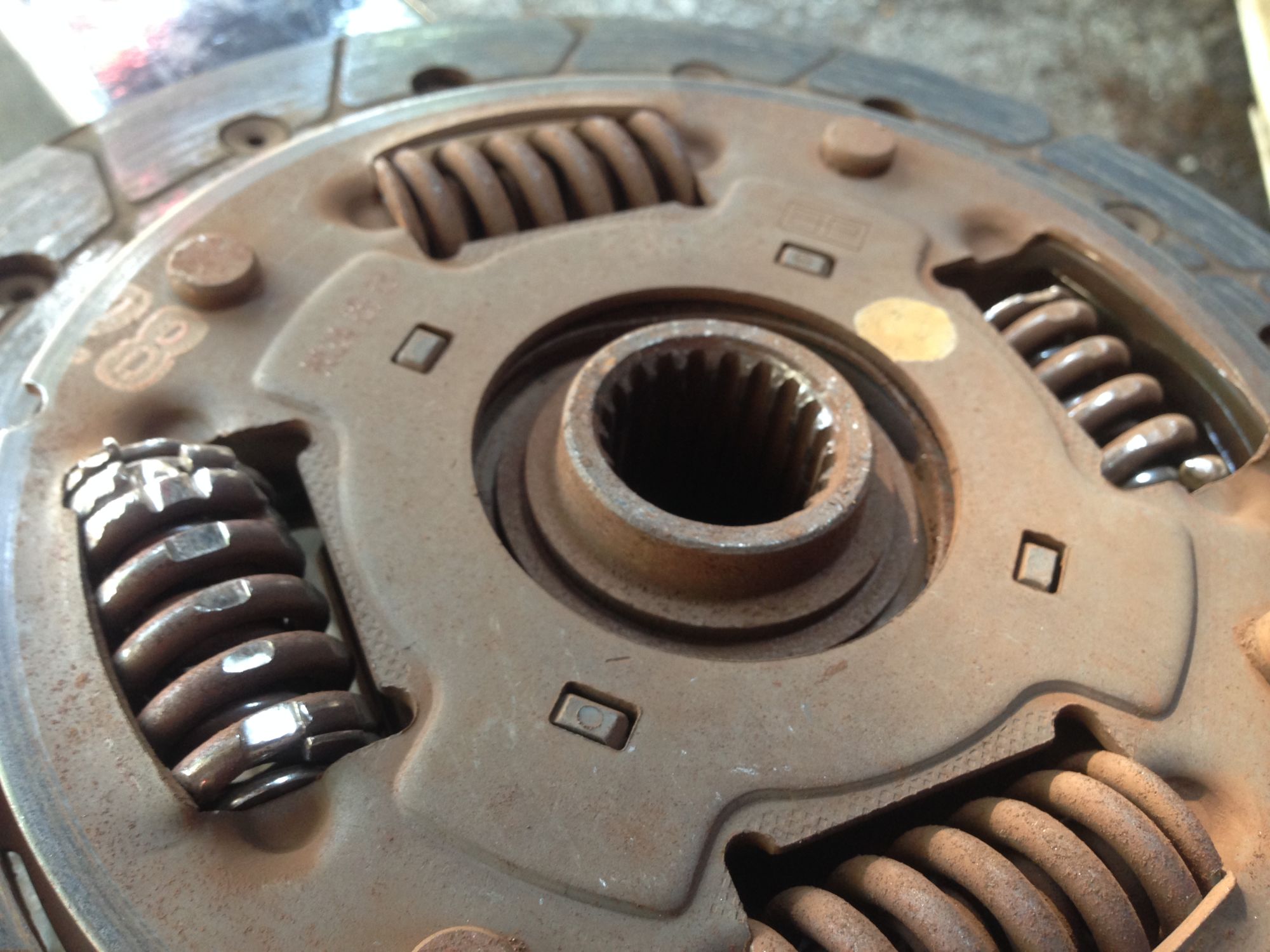

Originally Posted by dwtaylorpdx
Bad throwout bearing can cause many of the listed symptoms, but once your in there you always do the clutch..
The trans and engine are tied together, the clutch only sees the torque between the crank and input shaft, you can get shuddering if a mount goes bad because tire/axle torque overwinds the powertrain though. Rust is the biggest reason springs break in clutches, there is enough venting in the bell housing to allow water intrusion.. Salted roads make it even worse.
Here was my outcome.
Throwoff bearing was average but nothing out of the ordinary.
The springs really went out with a bang. I was in NJ when it happened. 7 hours from home!
Attached Thumbnails '07 manual suddenly very difficult to shift intermittantly-80-image_b9c93454fa80e3f2fde159f3bbf549cc582ded48.jpeg

ummm
Do you think this is common of clutches to do this or what causes this kind of failure.?

Spring failures do happen.
