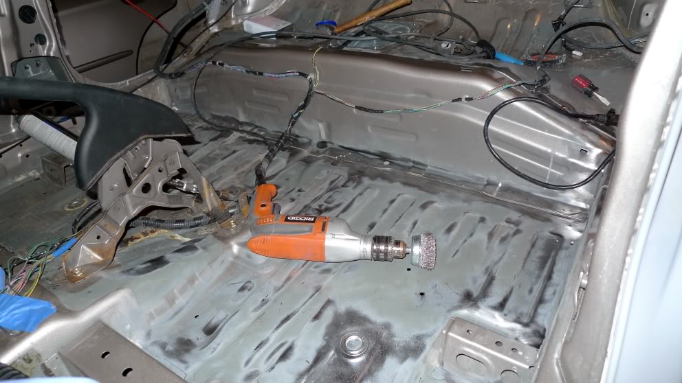

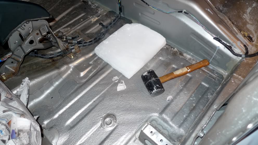

I think my weight loss is going to peak around 160-170 lbs. Getting to 200 lbs is going to require $2,000 in CF buckets...or chiseling out the sound deadening panels.
I recently chiseled these out of my 2001 civic - the panels altogether weighed b/w 40-50 lbs:
And after a lashing with the wire wheel:

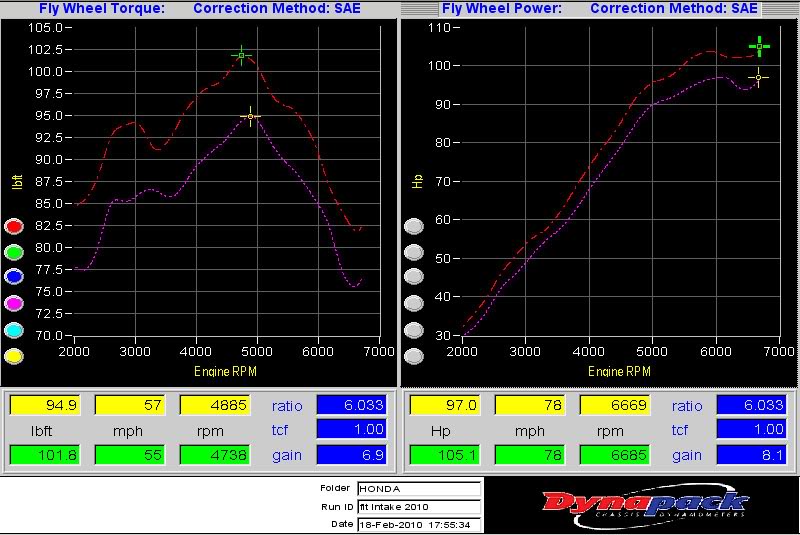

Ok here you all go I didnt know this thread was created. Anyhow here is the dyno result when we got our final version. The dyno is OEM vs WR Header both of which are going through the stock cat back exhaust system. We do not have a check engine light because of our CEL Eliminator.

Thanks for the dyno charts....those TQ gains almost seem too good to be true. Especially considering virtually every aftermarket exhaust available for the Fit causes an initial TQ and HP loss below 3500-4000 RPM. Someone please correct me if I'm wrong.
Question, what other mods were on the Fit when you dynoed?

Just the SRI

Could you give a bit more info on the dyno? Was the first run also done with the SRI? Is that bhp or whp? (it says flywheel but that seems low for bhp). Thanks!

both had the SRI on for the dyno and this is correct whp
