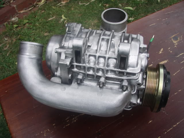

I think what really impresses me about this kit is that they actually made a custom manifold for it. Prior to this if anyone ever told me someone was making a roots kit, I would have expected them to just adapt the roots output to a charge pipe and then plumb that up to the stock manifold. Something like this:
So needless to say I do think it's really cool that they did make a direct bolt on manifold for it. Then again with the charge pipe adapter, an IC would be an option. But god knows how one would fit the blower, adapter, stock intake manifold, and piping all under the hood.
That is a slick little blower!
What does that belong to? Tell me you are secretly stealing my idea for a twincharged Fit
You are right though, there are advantages to both, and in the case of Sprintex, they have space constraints to tend to.
Which is where that pre-compressor injector comes in handy.
You can find more info by going to the websites for AEM, Snow Performance, or Devils Own. Diesel Forums are a great place for this as well.
I have a few other resources for anyone who is interested but that will have to be done in PM because they are private and I do not have permission to publicly distribute or share just in case, but because none of us will be competing on the level with those guys we can use it on our individual street cars, or at least a variation... you'll see what I mean if/when we cross that bridge.
There is a lot of stuff that I am constantly wanting to share on these forums but I am not allowed. SilverBullet has gotten to see the "Vaults" for instance, but that is on the condition that he shares it with no one
Also Diesel guys and old school pilots know it as "Wet Compression" and you can use almost any fuel or even just plain water for it.
Diesel guys also refer to compounded turbos as "twins".. so there's that terminology to contend with.
Here's what my current meth nozzle setup looks like, I also have the IAT mounted before (upstream) so I don't spray the sensor (My MAP is plumbed post TB because I am running Speed Density):
