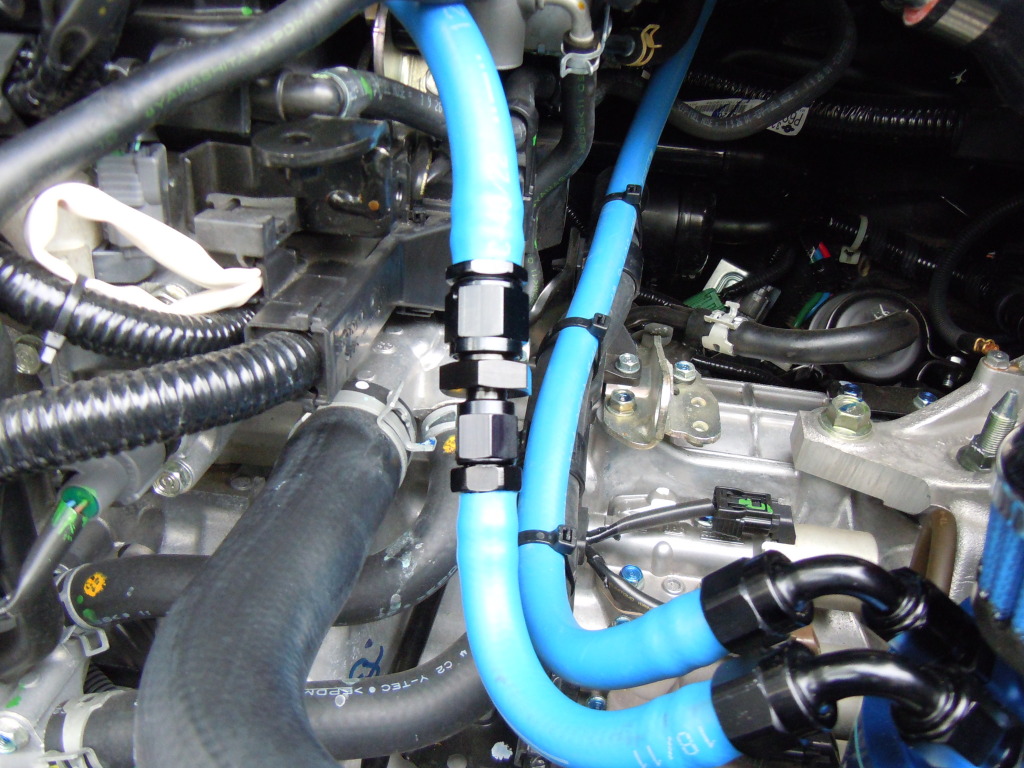

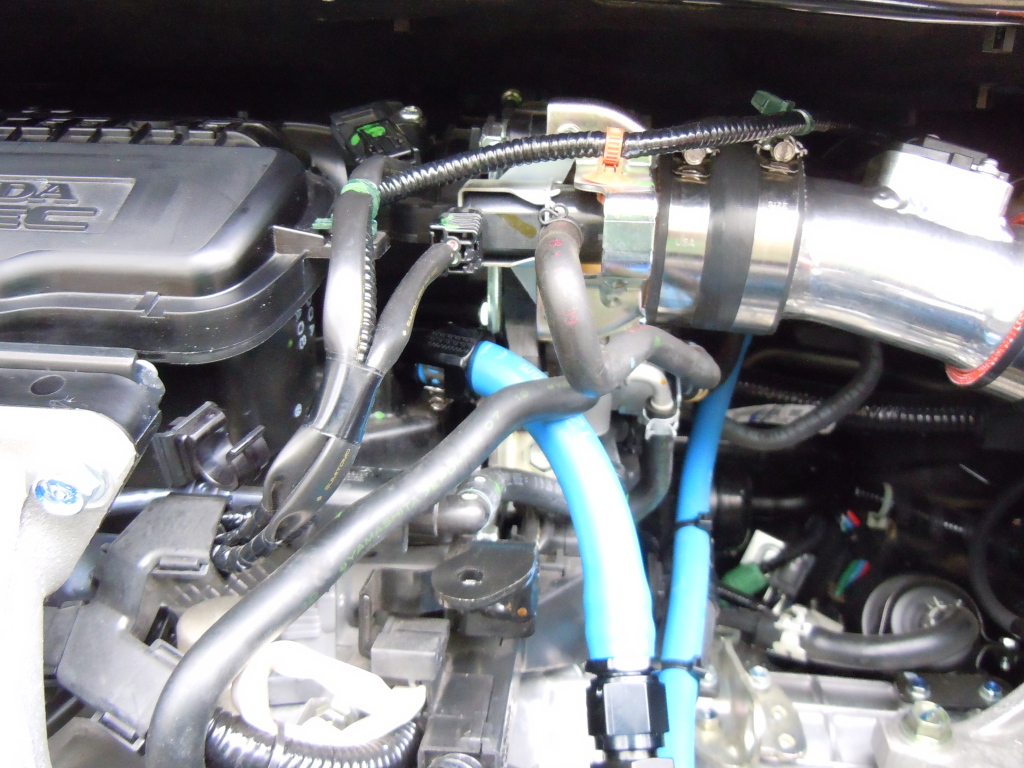

I did not like the quality of the hose that was shipped with both the intake or the oil catch can. So I chose to get some blue push lock hose in both the -8 AN and -6 AN. I also wanted to change all the fitting to Speedflow fitings and push lock. There were a few glitches I had to figure out, in order to get all the fittings right.

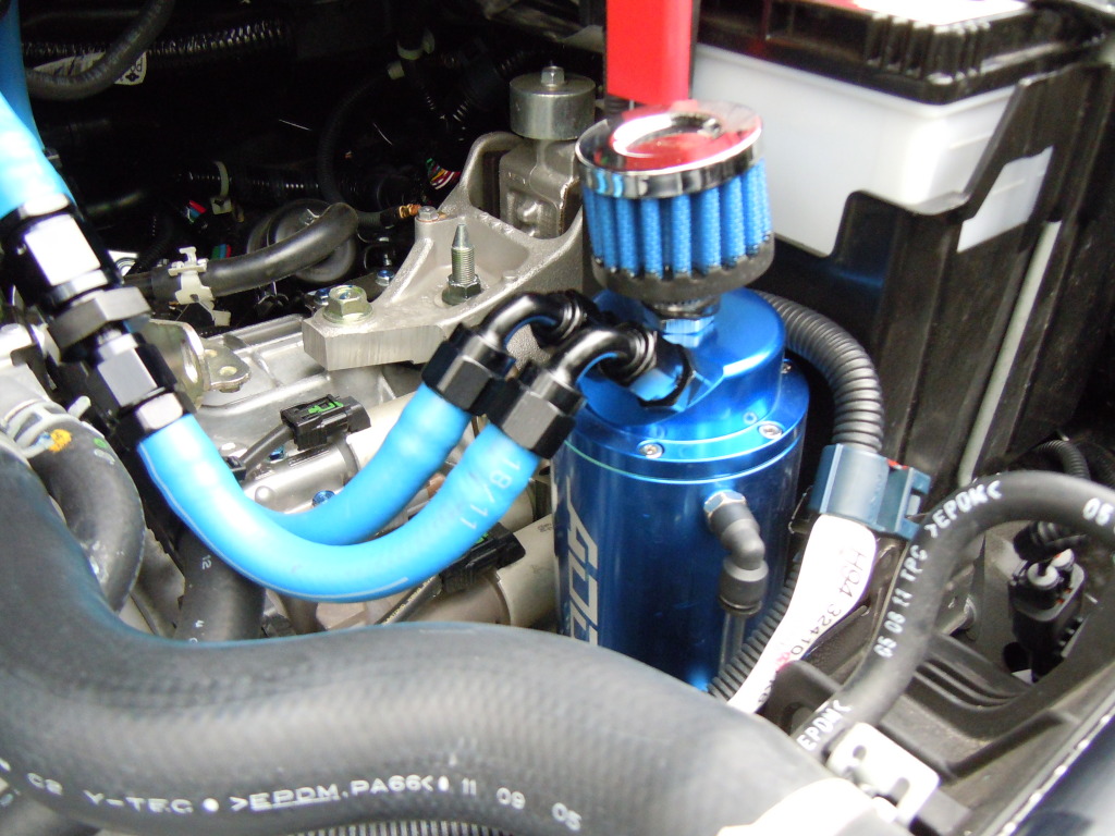

Here are a few pictures of the install and all the fittings.

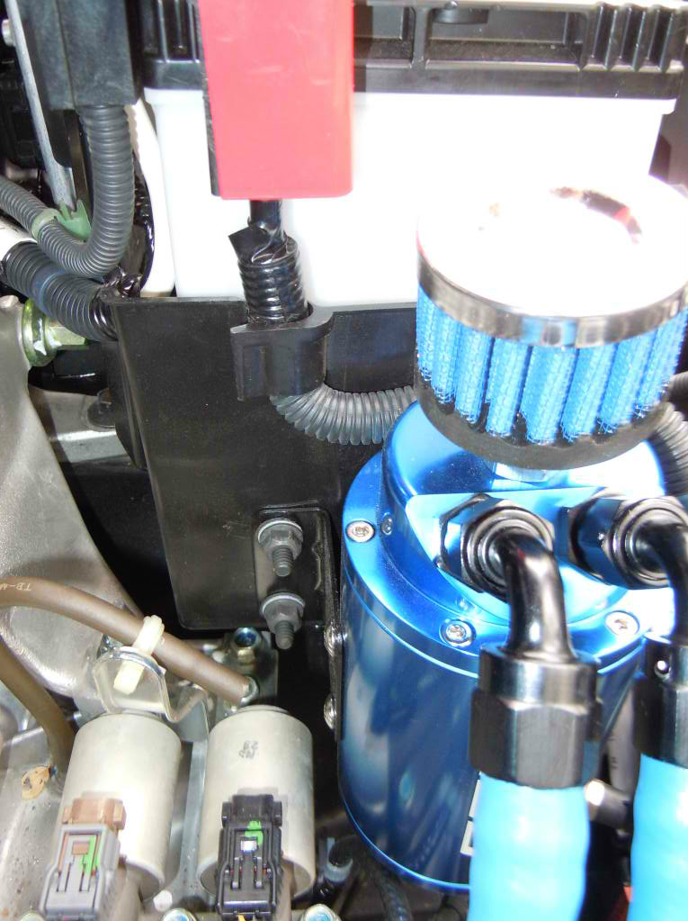

The fittings that came on the catch can were silver, but I also switched those to -6 AN fittings.

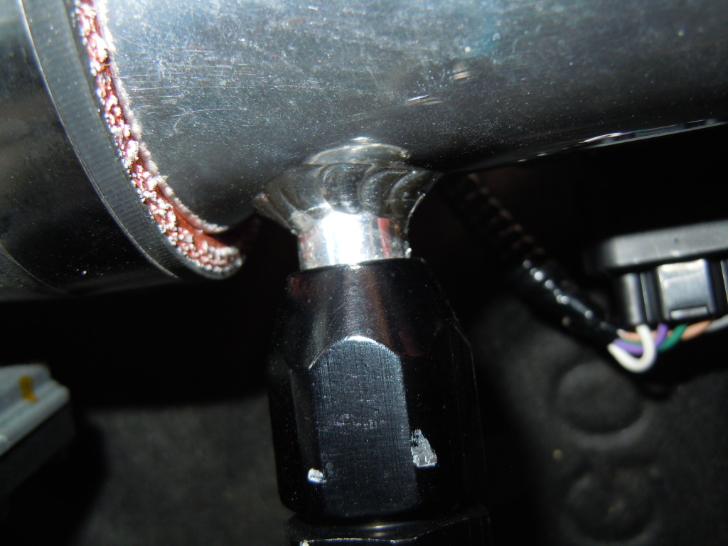

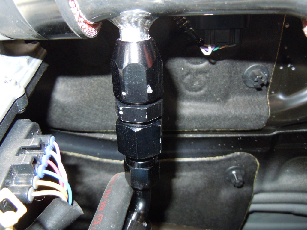

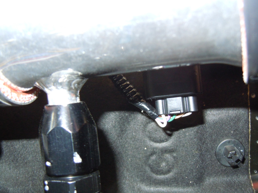

For the intake I had to grind the port down a little so I coud put the fitting on.

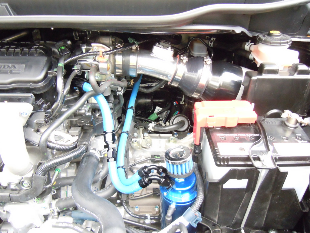

The bracket that came with the ADD oil catch can was chrome, but i dint like that, so I painted it black and attached it the the battery tray. I also went a picked up some black bolts and nuts, to try and give it an OEM feel to the install.
Over all I like the way it sounds, and that it came out looking really good in the end. I didnt really notice any horsepower gains. Besides maybe a slight pep when trying to pass someone in traffic. I do plan to switch more of the hoses out to blue pushlock hoses and black fittings, but that will be later down the road.

Any way you could take some pics of the inside of the can for me? I'm looking into the same one but can't find any info on filtering media etc...
also I'm questioning your use of a vented can in this application...typically if you're running a CC between the VC and intake you'd run a closed can so you don't suck in unmetered air through the filter, just wondering why you chose this particular can for this particular application.

Everything looks real good.. The only advantage to the catch can or oil mist separator, as us old guys called them 40+ years ago, on a N/A engine is that you can use 0W20 oil with out it being sucked into the combustion chamber... It kills your performance at high RPM by causing ignition timing advance to be pulled back.. With the PRM flowing as freely as it does you would have no problem unless the filter was real nasty if you did at all. Some guys in the past said that oil was making it's way into their intakes and it is a problem on boosted Fits.

I understand the point of a catch can, I'm just wondering why he used a vented can and still routed it back to the intake...I've seen vented and I've seen them in between the 2 ports but I've never seen a vented can that routes back to the intake (or IM on a pcv side can)

My guess is that he did it because of his desire to make it look nice by routing the hose to the intake.. It's not needed but it does look nice.

If I ever have any free time I will take some pictures of the inside of the can. Just know time until saturday. I was unaware that the can was to not be vented, I have seen them both ways and just figured that it was just due to the brands they used if it had a vented or none vented. I will try switching it to none vented and see if it changes any things. The can was real clean on the inside, prob will never have any oil go into it. It is also a brand new car still with only 10,000 miles on it. I also herd that wire scrub pads that you use to wash dish's could be thrown into the can to aid in catching the oil. All I could find were the ones that had soap built into the pad, which I would assume would be no bueno for the engine. The add can is not to bad for the price, there are def better can made from other companys like cusco, greddy, and rx(rx is actually the most efficient and best on the market from what I found. However, at 150 it was alittle outa my price range.).

You have already gone to the expense in time and money doing it the way you have, leave it as it is.. I would do mine the same way if not boosted.. An air compressor water accumulator will do the same job for anyone that has oil reaching the throttle body and lacks cash or room under the hood for something larger... The only drawback is that it would need to be drained more frequently.

Wrong side! Oil gets in the intake from the pcv by thermostat housing. Where you have it is the intake side where air goes into engine.
