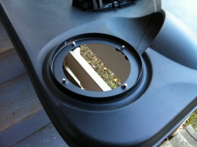

I recently replaced the plastic grills in my rear doors with metal ones from Parts Express. Looks pretty good and gains you some extra room:
Old Dec 21, 2010 | 09:49 PM
You used a Dremel tool? Got any pictures of how it look of just the hole?
