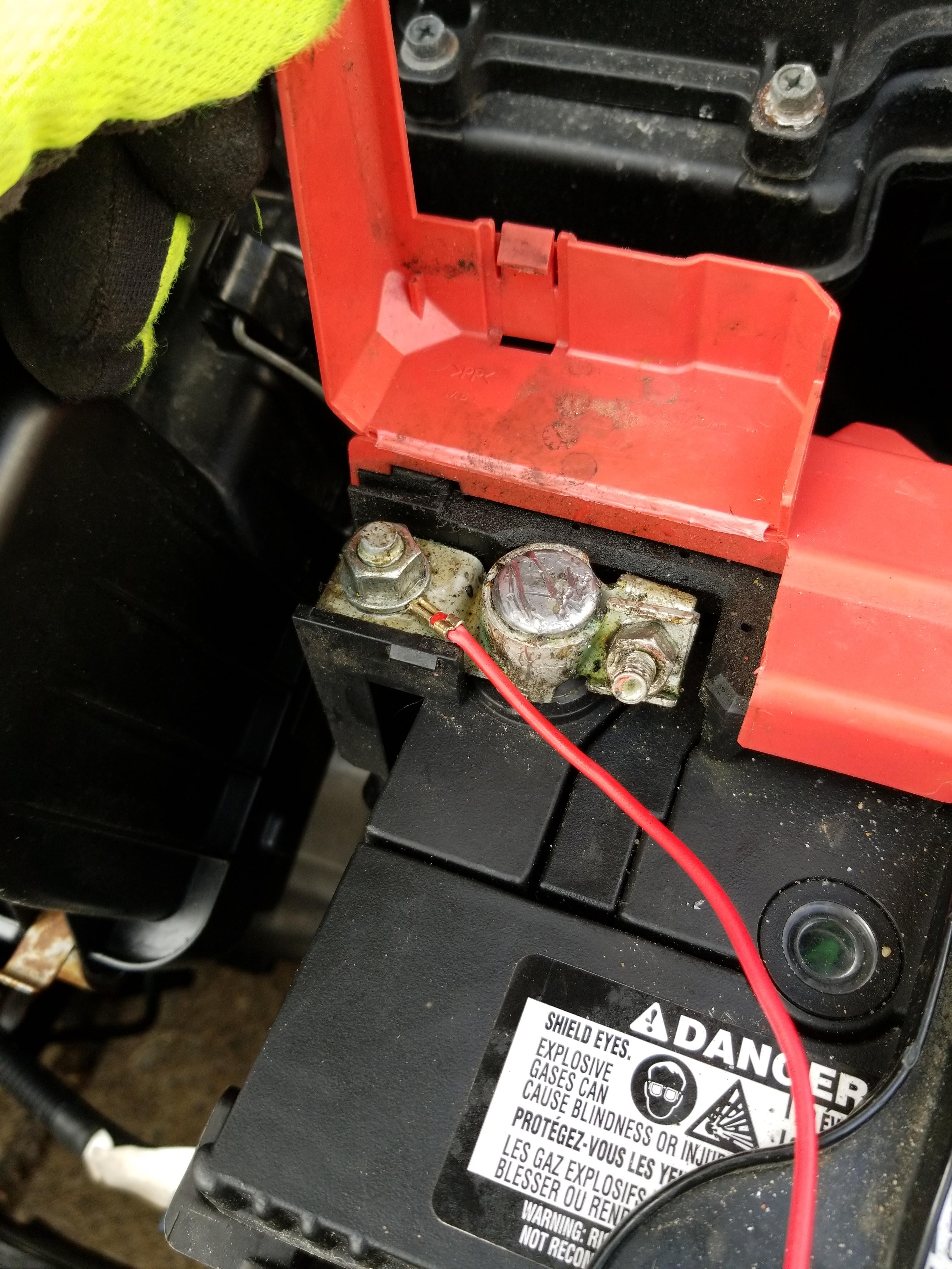

Open the hood and look at the firewall. You should see a rubber boot with a wiring harness that goes through it and into the cabin.
You can use a ring terminal and connect it on the bolt that tightens to the battery terminal. You should always be careful when dealing with wiring. Connectors will depend on your application. Search for add a fuse for the fuse box connection.

You can get one of these spiffy terminals that looks cool
Or just use a ring terminal. I am not sure about the ELD system but I think in order for it to sense the amp the amp needs to get power after the ELD.

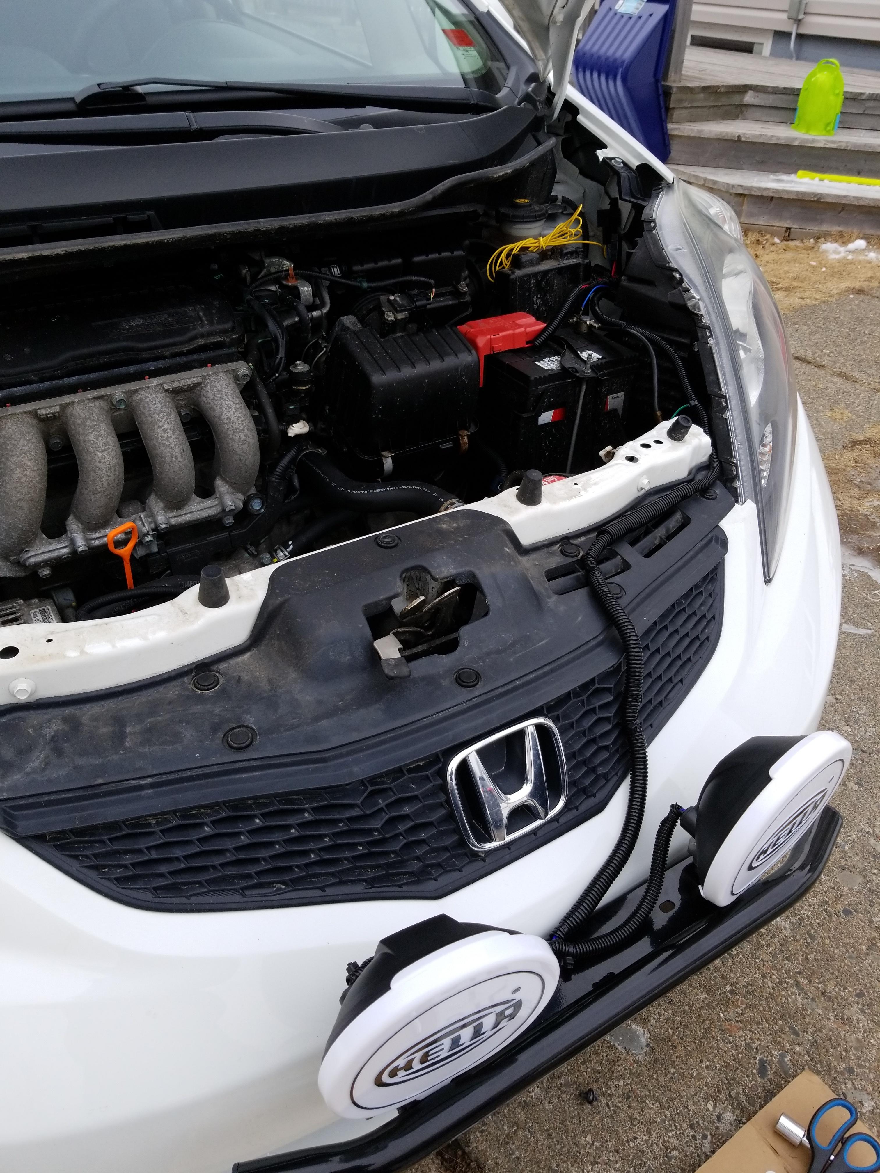

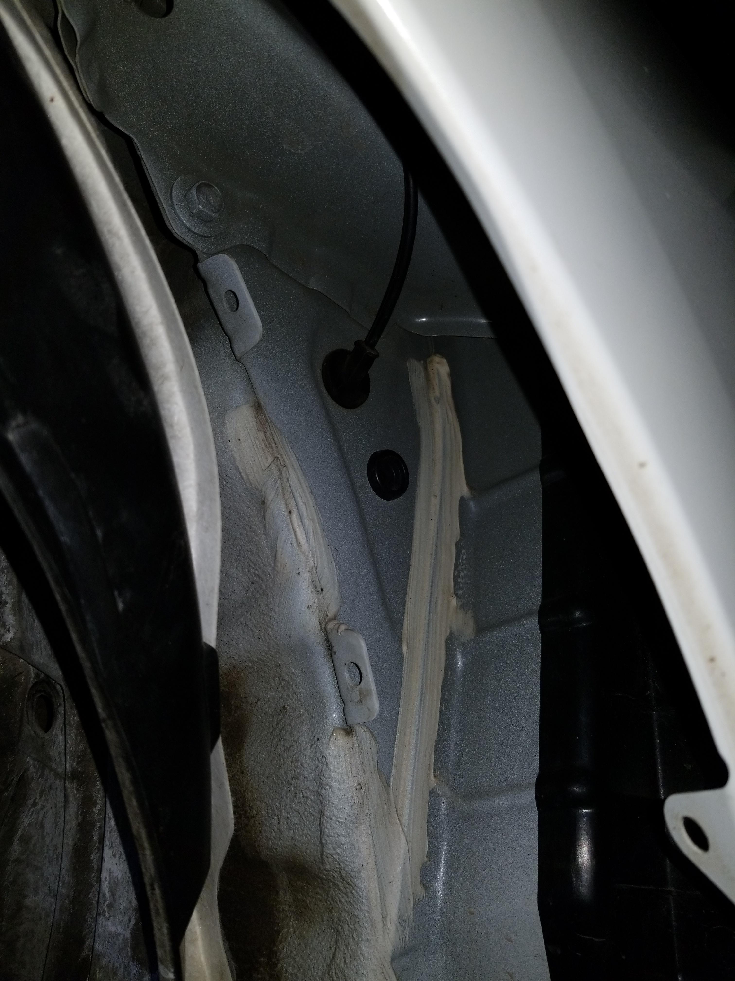

There's anther spot you can run a power wire through to the driver's side of the cabin that only requires a couple clips popped out, and that is under the driver's front fender liner. There's the hood release cable and a second small grommet just under that. Saves running a super long wire.
Also here's what a ring terminal looks like on the battery connection. This is a lower gauge wire for some aux lights, but same idea. This allows the cover to close flat.
