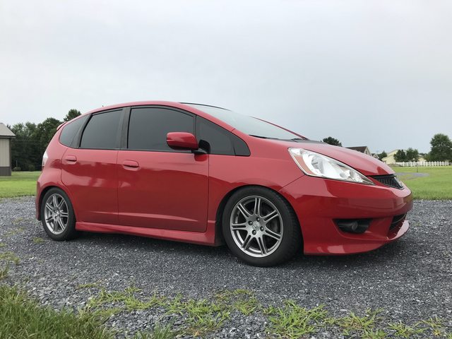

For that low you probably need some BC's or K-Sport to not rub if you are running higher offset wheels unless you roll the fenders.
If you want a softer ride Tein Flex but the springs are on the softer side so they rub if you go too low.
My Fit on Tein Flex. Had to roll the front fenders but any lower the liners were rubbing over large bumps/dips because the spring rate was on the softer side.
