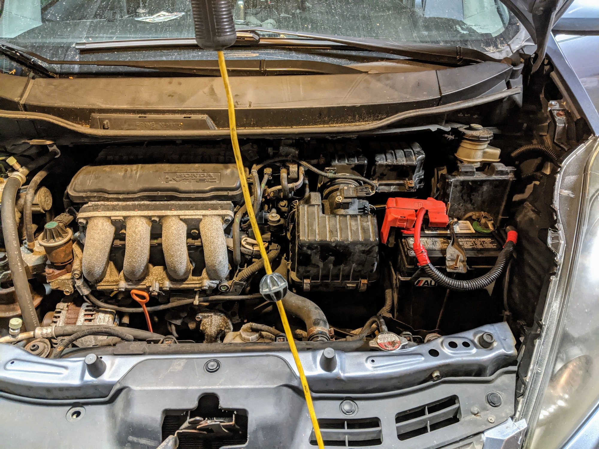

Here are two photos.
I ended up having to remove the Air Intake Box and the Battery.
There is a batch of wires going through the firewall and the grommet the wires are going through is pretty big. I took a flathead screwdriver and pushed it through the grommet and then used a razor and made a slit on the top and bottom of the hole.
I pushed my wire through the hole by taping a small but sturdy shim of wood so the cable wouldn't bend as it was going through the grommet.
The cable comes out above the gas pedal.
Then I just routed the cable to the trunk.
I hope this photo helps someone else in the future.

Here are a couple photos.
There is a bundle of wires going through a grommet.
In order to get access to this you need to remove the Air Intake System and the Battery.
It was fairly easy to do just time consuming.
I used a flathead screwdriver and forced a hole into the grommet. Then I took a razor and put a slit in the hole in the top and bottom to help the cable go through.
I pushed the cable through and it came out above the gas pedal. Then I routed the cable to the rear.
I hope this helps someone in the future.

I was able to run the 4g AMP Power through the firewall on the driver's side.
To do this I needed to remove the Air Intake and Battery to get at the bundle of wires going through the firewall.
I used a flathead screwdriver to poke a hole on the right side of the rubber grommet and then I used a razor and i made the hole a tad bigger by putting a slit at the top and bottom of the hole I made.
The wire passes through just above the gas pedal on the inside of the cab.
You can see here where I inserted the power wire.
Power Wire Install - IMGUR
Then this what it looked like when I put the air intake and battery back in place.
Power Wire Install Done - IMGUR
