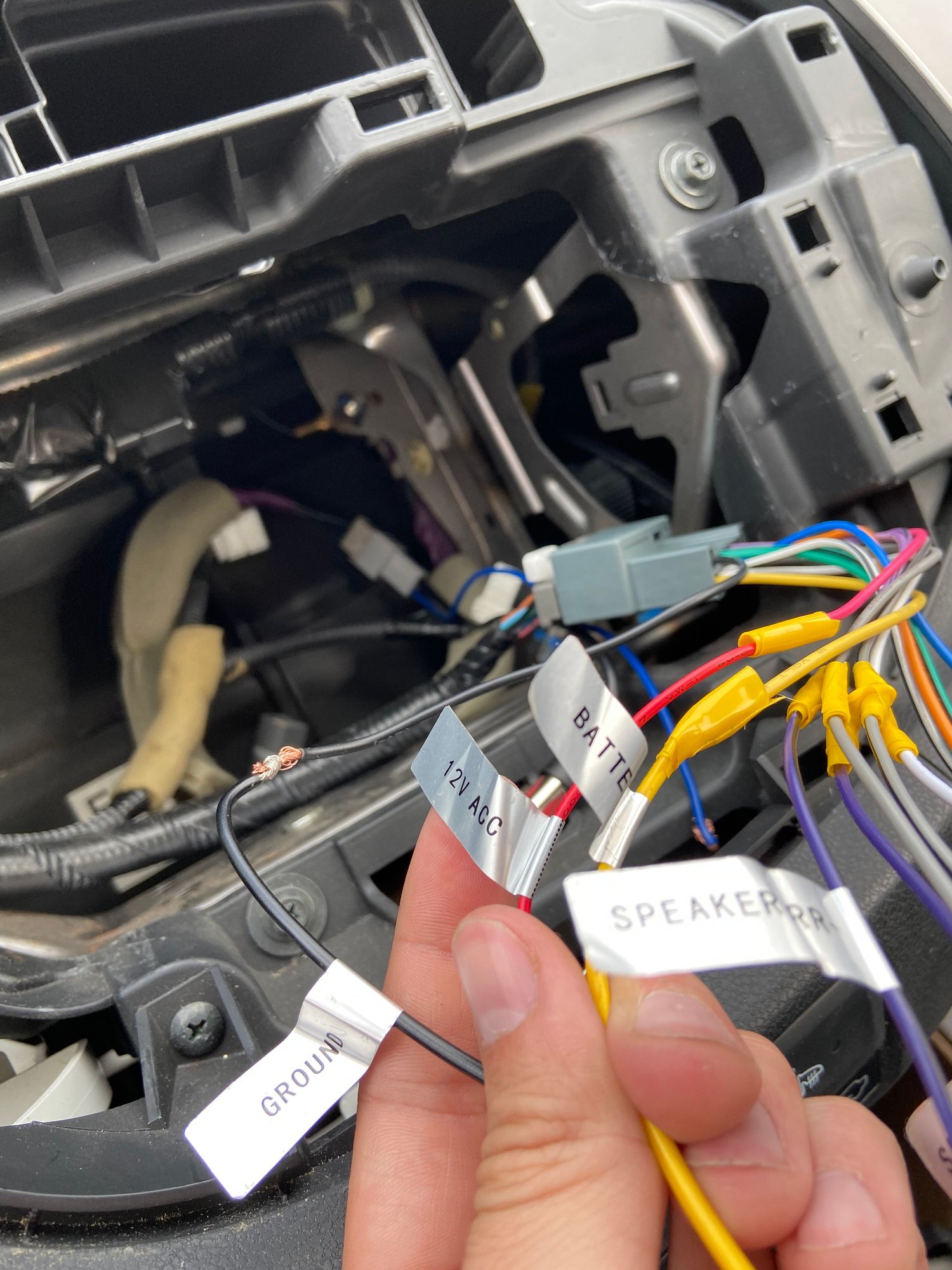

I installed a new aftermarket stereo this weekend (should be easy enough right?) and after I fitted everything into place, and attaching the stereo harness, the stereo wont turn on and now my power locks on my FOB don't work, and my doors will only Lock/Unlock after I am driving for a couple blocks.
- I took the stereo back to the dealer and they tested the stereo - it started up fine
- My new car battery I purchased 3 months ago was at 50% so I am currently charging it.
- I replaced the Key Lock/Radio fuse just to be safe
After a lot of swearing the radio still won't power on and my Power Locks only turn on when I am driving.
Does anyone have any experience in fixing this? Thanks

I bet you've grounded something that shouldn't have been. Did you try a DIY install or something akin to a Crutchfield kit?
I used a stereo harness from Visions.ca
As for the grounds: I grounded the two black grounds together, I had them crimped together and tried to just electrical tape them together too to try and get a signal.

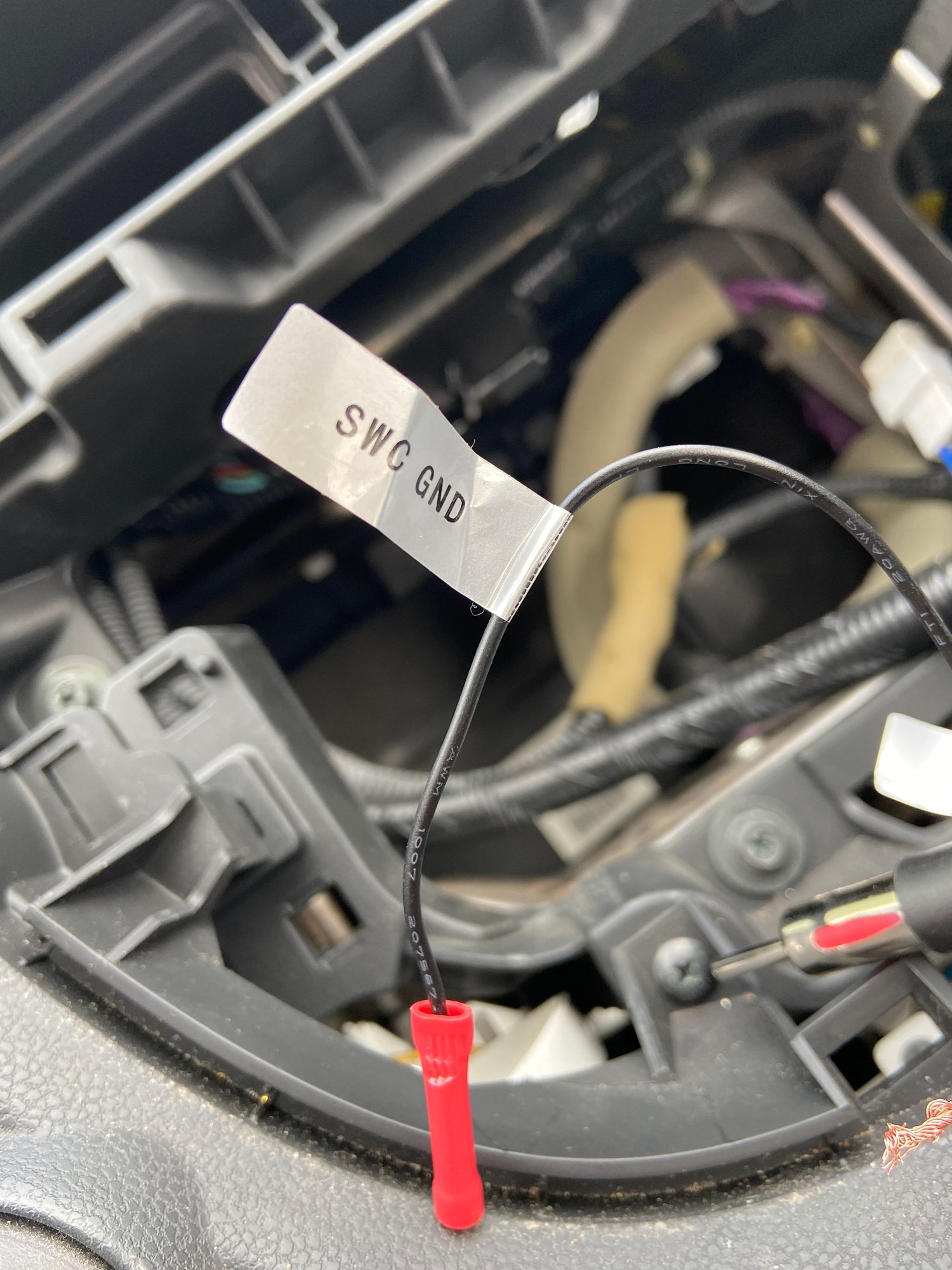

There is a SWC Ground that I left hanging because I don't have any steering wheel controls. (could this be the culprit?)
Thanks for the reply
I may have... The only ground cables that I have are paired together. I tried crimping them together and pairing them together with electrical tape.
There is also a SWC Ground but because I don't have steering wheel controls I left it alone in a case.
I bought the unit with a wiring harness from Visions.ca , it seemed pretty straightforward.... so I thought.
Thanks for the reply!

Fixed !!
The 1 fuse was burnt out. (back up fuse 10 amp)
The fuse tester I was using was broken, i bought a new one and found my mistake.
