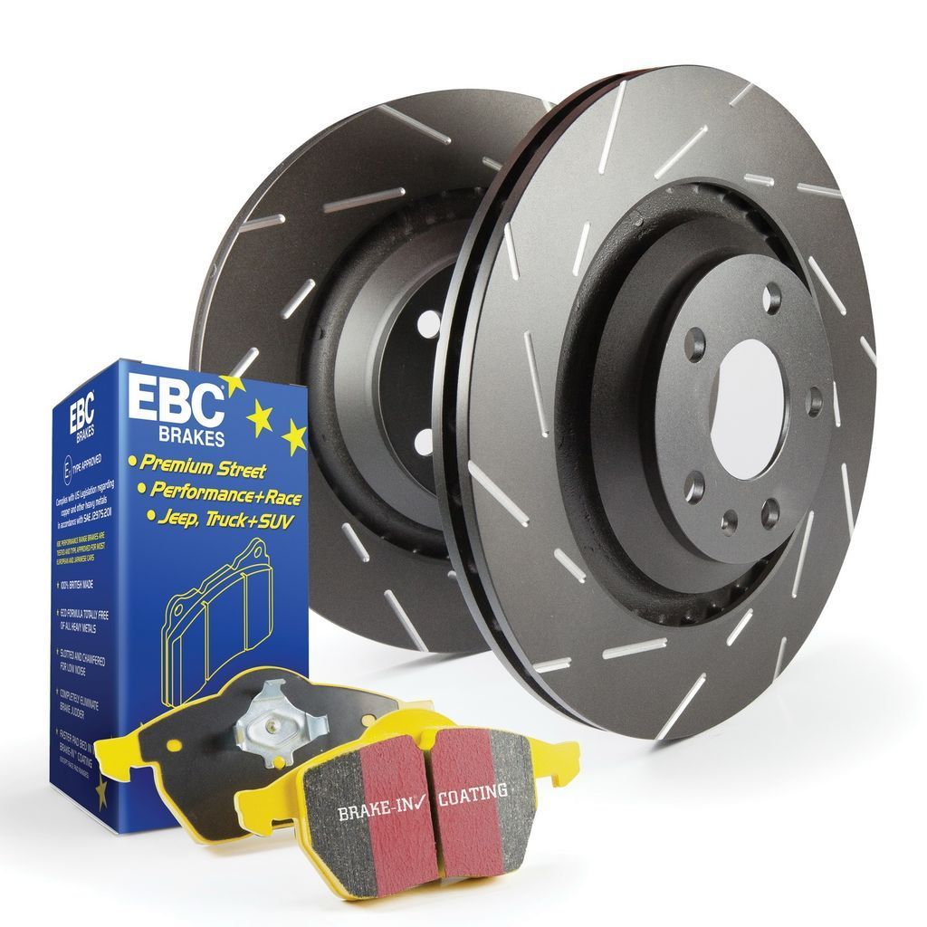

Ahhg!! They got'cha. I swear I've read that before (perhaps on instructions that came with brake pads, I don't know,) and as a result done the same thing!
I can guarantee that if the brake pads for your car have holes for those clips, they should be installed. Some cars don't use them and instead have a pinch clip (I've tried looking up the nomenclature and gotten nowhere, and it really hurts my credibility, I know) kinda setup that pushes into the caliper's pistons
See the circular metal whatchacallit on the back of the pad here?
Those types, and I'm sure there have been other designs, don't use the spreader..coat hanger... whatever clips.
But all properly designed brake pads should have some physical method of keeping the pads from rubbing against the rotor, otherwise they will stick to said rotor when you let off the brake and cook!
