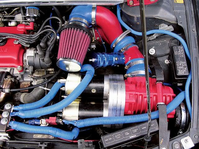

That would work. Any more info.

That's a Thomas Knight.He's been selling them for many years. They run about 3k. I think they are good for 15 sec. of fun. Pretty wild they use two or three starter motors.

I have to look into that. Its wild as long as the extra weight don't counter the extra power but its different.
Edit: Made 5 psi of boost go for 2.5 seconds off the stock time. He had traction problems though but it worked.

That looks like it weighs 60lbs lol

Yea, but it works. I found the magazine its in.

No doubt they work.. but they are pretty crude, have a huge electrical draw and require multiple 40+lb batteries and an alternator out of an escalade.
For the cost you could go full time FI and not worry about having enough juice to taze an elephant.
They also can't keep boost up to redline.
Boost is a measure of restriction, which in this case is telling you these are pretty low flow capacity compressors.
Not trying to be a debbie-downer, but there are so many more cons than pros. Which again is why you'll never see one of these OE and even most ricers can agree to throw down that much cash for what is basically a nitrous alternative is silly.
Not only that but most ECUs use the deadly fuel cut version of rev-limiting so you will be melting shit in no time. Valves, pistons, bank accounts..
Edit: You are also putting any and all emergency responders at risk of electrocution by installing one of these in the event you crash. Same thing goes for Leaf and Prius owners. Don't believe me? ask an EMT/Firefighter...

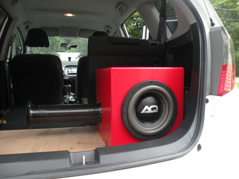

Made a new sub box over the last few days

^^ wow, that's a long tube. cool.

Thomas Knights design works but the future is in Centrifugal Blowers. The thomas knight design uses inefficient motors, an inefficient blower, and alot of power. The blower has a very high rotational mass but it only has to spin at around 10,000/20,000 rpms. At the time he was designing it, it made sense. But now that we have brushless motors that are becoming more affordable and can spin up to 100,000 rpms, powering a centrifugal blower makes a lot more sense and requires a lot less power. Namely, it requires no additional batteries. Just one valved AGM style battery. So the additional weight is only the weight of the supercharger and motor. ~30lbs.
Restriction really isn't a concern when it runs at WOT. The only time I care about restriction is at WOT, and it always runs at WOT. However, if it was a concern it wouldn't be hard at all to design a bypass.

Add a few 2 farad capacitors to take up the sudden burst of power. They weigh very little. My 1/2 farad weighs about 1lb. They'll also help with starting the car in winter. - added bonus.

HELLO? Can you hear me now? Man I hope you like hearing and you don't have any teeth fillings. That thing can dissolve kidney stones from the looks of it. HELLO?
