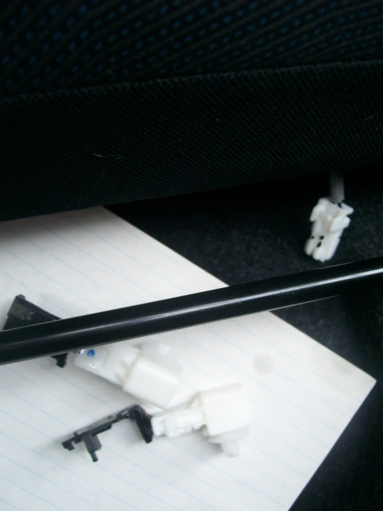

I figured it out. The seat belt clasp assemblies for both the driver and passenger side each have a small sending unit and loom-protected wire that leads to a connector under each seat, where a yellow/black wire connects to it. The magnetic "switch" within the buckle assembly is not a simple "normally open" or "normally closed" switch; it is in fact throwing a a code to the car's computer. There is a piece of metal in the clasp that turns the sensor "on" when the seat belt is not engaged, and the metal piece pops up and out of the way when the seat belt is bucked. When the sensor is removed entirely from the buckle assembly (but still wired to the car) it will tell the car that the seat belt is buckled. The air bags will still be operational, and the seat belt will work as it should.

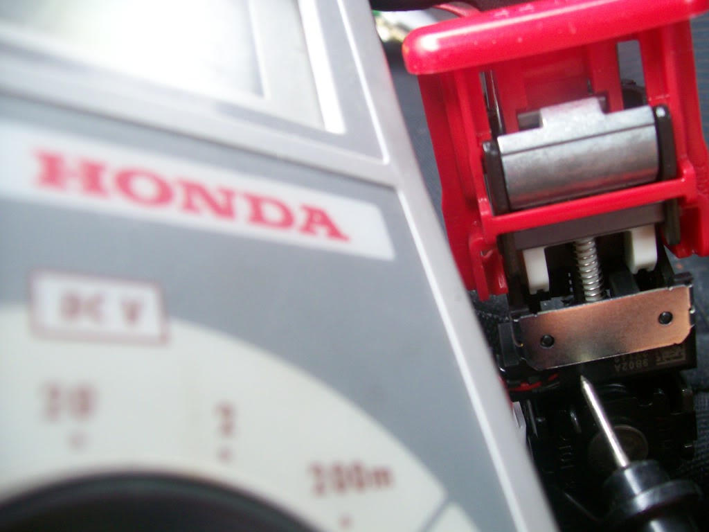

1) Remove the casing to the buckle, being careful not to gouge it.
2) Here I am pointing to the sensor with the meter lead. There is a small metal cover holding it in place. The seat belt is currently unbuckled.

3) Here is what the sensor looks like when the seat belt is buckled. Notice how it is now "free", with nothing in contact with it:

5) Here is the cockpit with no sensors or sensor wires. You could leave the sensor dangling under the seat, but it could get damages by the moving seat so.... (On to step 6)
6) ALL STEPS FROM HERE FORWARD ARE OPTIONAL. I made it tidy and durable by attaching the sensor directly to the connector with solder and epoxy:
7) Remember to use the sensor from the same side of the car that you removed from the buckle assembly, and keep the polarity correct when you attach it to the plug. Reinstall the newly made sensor/socket assembly under the seat and plug it back in to the sensor receiver plug (yellow/black on the driver's side, green and black on the passenger side.
