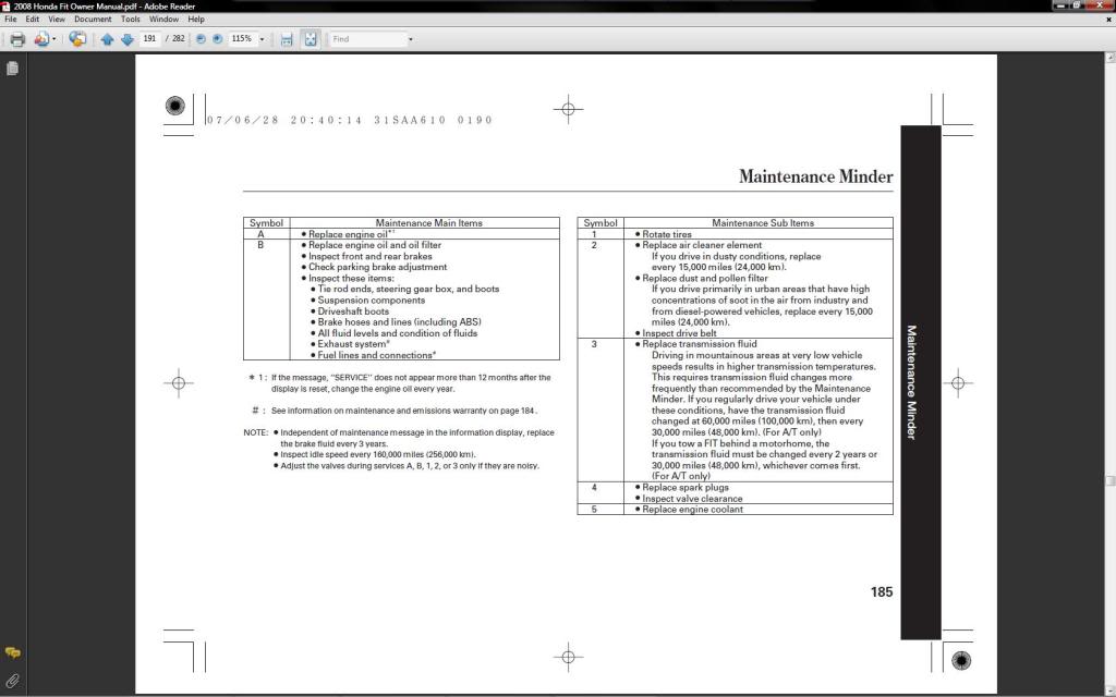

^^ Ditto. You just haven't driven far enough past 20% for the codes to pop up. Once the car hits 15%, the MM percentage will pop up as well as a code with the letter "A" or "B" as well as a number or combination of the numbers 1 through 5.
If you are not sure of what the codes would mean please refer to the image below. Disregard the fact that this is from the 2008 Fit manual, the maintanence minder codes show exactly the same on the majority of Hondas except for AWD & 4WD models (which have a 6th number for their transfer cases and rear differential fluid).
If you cannot read the image either save it on your hard drive, click it and zoom in or right click the image, open in new tab, then his "Ctrl" and scroll up on your mouse to zoom in.
